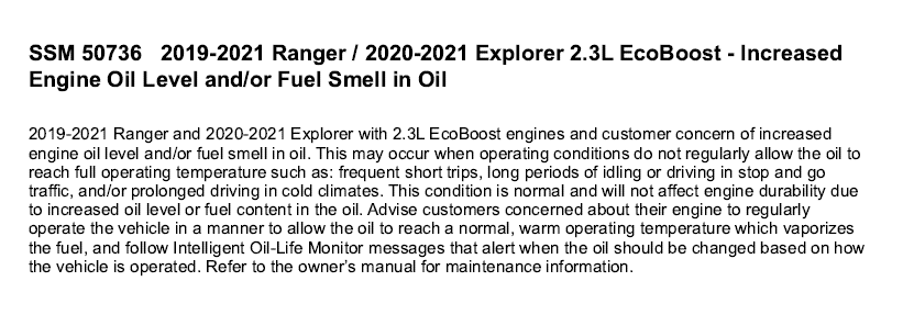

They have addressed the Fuel/ Oil Issue, but it was a SSM (Special Service Message) which is basically a FYI document and not a TSB. This is the most current, no updates to include the 22-23.
