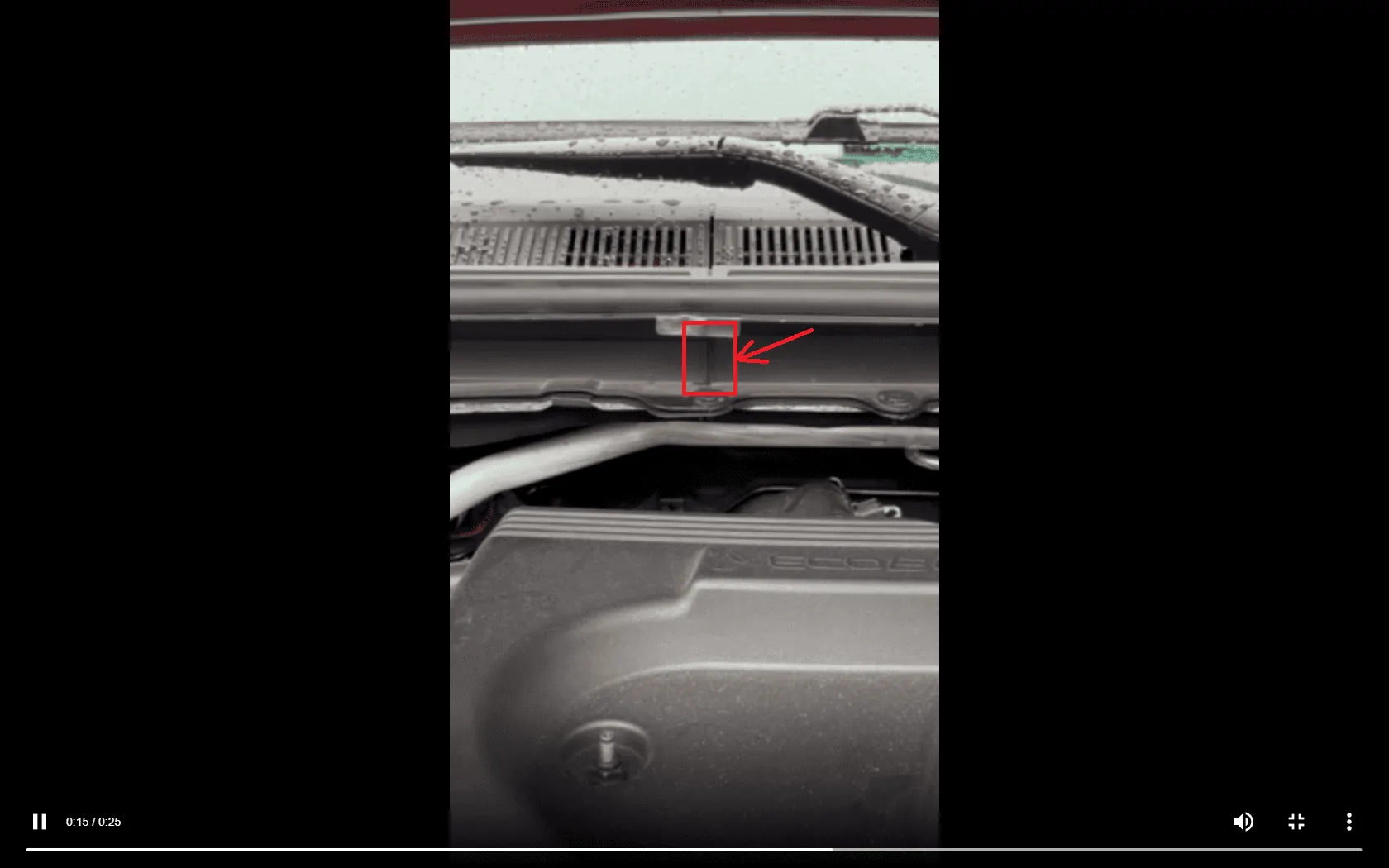

I sealed mine into submission yesterday. Removed the foam gasket tape and used Butyl tape between the cowl and the cowl grill. Used stainless harware instead of the push rivits to get a good squeeze on the butyl tape. Also used weather strip adhesive to glue the hood gasket to the plastic cowl grill like they did in the good ol' days. After all this, the water now decided to seep between the split in the plastic cowl grill if you poured water right on the split....so now the split is sealed with.....flex seal tape....the red box was the last place I had water seeping thru....so I flex seal taped up that seam. Not the most ellegant, but it rained last night with ZERO leakage.
My cowl grill had been leaking in several spots as the firewall pad was wet and actually growing mold in one spot.

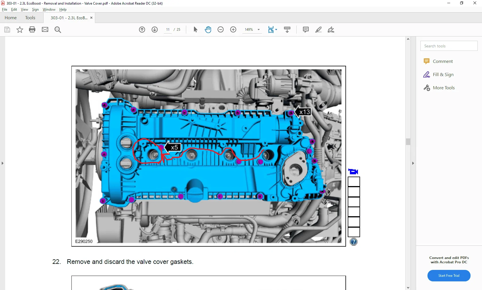

My truck is parked nose down in my driveway so the water collects in the valley of the valve cover, runs past all the vanes sticking up to the front where it has nowhere to escape and then pools up where I have circled and invades the front plug via the poor seal between the coil and valve cover.
i'm truly not trying to be an ass, but as a simple (but not permanent) solution can you just park facing uphill instead? the back of that engine by the #4 cylinder looks like it has a gap that fluid could easily drain down the back of the engine.
not a permanent fix, but looks like it could help until a better fix is found. just a thought.

Is any water on yours getting to the drain holes i have circled red above ?
Interesting... maybe a little dremel work to allow the water to escape.... although I cringe at the idea.
Actually, never mind, the humps on the valve cover still would retain water... seems like a yearly pull and re-grease of the rubber coil/plug contact point is a good preventative.
Do you have pics of what hopes to be a final fix?

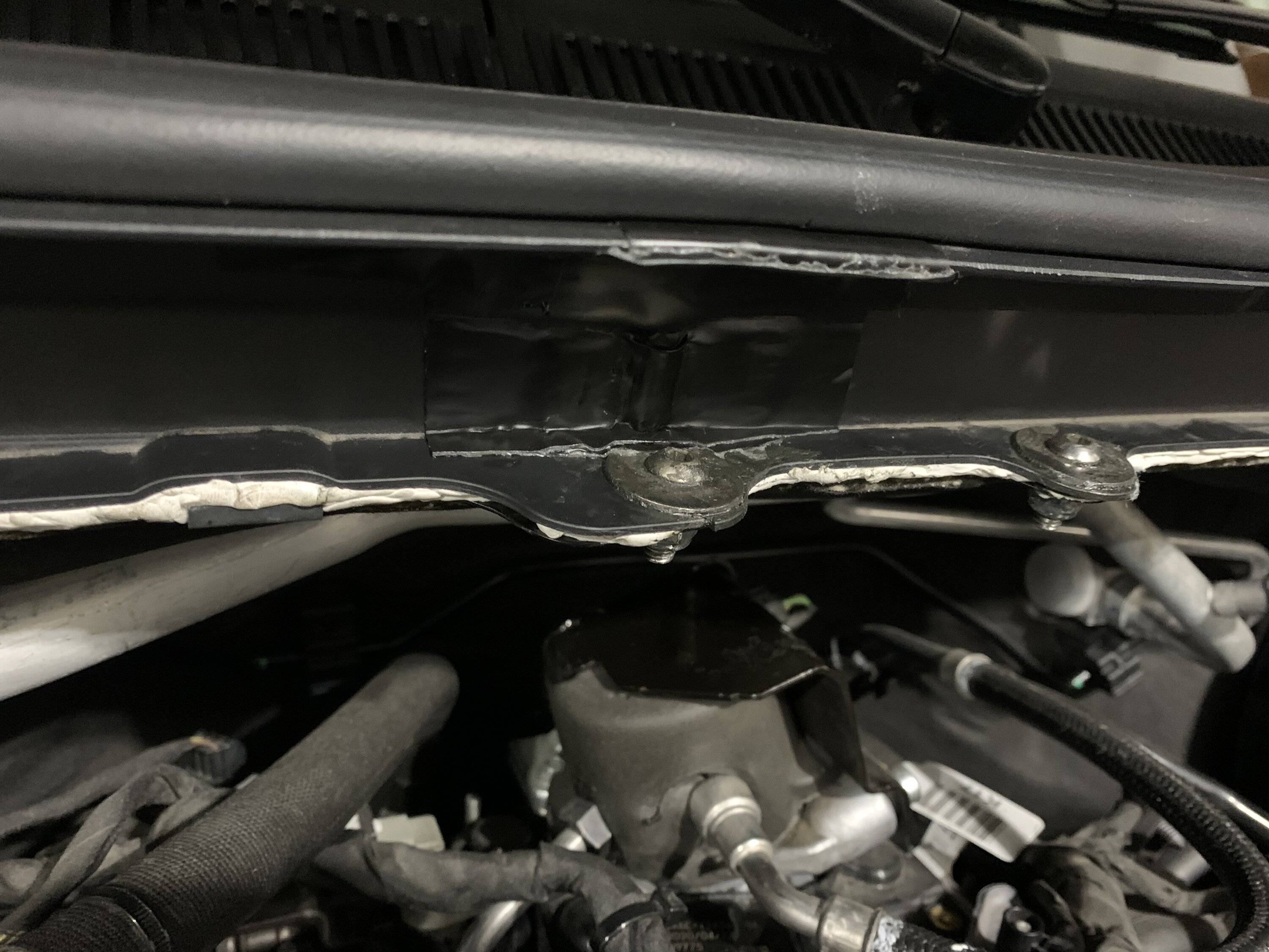

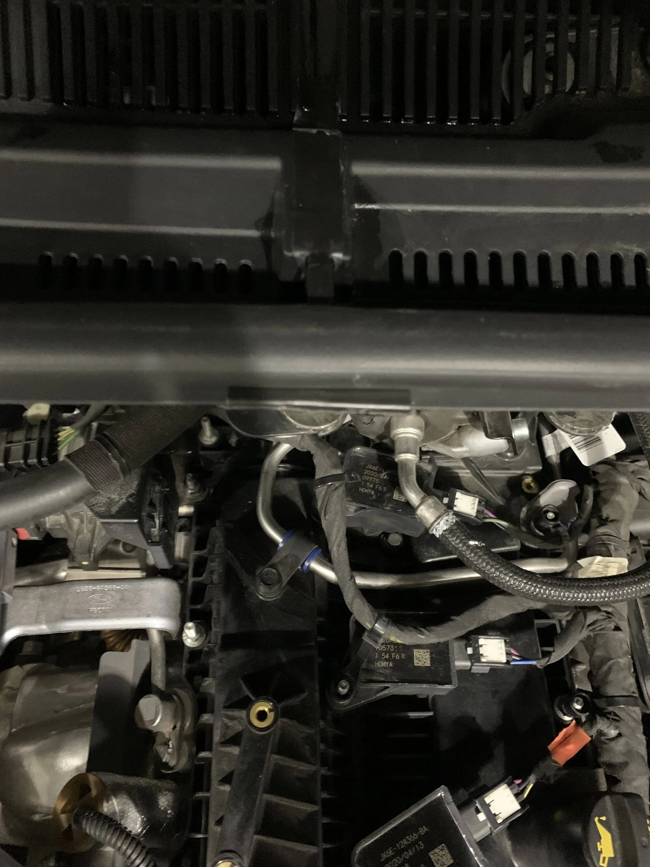

White is the butyl tape..:I didn’t have any black. Used stainless 1/4-20 bolts with fender washers in place of plastic rivits. Sealant under the fender washers. Ran flex seal tape from top side, underneath hood gasket down across the split to over the center hardware. Used weather strip adhesive to adhere the hood gasket to the cowl plastic. Used permatex form-gasket-2 between the 2 plastic cowl covers. Sat out in the rain last night nose facing down…ZERO water into the engine bay now.
I appreciate the detail on how you stopped the water. I have some flex tape, but might go ahead and do the rest of this for reassurance.
