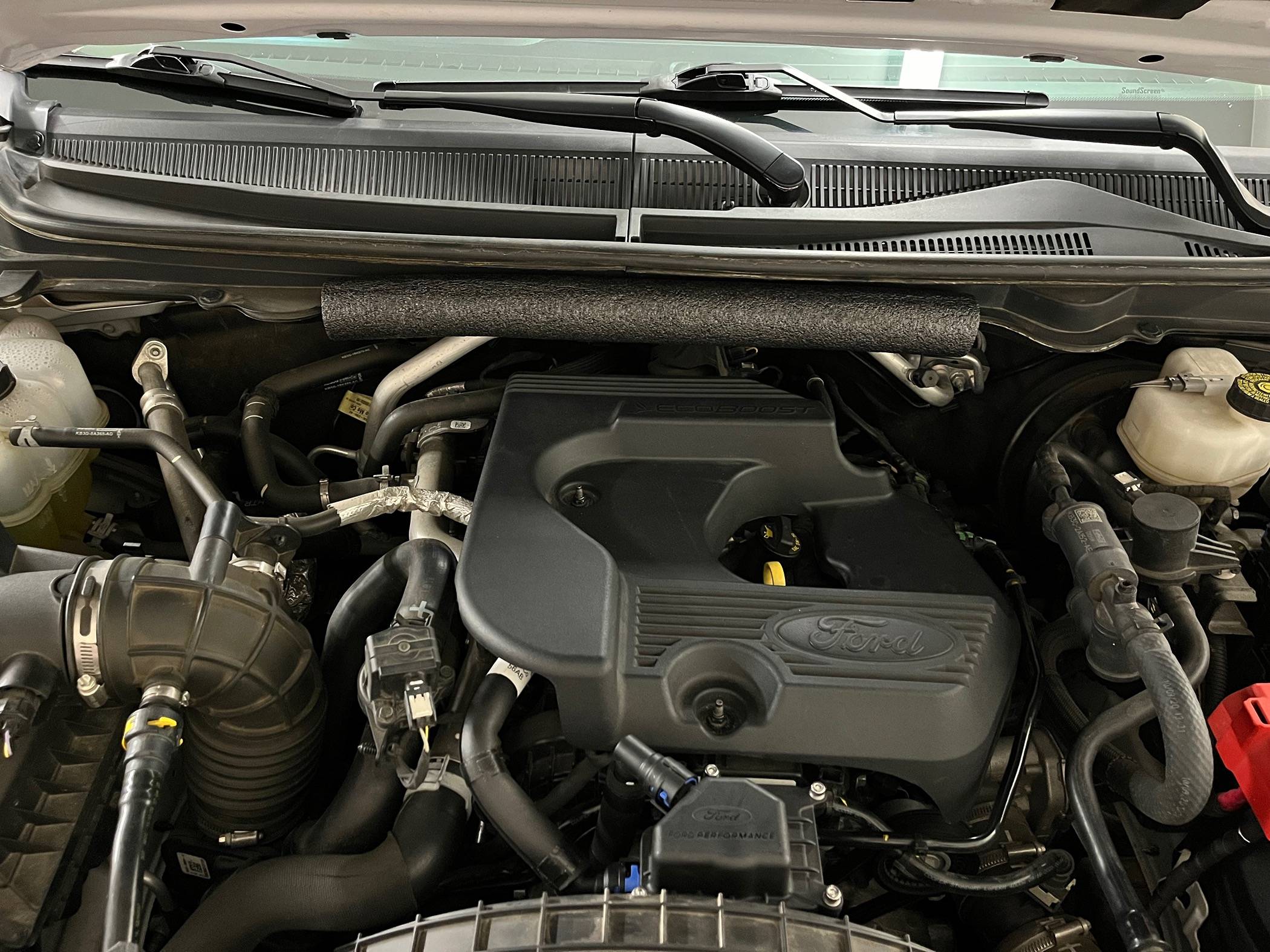

I added a piece of pipe insulation as well.
Ah well - this and the electric fan controller 'hose' replacement look like stuff I need to do.
I saw in other threads how some owners got fed up with issues around these areas and dumped their 5G.
I have a lot invested in fun stuff and the ESP for the expensive parts of my Ranger (dropped it off at the dealer for the climate control diverter issue yesterday) and now I'm focused on staying ahead of failure. Looking at you, 10R80. ?

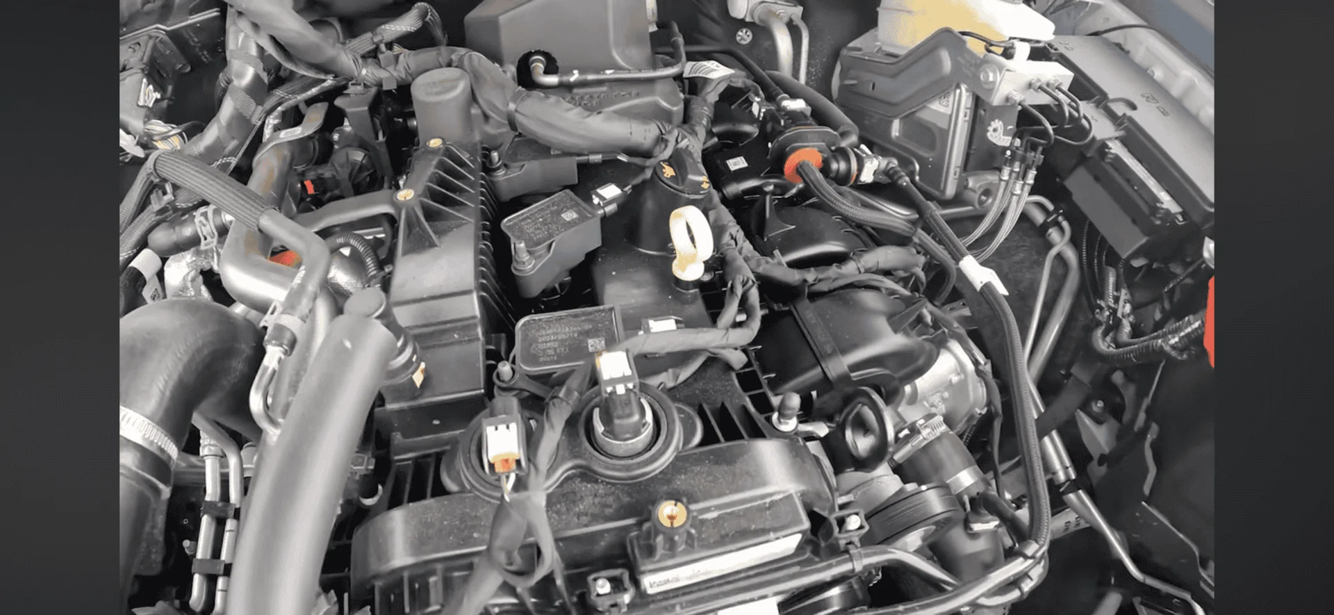

Does it look like the new Gen6 have a cover for the 1st cylinder well to correct water infiltration?
