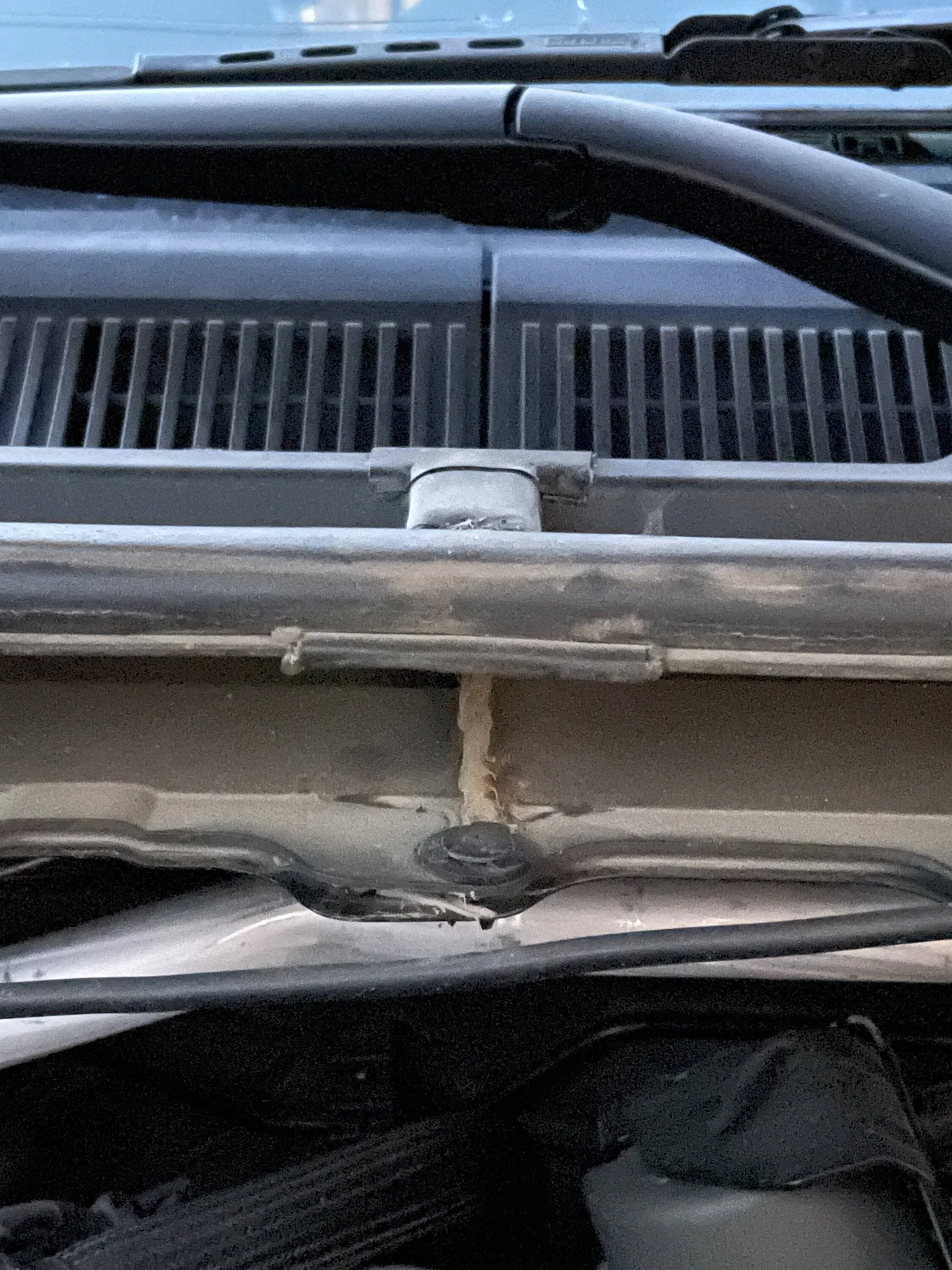

I would think if the engine is misfiring, the cause of the misfire should be covered under powertrain warranty unless an animal chewed a wire or something of that nature. The cause comes from a rain/car wash water leak that ford knows about. Shorty after buying my Ranger I discovered this issue and used silicone and flex tape to stop the water from leaking onto the top of the engine. I haven’t had this issue at all since but a quick test pouring water down the front windshield will show you quickly if you have the leak . I hate dealing with my local dealer . Last time I dealt with them they gave me a very hard time . I had to escalate my situation to the owner of the dealership before they took me seriously. Probably less headache to just fix yourself .

I used clear silicone and sealed the center connection of the scuttle panel . That black plastic trim piece around the wipers. Where the two pieces connect in the center is where the leak happens. If you pop the hood and run water down the center of the windshield you will see immediately where the leak is (it leaks on top of the rear of the engine). I started at the bottom of that plastic piece close to the hood and siliconed the connection down toward the firewall as far as I could . I let the silicone dry and then covered a few sections with black flex tape. I siliconed under the hood seal as well. After I finished, no more leaking . It’s been like this for two years and still holding up today .
