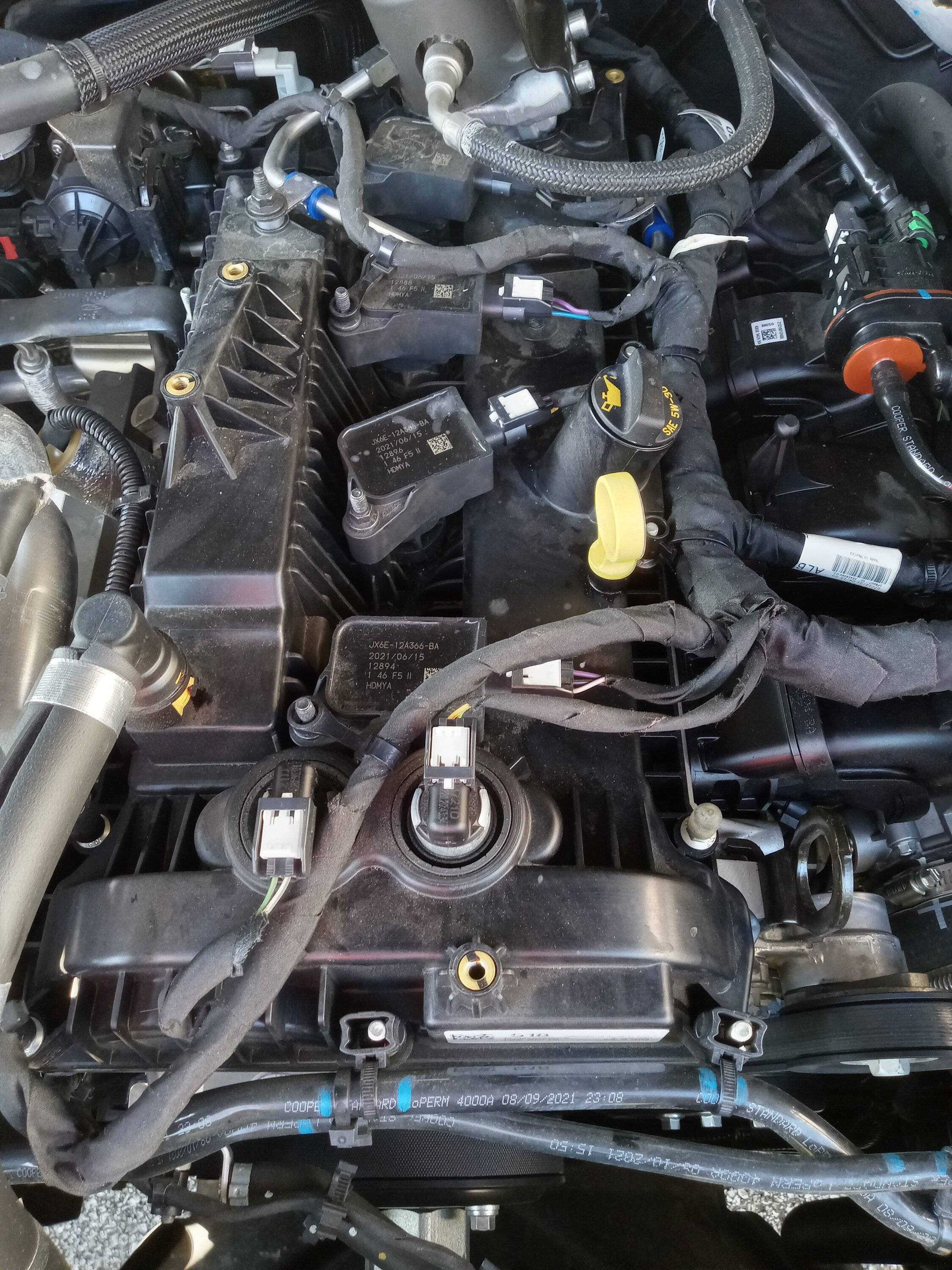

But thanks to your issue , I went and did a water check on mine , sure enough, water dripping on the plugs (I suspect they All leak there ) anyway , working on sealing mine since the covers can't be found...

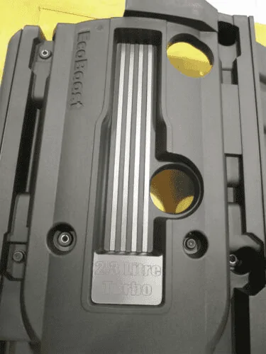

Too bad the mustang cover doesn't fit. It looks much better than what they put on our trucks.

How much different could it be ? I thought it was the same engine?
This one does have stripes added but this the mustang cover
doesn't look like the same engine ?
I just went and looked at mine , there are some covered studs (little caps on them ) and a few unused threaded holes , I think it would mount , BUT , the Mustang must have different oil fill and dipstick location, the big round holes don't jive up ... IMO the cover just relocates the drip , I'm interested in stopping the leak , which appears to be where the cowl vents come together , I may black light it if mine comes back...
That's what I was thinking. A few minor differences so it wouldn't fit without major surgery
