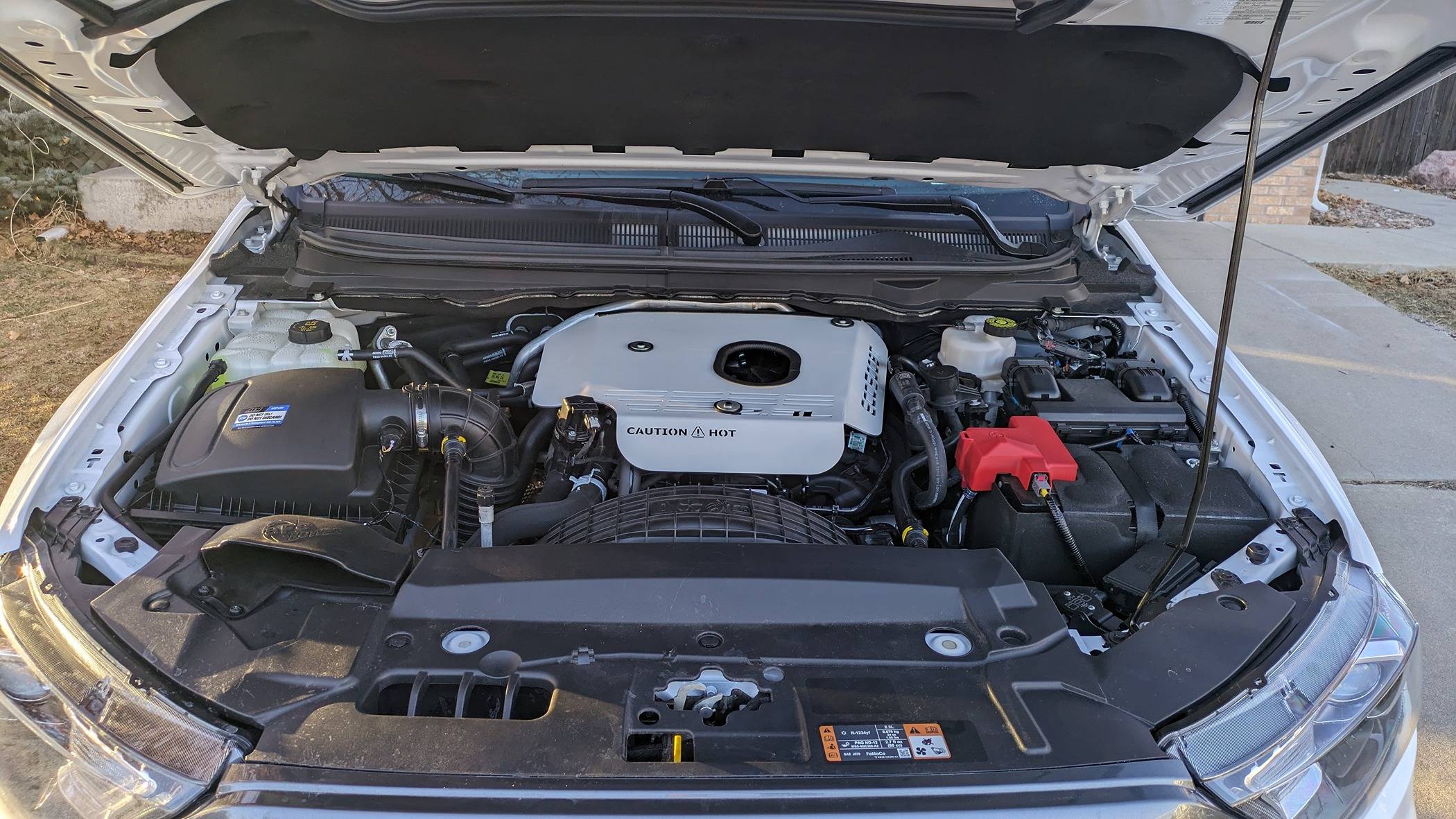

The engine cover doesn't cover the #4 plug well closest to the firewall. The cowling above that plug/coil pack has a clip right above the plug and water that is running off that cowling runs right through the clip and down into the number 4 plug well (with the stock engine cover on), this water can come from something as simple as the car wash.
Beyond that problem, which the cover doesn't address, I have a hard time understanding how any of the other plug wells get water in them, cover or no cover. Unless you have a snorkel that is actually doing something when you commute across that river. :)

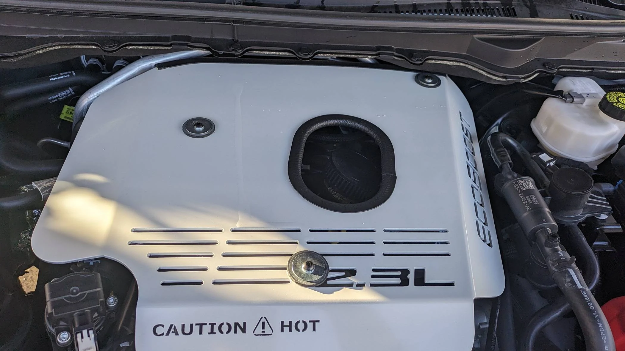

The JCR cover does a better job.
Particularly with some edge trim

i was unaware of this brand. this product is cheaper than the Ford cover, and they've got a number of other nifty products for the Ranger. Nice! Just wanted to say thanks for the share!

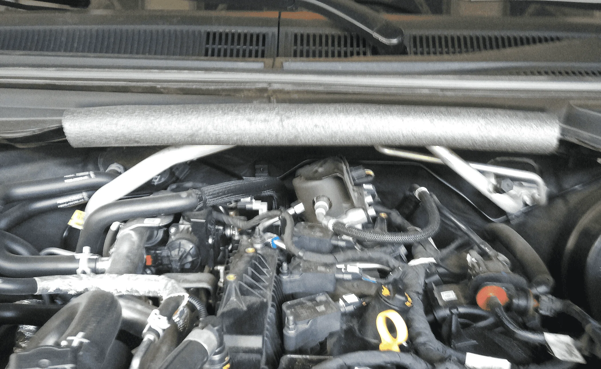

Split pipe insulation is the cheapest way, probably already have some layaround somewhere ?...
I also sealed my cowl with bolts and tossed those plastic push rivets ...

Would the water from a car wash dissipate from the heat of the engine before pooling around the spark plugs? I would think it would turn to steam and "burn off". Just a thought. I can definitely see how rain water would pool because the engine is cold. I found a piece of pipe insulation like the picture above and added that to my truck. I do have the Ford engine cover. I also have a Crew Car Wash membership and frequently use their car wash as I have a half-mile dirt/gravel road that leads to my house.

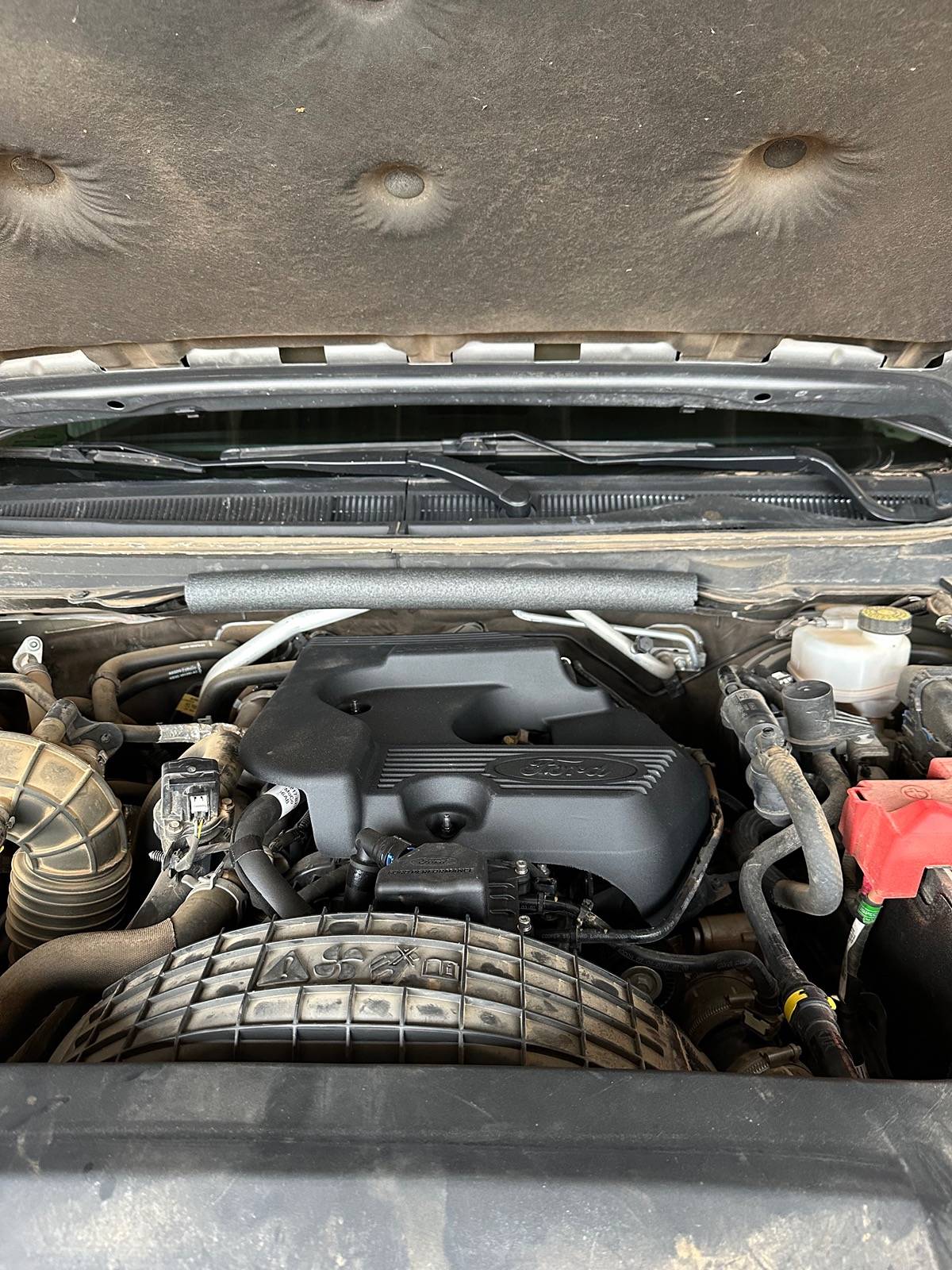

I added a piece of pipe insulation as well. Put 300 miles on my Ranger driving to Fargo, ND and back. It stayed right where I placed it. No adhesive. Found the extra piece in my storage cabinet in the garage!
