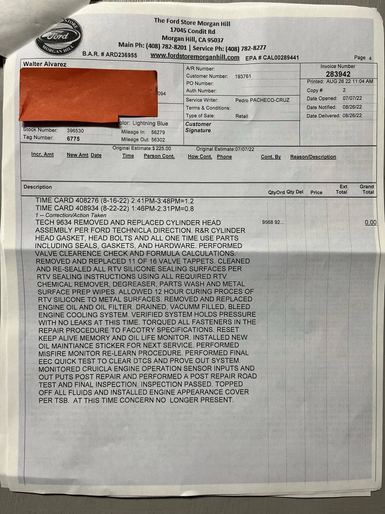

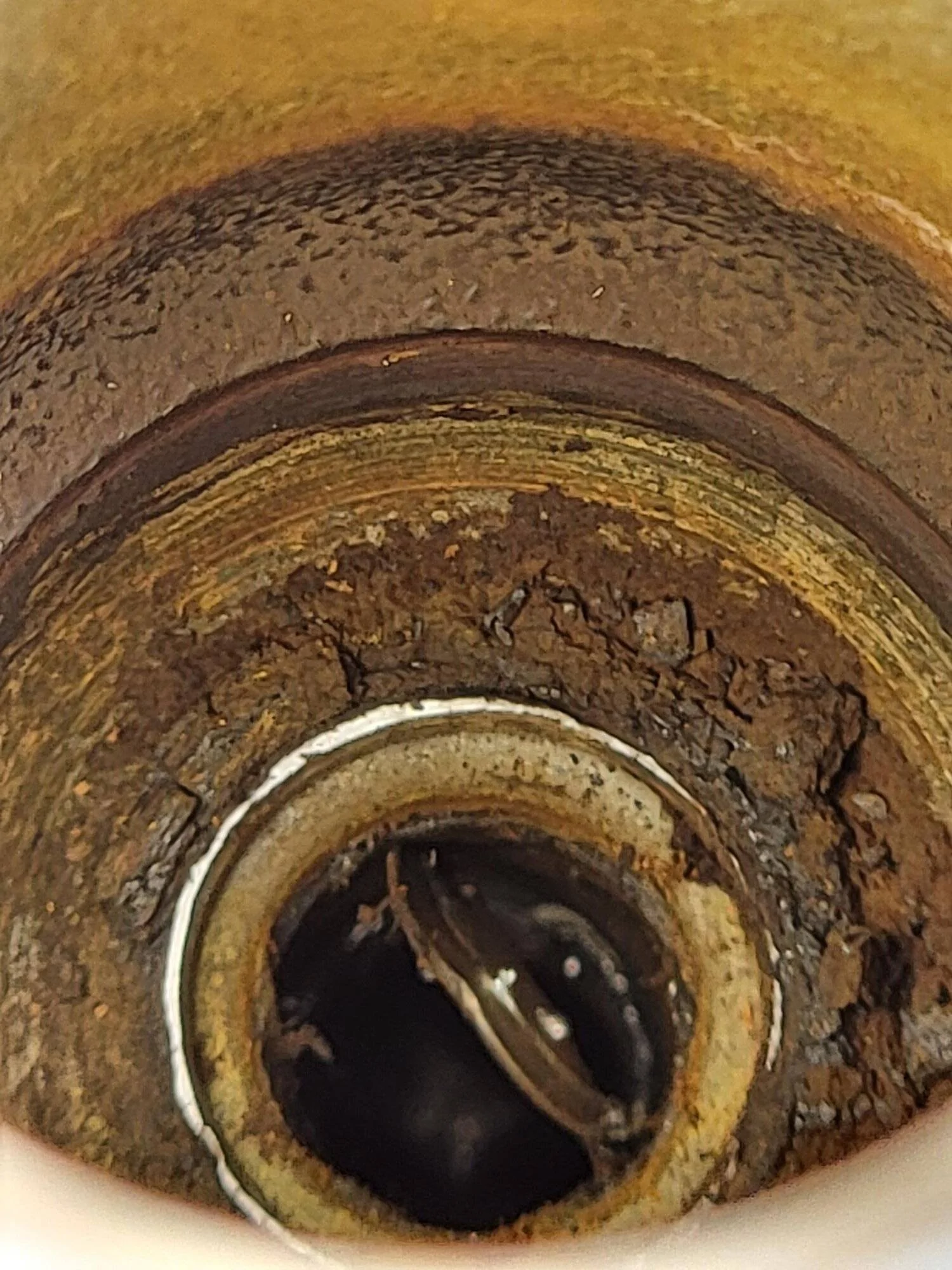

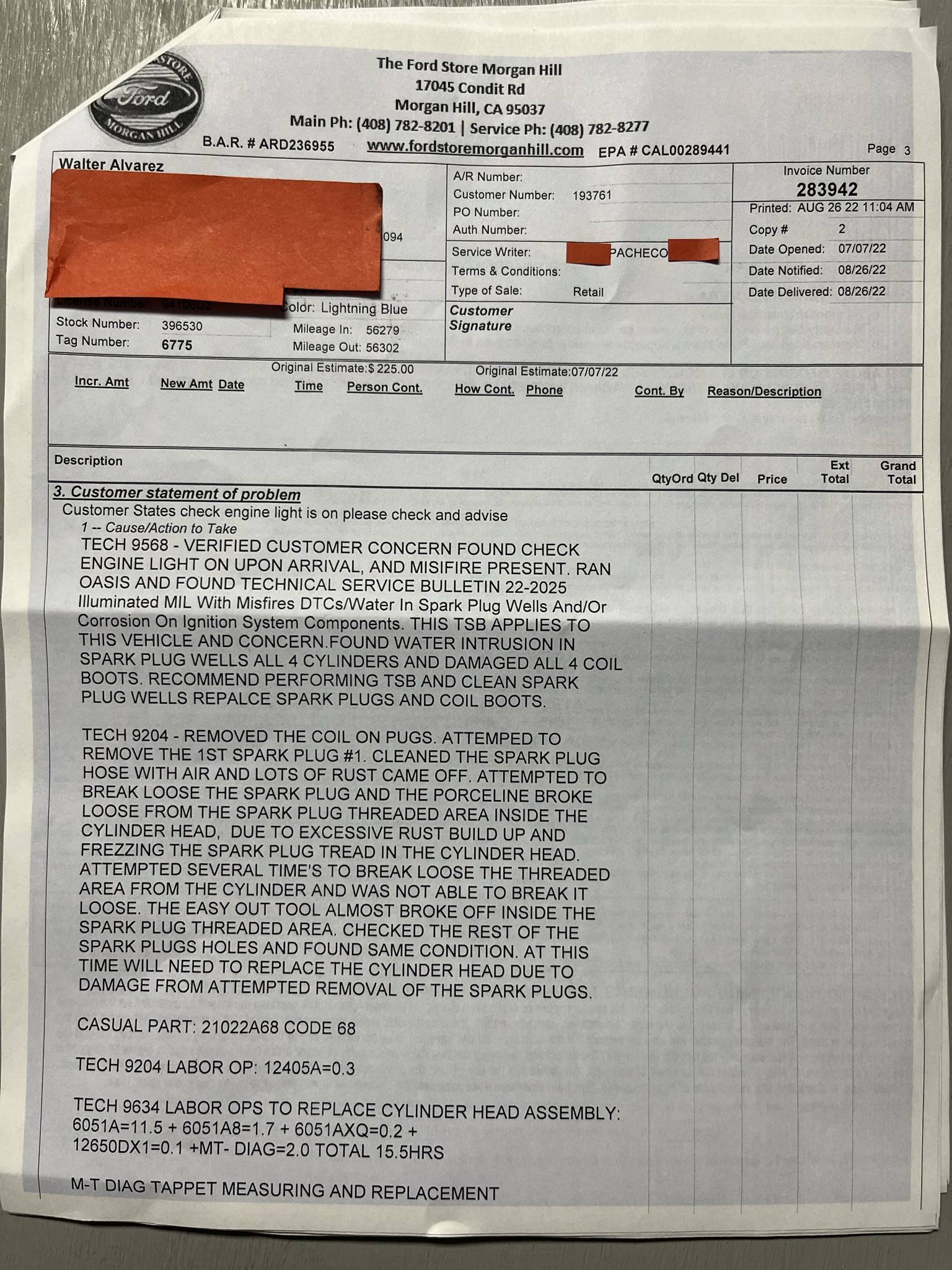

My Ranger started to misfire, so I brought it into the service department of the dealership where I had purchased it. I was told that the spark plug well was corroded, so severely, that they damaged the cylinder head when they removed the plug. The bill was ~$5K, and I needed to purchase an engine cover? No one told me of an engine cover. Apparently, there was a technical service bulletin 21-2147 that, basically, voided my power train and extended warranties for any damage done due to the cover not being installed. Ford offered to cover 60% of the cost, but I declined. I was furious! I felt they should cover the entire cost because I was never informed of a TSB 21-2147. In fact, my service advisor was unaware of the TSB until I brought my Ranger in for the repair. I went back and forth with my dealership and Ford Motor for two and a half weeks, which was all I could take, and so I gave in.
I waited a month for parts, but they kept having problems with supply chain and technician availability. I called a lawyer to see if a buy back was an option. At the same time, that afternoon (last Wednesday), I made a raving mad, inappropriate, post to this forum. I didn't realize everyone thought I was a troll or "sock puppet" (learned that one here) trying to stir up fear. It was explained to me, in a very sincere way, and now I completely understand. Eventually, someone challenged me (lightly) to post the name of my service advisor and his extension. That was Thursday afternoon. Welp...what can I say but thank you all so very much! I get a call Friday morning from my service advisor telling me that my Ranger is ready to go and they are honoring the warranty 100% They even threw in the engine cover, oil change and deductible! $0.00 you'll see on the service receipt. How? My service advisor asked me about some phone calls, and then I realized, it had to be the folks from this forum.

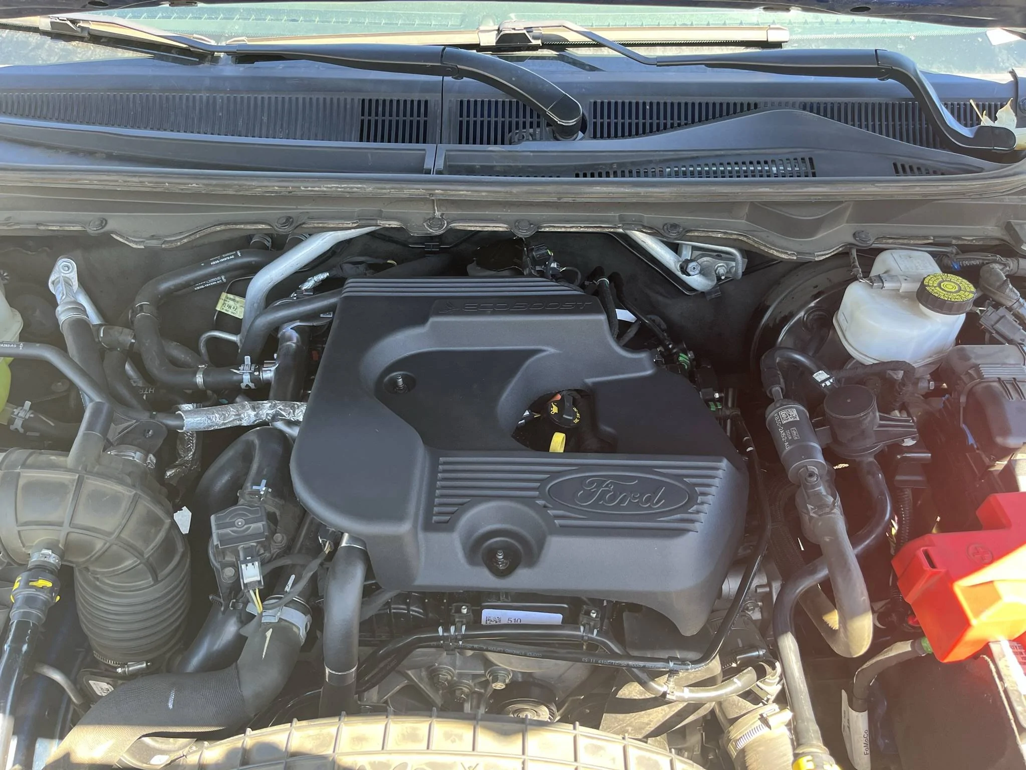

Added a Ford OEM Engine cover in Oct. 2022 after owing the Ranger for a little over 2 yrs. and no rust in the plug wells. Has anyone experienced any moisture sitting in your plug wells after a Ford OEM Engine cover came originally with your truck or after one was installed later?
That looks like a mismatch for the age of the rest of the plastics under your hood (especially since you have no moisture issues after 2 years). I would suggest either removing it and selling to a 2022 owner, or painting it Ford blue. ;)
Will be glad to PM my address if you choose the former.
