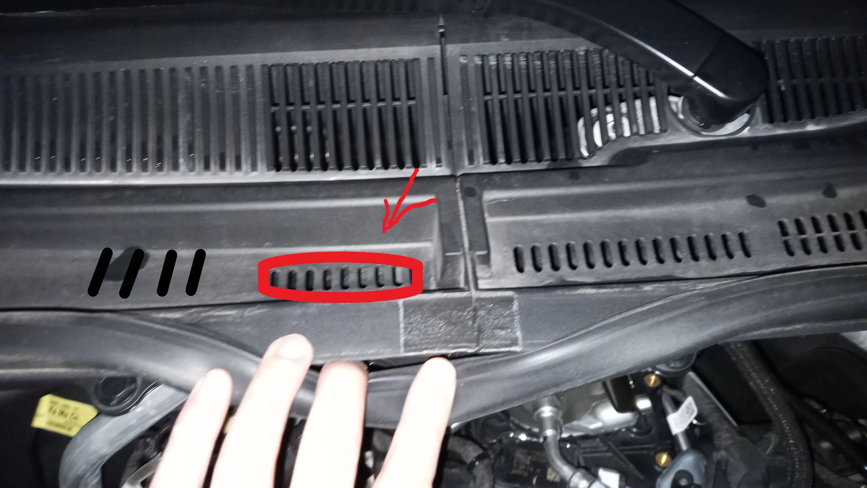

On mine , ANY water that goes down the slots maked in red , INSTANTLY drains out the push rivet , i blocked those holes and moved them back away so they drain before they get there , the center where the trims join is the HIGHEST POINT of the metal underneath , water 3 inches either way drains back and down and away from the high point... cost me 80 bucks caused i slipped with me Dremal and hacked it up ...
Splendid photoshop.
Seriously though, what's the 4 black lines supposed to represent?

Is any water on yours getting to the drain holes i have circled red above ?
