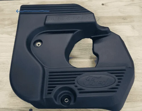

Well we finally got some rain. Checked this morning and the cover had a little bit of water in one of the grooves at the very back. Started under the leaky plastic clip and ran off to the passenger side.

I checked mine yesterday while washing it. I had drips from 2 of the plastic rivets, center one and one next to it on the driver's side. Only the center one was dripping on the engine cover but was just catching the edge of it. I'll be adding checking the plugs and sealing it up to my list of to-do's before the snow flies.

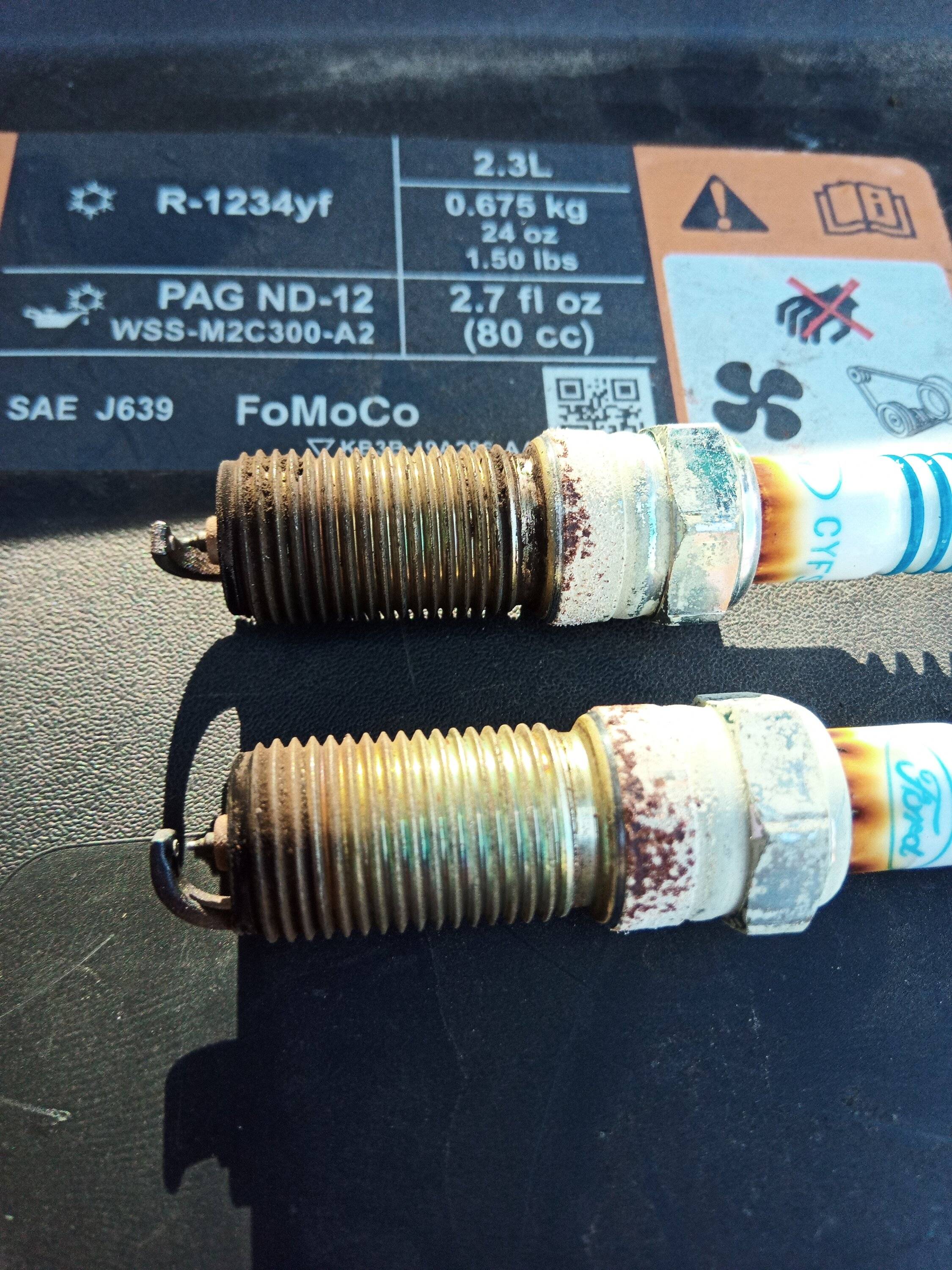

Pulled the plugs after the tell tale signs of worn plugs. (72k miles). The 1 & 2 plug had quite a bit of corrosion on them including rust. Glad I didn’t wait till 100k like the dealership says
