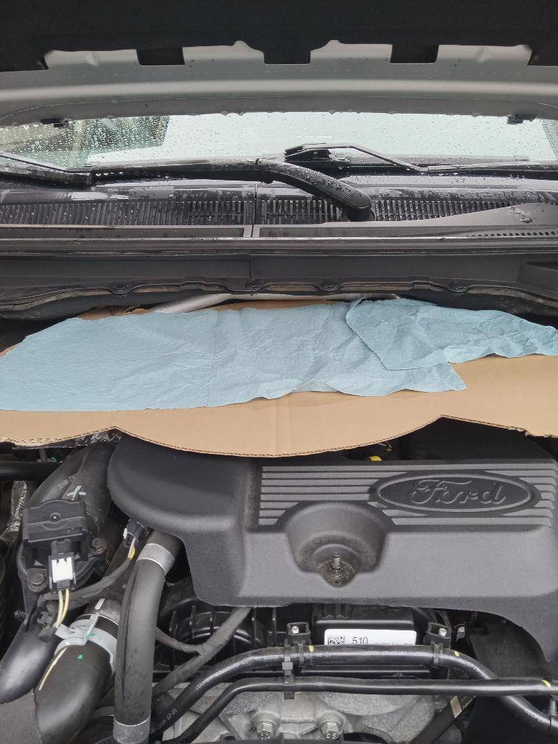

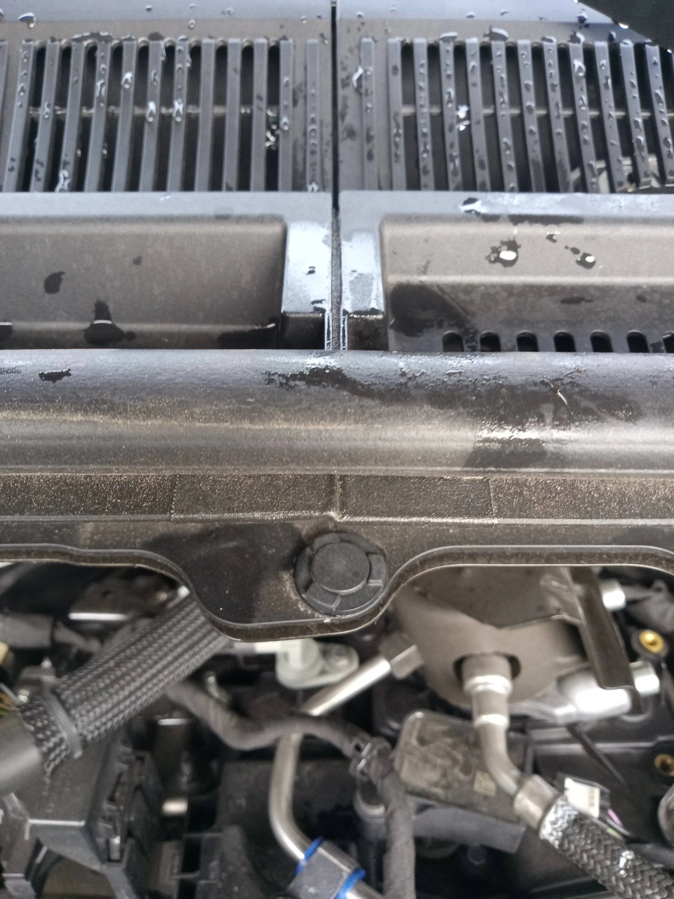

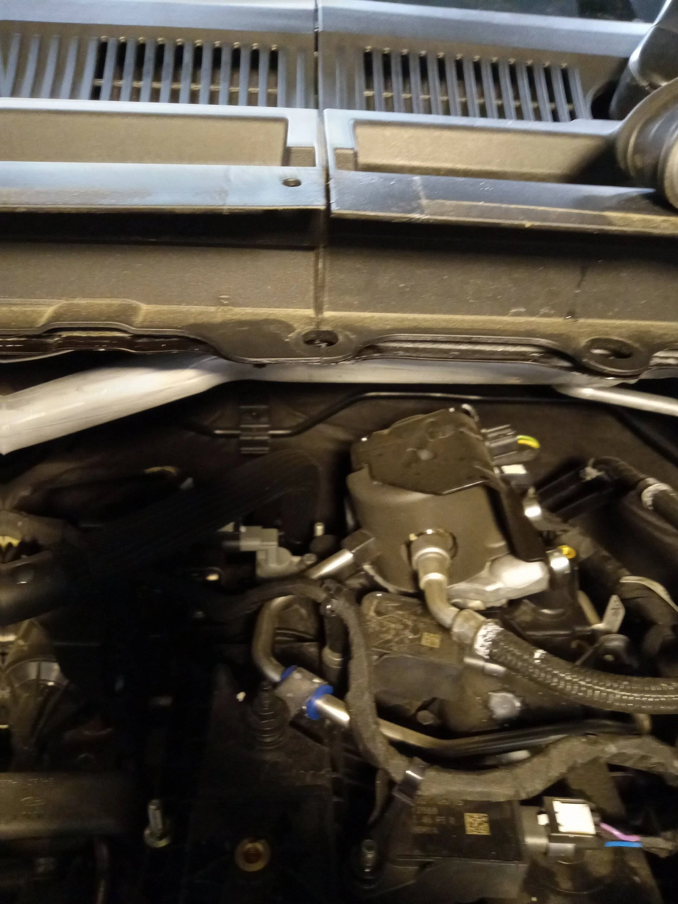

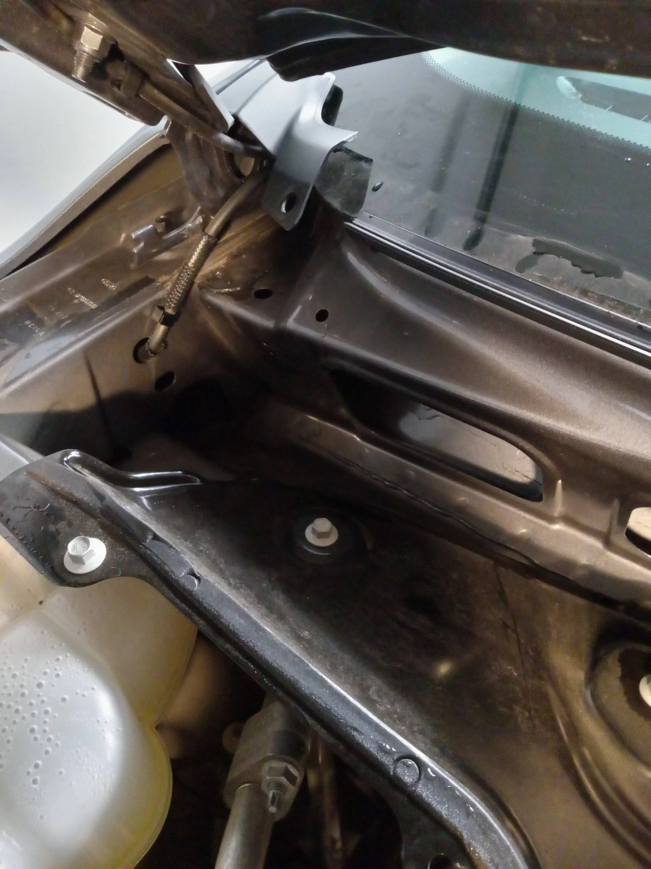

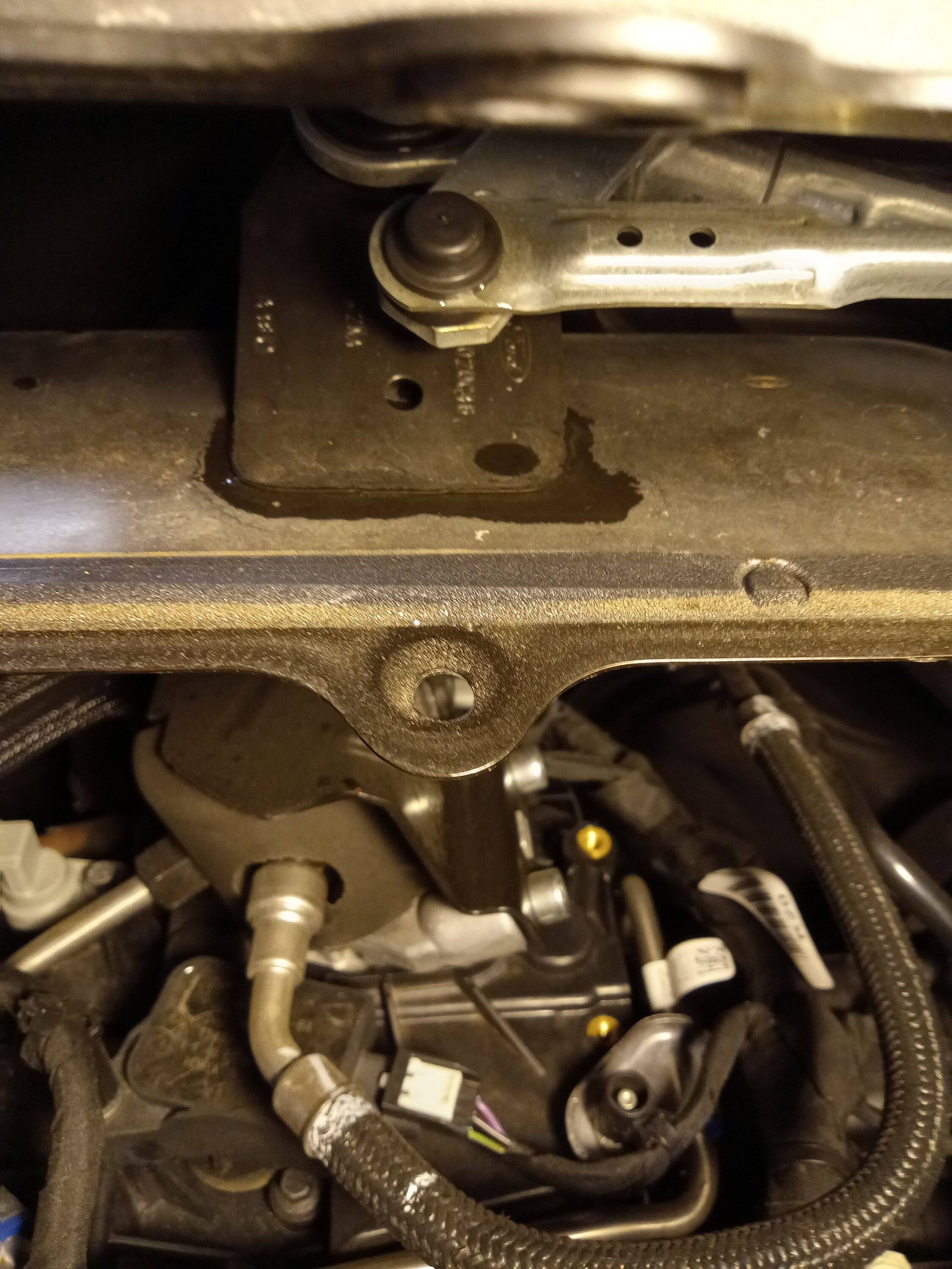

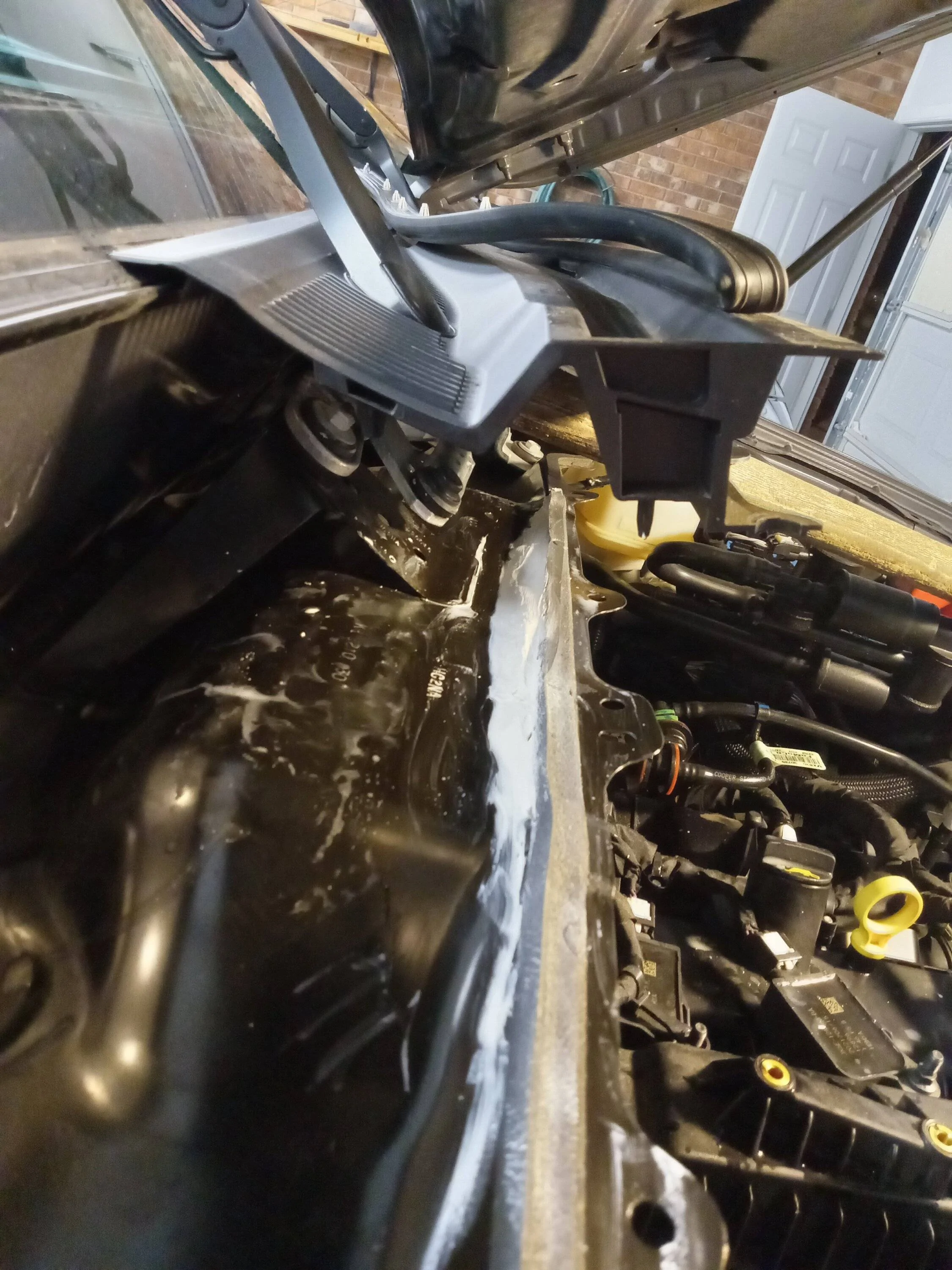

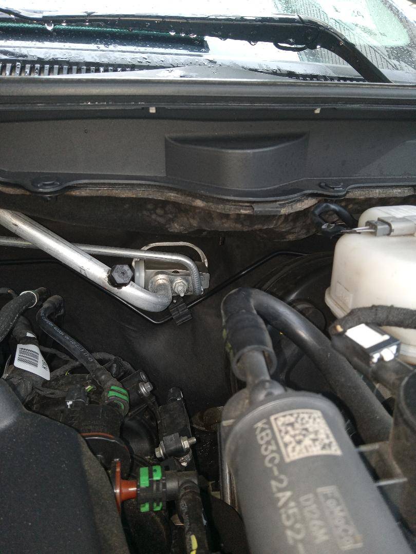

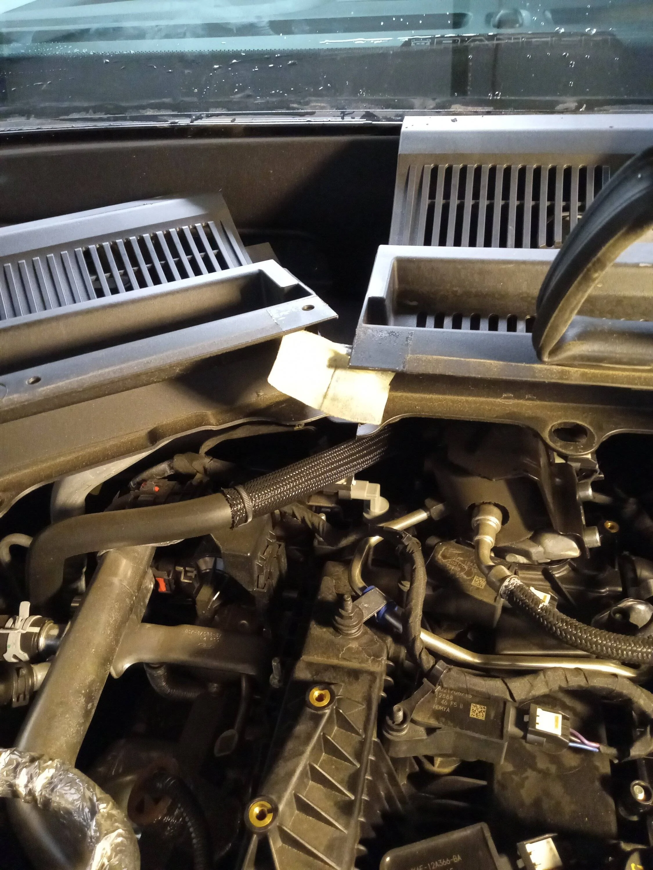

Watching this thread with interest and concern, so we had two days of heavy/moderate rainfall so it was a perfect chance to check for any leaks into the engine bay, i placed apiece of cardboard and some shop towels at the back most part near the firewall left it there overnight the next day there was a break in the rainfall so i then checked and the towels and cardboard were dry. The second pic shows mold on the soft material lining.
The foam/plastic sandwiched seam was wet but not dripping at all as i had the cardboard far enough underneath to catch any drips, so it seems the foam is absorbing what leaks to it, not sure if that's the way it's suppose to be, here's some pics & vid showing i tried to squeeze out the water.
