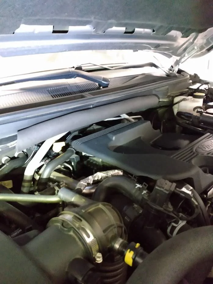

The engine cover is not needed to keep the water out , a piece of foam pipe insulation does a much better job ...

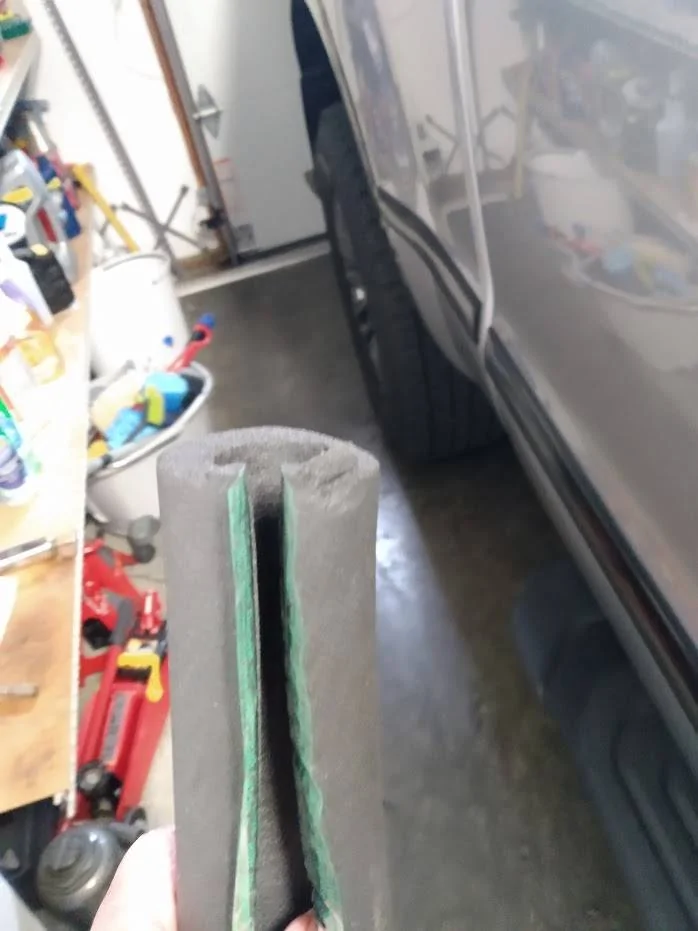

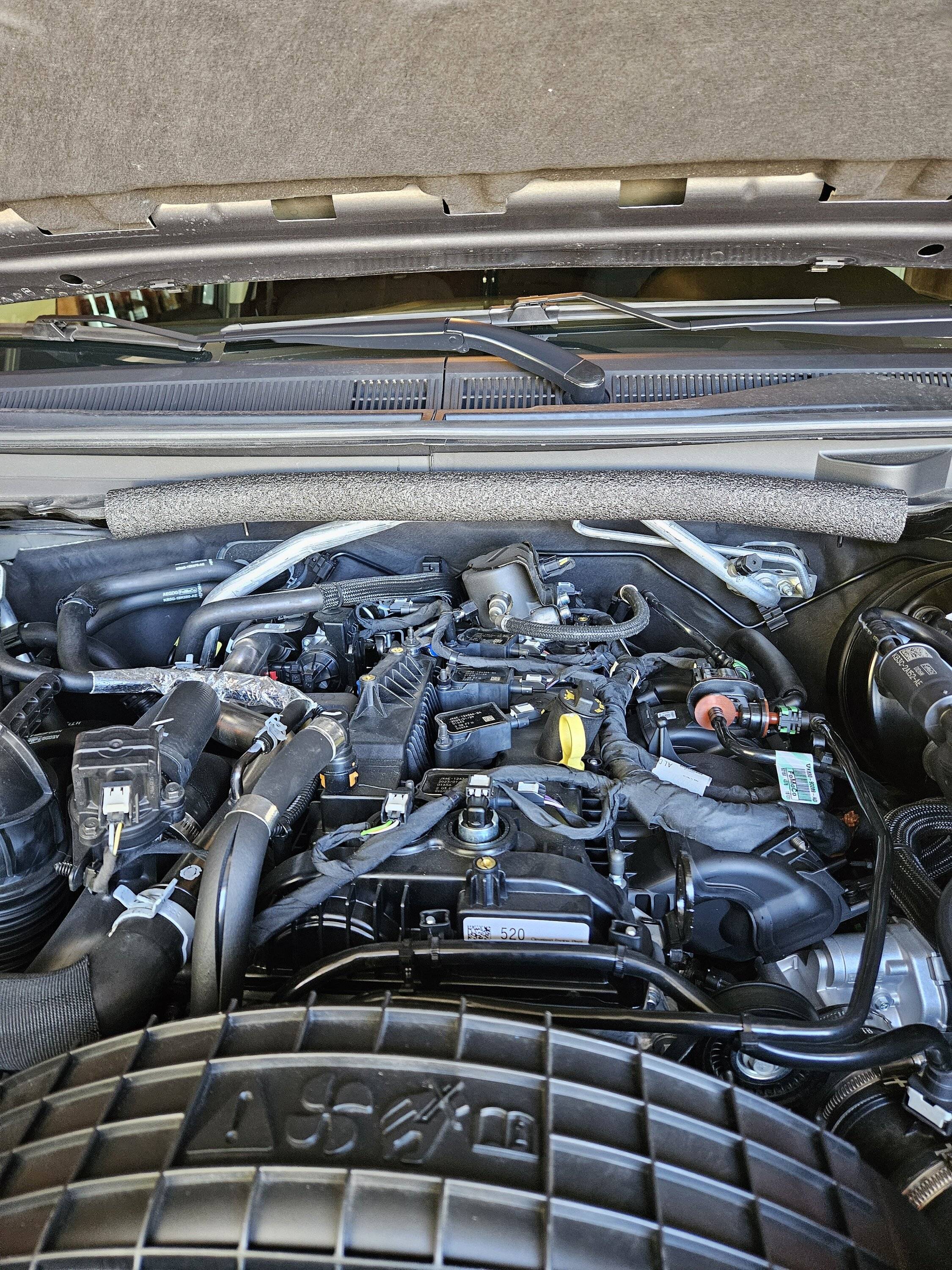

what is the ID size on the foam cover and what length did you use? Thanks.
5,911
29,451
On mine, I used 3/4 inch inside diam. split pipe insulation. Just cut the length to what you want...I cut mine to fill the straight area between the "humps" that protrude.
The split stuff comes with a "sticky" adhesive on the edge s of the cut...peel the protective film off and it will stick, especially on the top....make sure you clean the plastic cowl real good with a cleaner and wipe it down with some isopral alcohol so the sticky will stick.

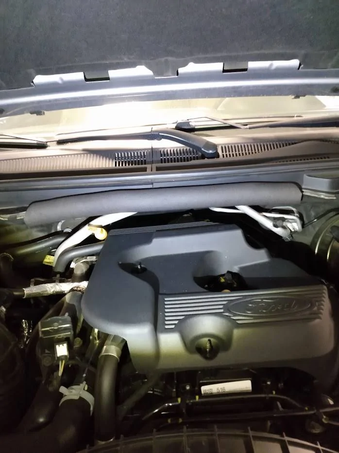

Good idea! I have an Engine Cover but will add this in addition. Is that insulation 1/2 inch ID or OD? Thanks.
Inside diameter, there is also tape you can use if you peel the plastic layer over the tape away, it's not a necessity to use the tape because the bottom side of the foam will kind of latch-up behind the rivets and hold itself in place. For length I went from about the middle of the two bump-outs on the seam (27 inches) so it wouldn't drip on anything electrical. I also plan on adding the engine cover.

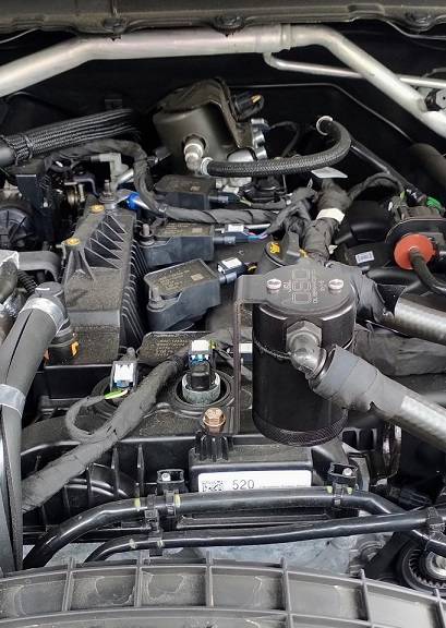

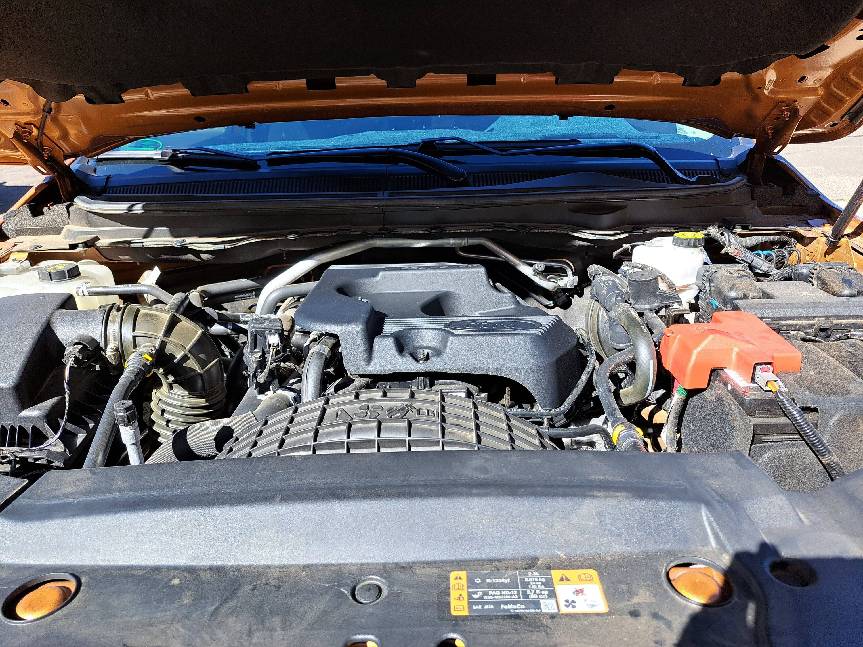

Anyone know whether the standard cover installed will clear my catch-can?

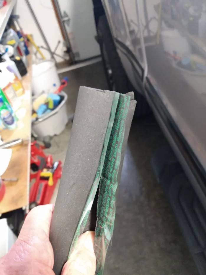

Assuming that the sticky adhesive is on the ID to hold it onto the plastic seam in the truck? Where did you buy the foam?

Assuming that the sticky adhesive is on the ID to hold it onto the seam? Where did you buy the foam?
Sticky is on the edge of both horizontal cut edges so it will stick to itself when wrapped around a pipe. The adhesive isn't real "sticky"...kind of like the stuff on a band aid.... just made to stick to itself, but it works well. Been on mine for several months. Cheap enough to replace often if needed.
Lowes/Home Depot carries it in the plumbing section....just a few bucks for a 6 foot length.
