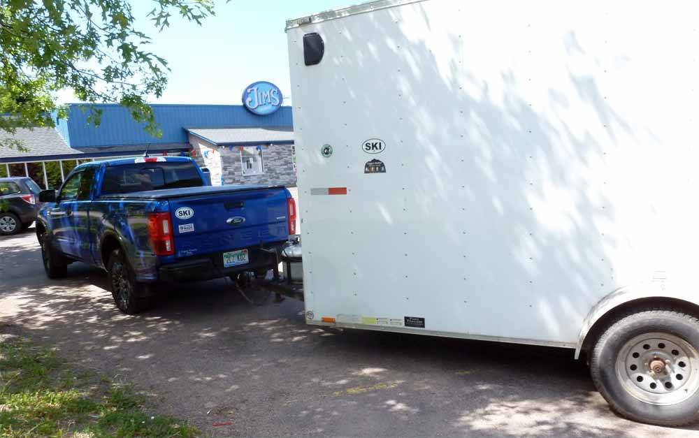

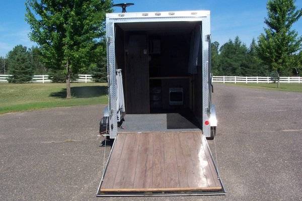

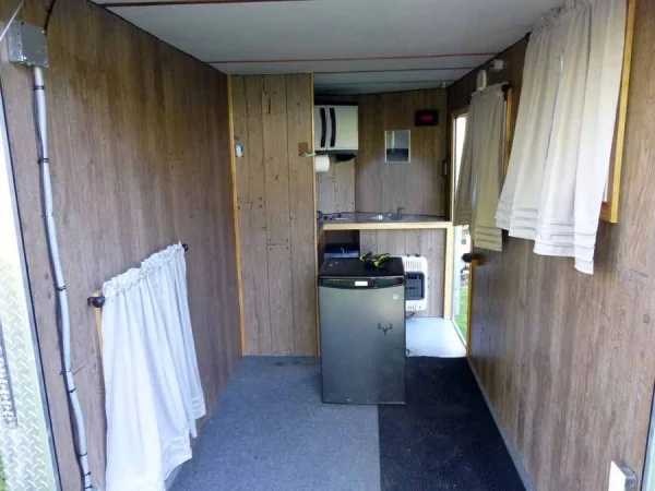

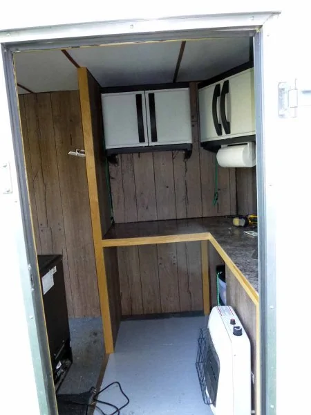

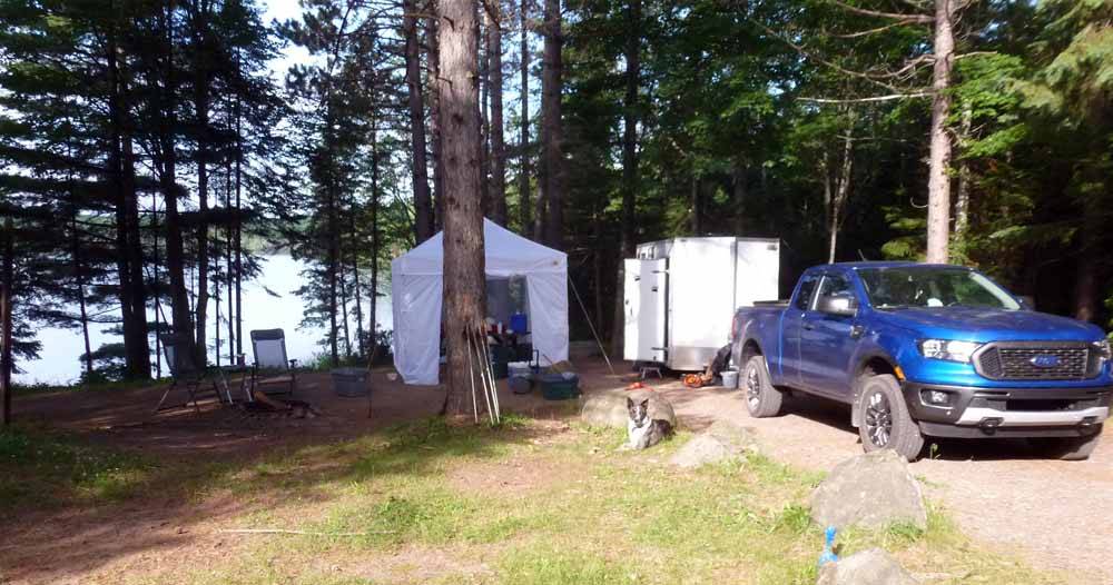

A few years back I did post some but I'll do it again but there really isn't must to see. It was setup to haul a fellows ATV but we wanted to haul our 6x6 which is longer, so we pulled the appliances out and 1/2 the added wall seen on the trailers left side. Its small and simple,, like us. We camp without power and a water supply.

thank you for re posting! that things perfect, plenty of room for the toys and its off the ground, secure and room for a good sleep.

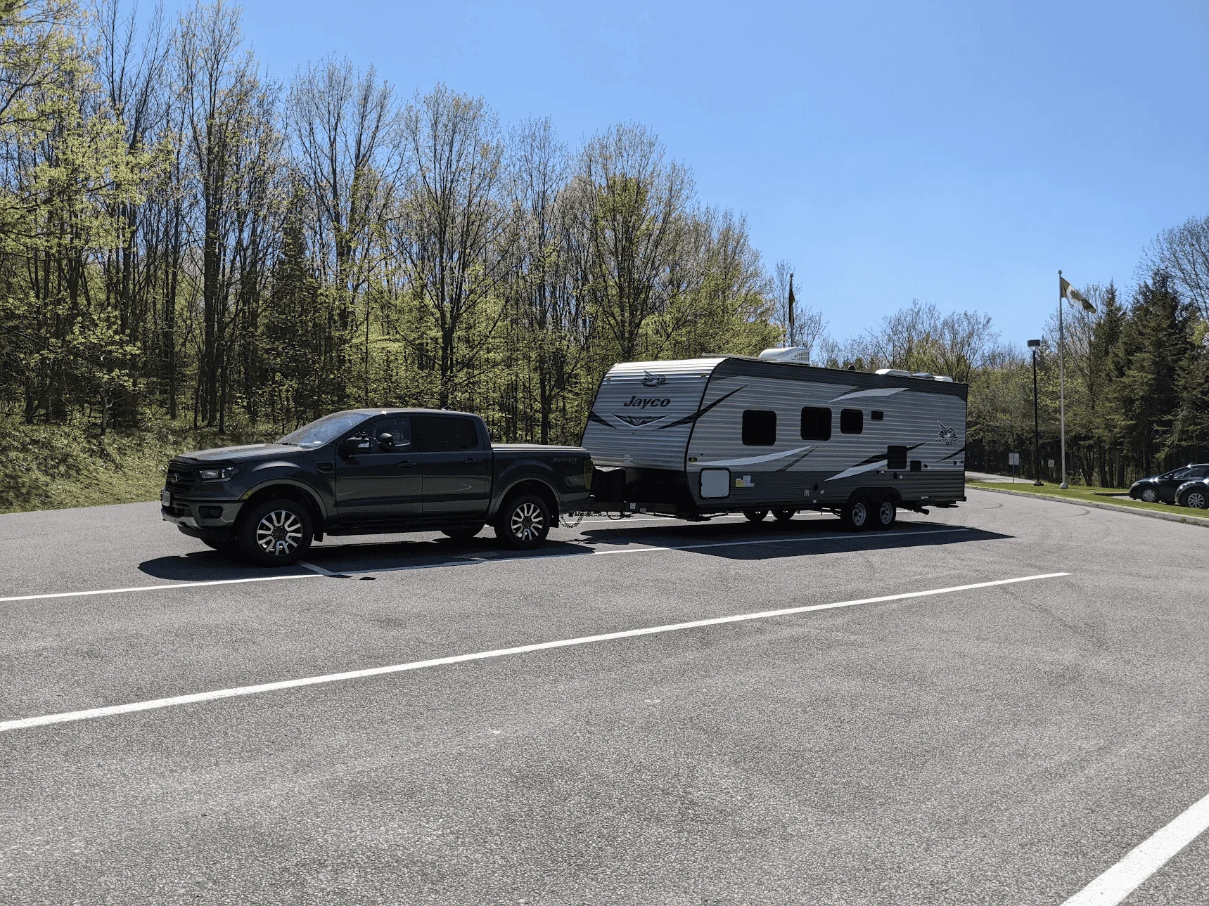

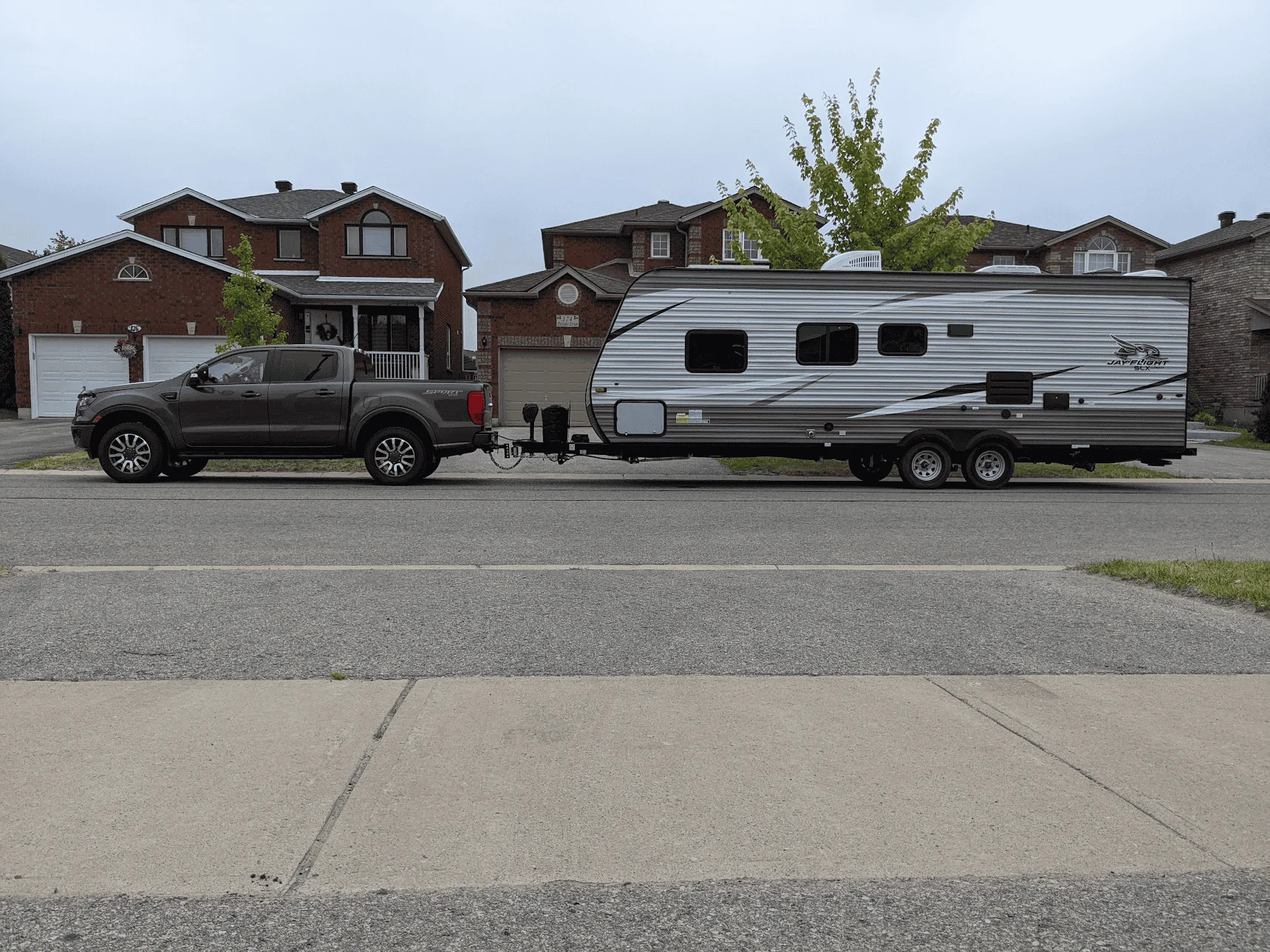

I installed SumoSprings recently and wanted to share some pics. They're not the best pics since they're not from the exact same angle (the first one isn't even from the same trip) but the effects can be seen (especially if you can flip through them in slideshow).
1 is without SumoSprings. No weight-distribution (chains loose).
2 is after installing SumoSprings. No weight-distribution (chains loose).
3 is after installing SumoSprings. Weight-distribution is active (chains tight).
Unfortunately I don't have photo without SumoSprings and with weight-distribution at the same angle to compare.. but I do have this:
The difference that SumoSprings make when not using weight-distribution is quite substantial.
  • Without SumoSprings the rear of the truck sags 1/4" lower than the front (I have eibach shocks in the rear so it would likely sag even more with the stock shocks).
  • With SumoSprings the rear remains 1/2" higher than the front. Ride quality is much improved and there's less bouncing and floating in the rear.
The difference that SumoSprings make when combined with weight-distribution is less substantial but still very noticeable and appreciated.
  • Without SumoSprings there is a lot of dependence and stress on the WD hitch/chains/bars/whatever to hold the rear of the truck up so that it's not sagging. I had my hitch set so that the rear was about 1" higher than the front, FYI.
  • With SumoSprings the rear holds itself up and weight seems more easily distributed to the front of the truck. The rear ends up being 3/4" higher than WD without the SumoSprings, and it's much easier to hook and unhook the hitch/chains/bars/whatever.
This is with about ~650 lbs on the hitch.
Pretty happy with this upgrade. It wasn't easy though, since removing the stock bump stops turned into a huge project in itself (bolts snapped, bolt extractor broke off, etc etc).
