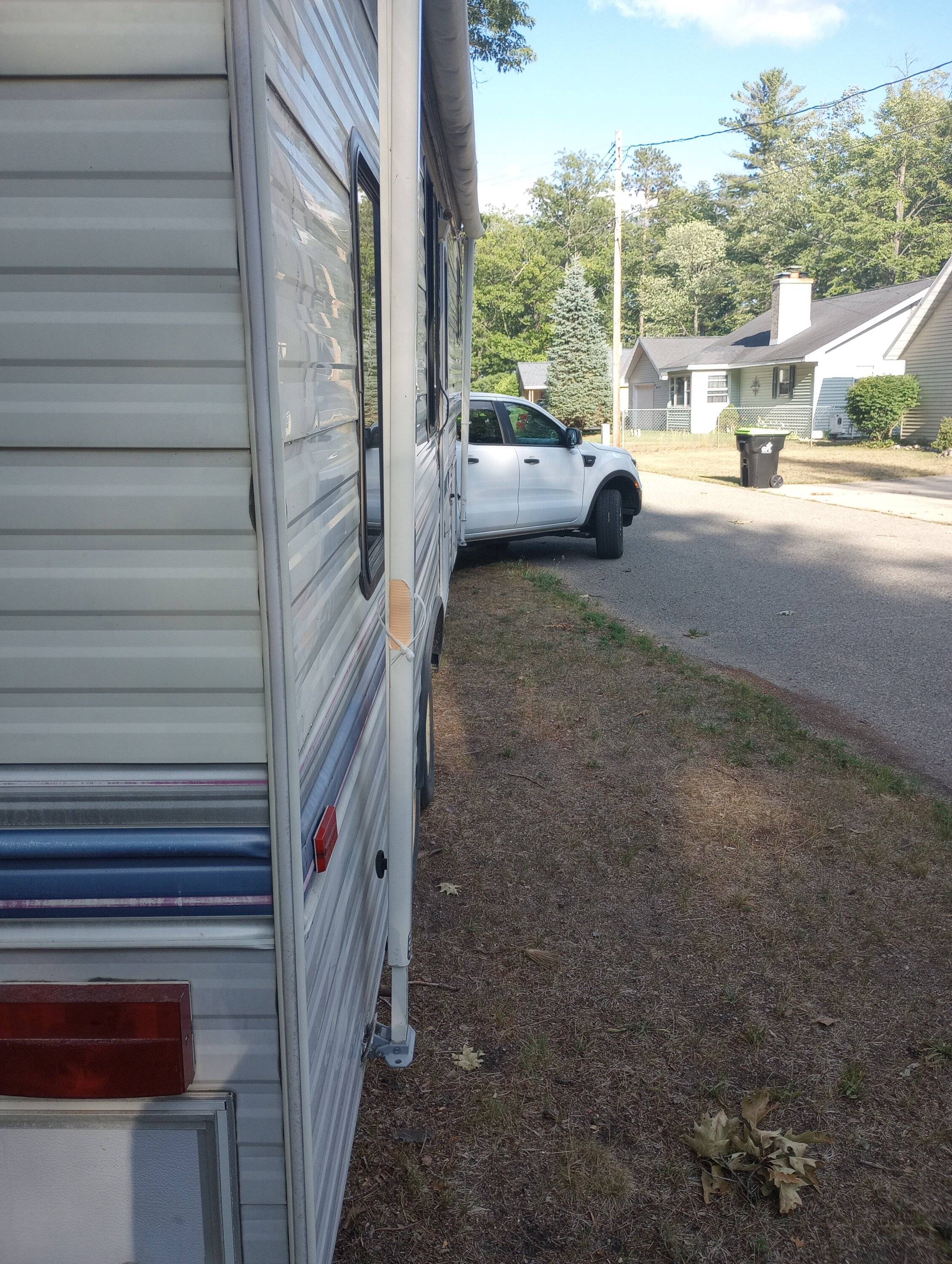

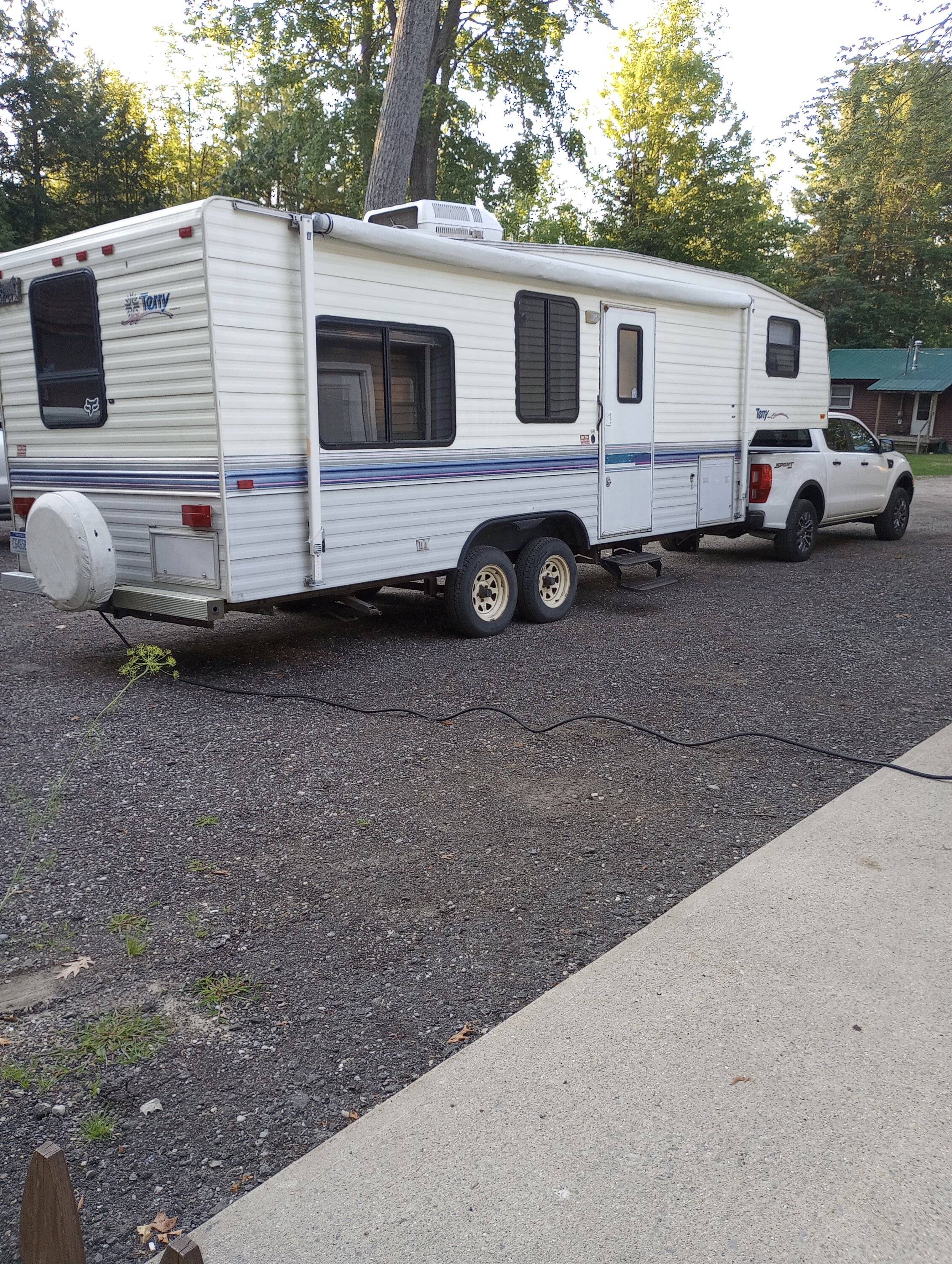

27' Fifth Wheel. 5200 lbs dry weight. 750 pin weight. Pulls fine so far.
Wow! That’s a lot of trailer. Yeah how tight can you turn with that short box. Really the dry weight means nothing. Have you weighed it loaded ready to travel, and what is the combined weight. That's what counts.

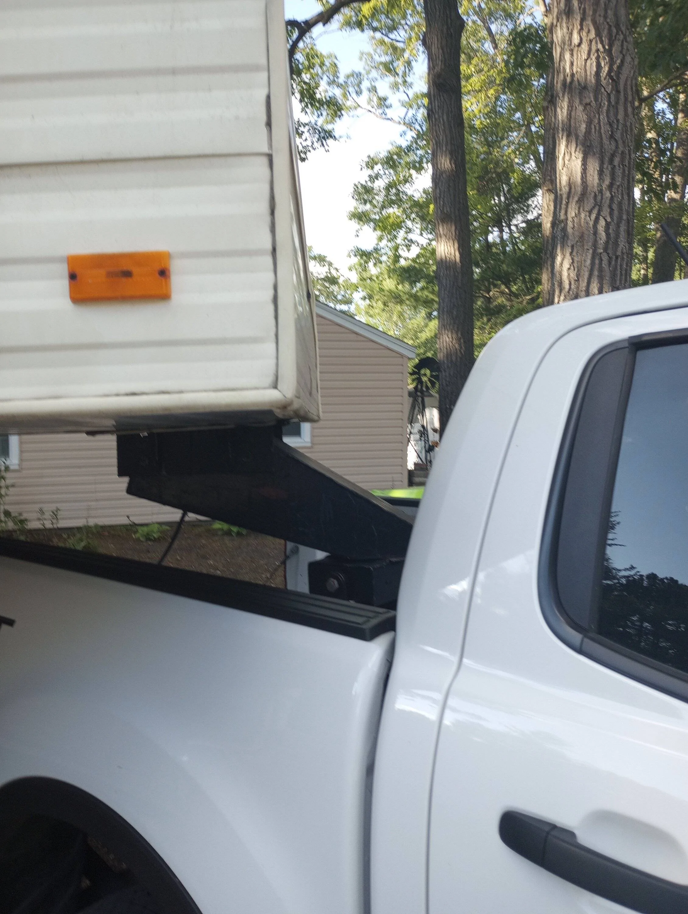

It's a 10" slider hitch. Plenty of turning radius. I'll post some pics next time I hook it up. Also the truck cab is about 12" narrower than a full size truck. 750 pin weight over the axle only lowered the back 1".

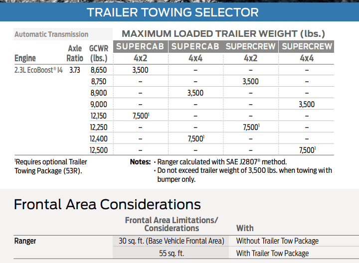

That chart is MAXIMUM LOADED trailer weight and there are a lot of other little but important clarifications to it. Like that is with an empty truck with one approximately 160 pound driver. Also it specically says not to exceed the GCVWR of the truck, which is 12,500 pounds for a crew cab 4x4 and goes down for supercab and 4x2.
My guess if you weigh it loaded for camping with family you will be at if not over the GCVWR.
