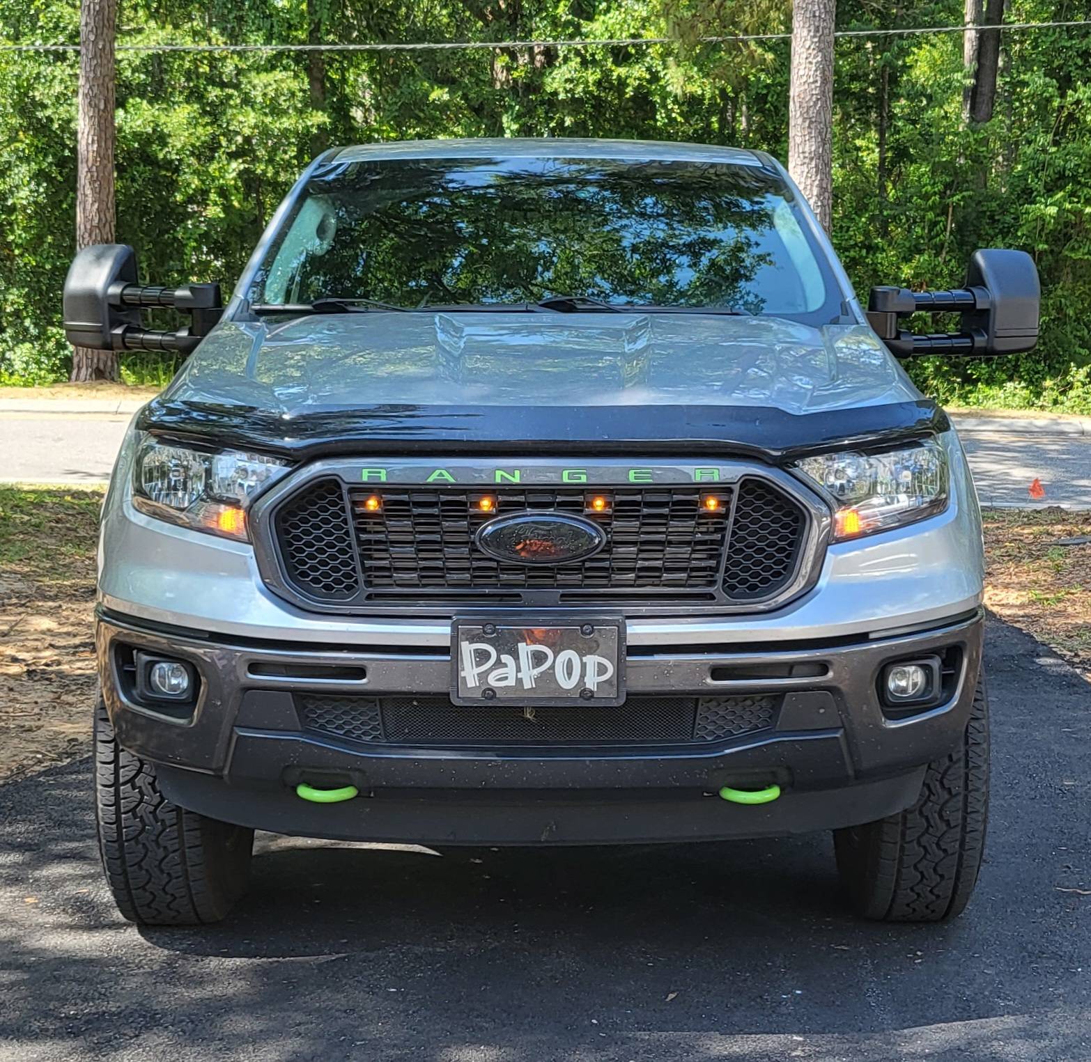

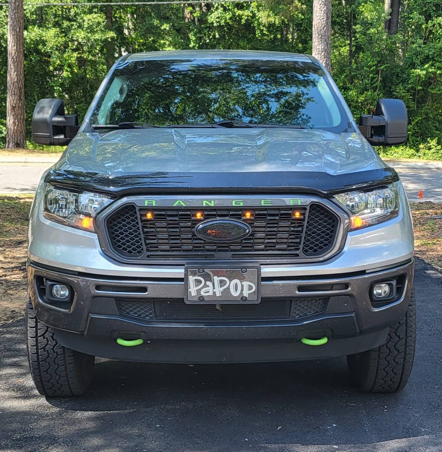

I have a set of ClearView's mounted, and they are truly a game changer. If you tow a travel trailer, they are the best investment you can make.
As for rearview cameras...for you younger techie people they may be great. But for old farts like me...well, I'm so used to checking my rearview mirrors on a constant basis, the a camera is just not necessary. When towing I'm constantly scanning my rereviews. Even when I don't tow, when I back the Ranger up, I still look in my rereviews and over my shoulder. Just habit from almost 60 years of driving.
