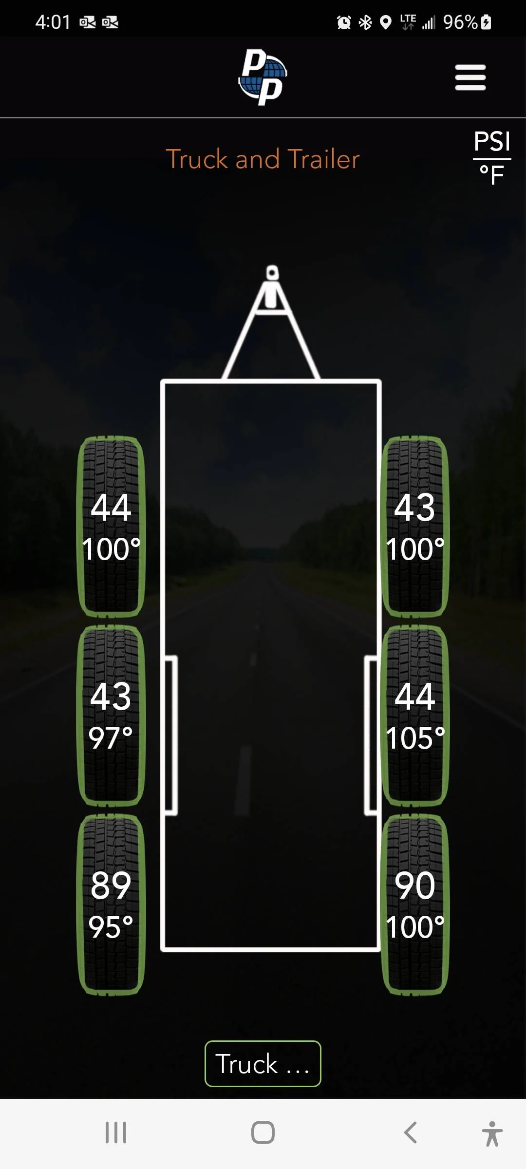

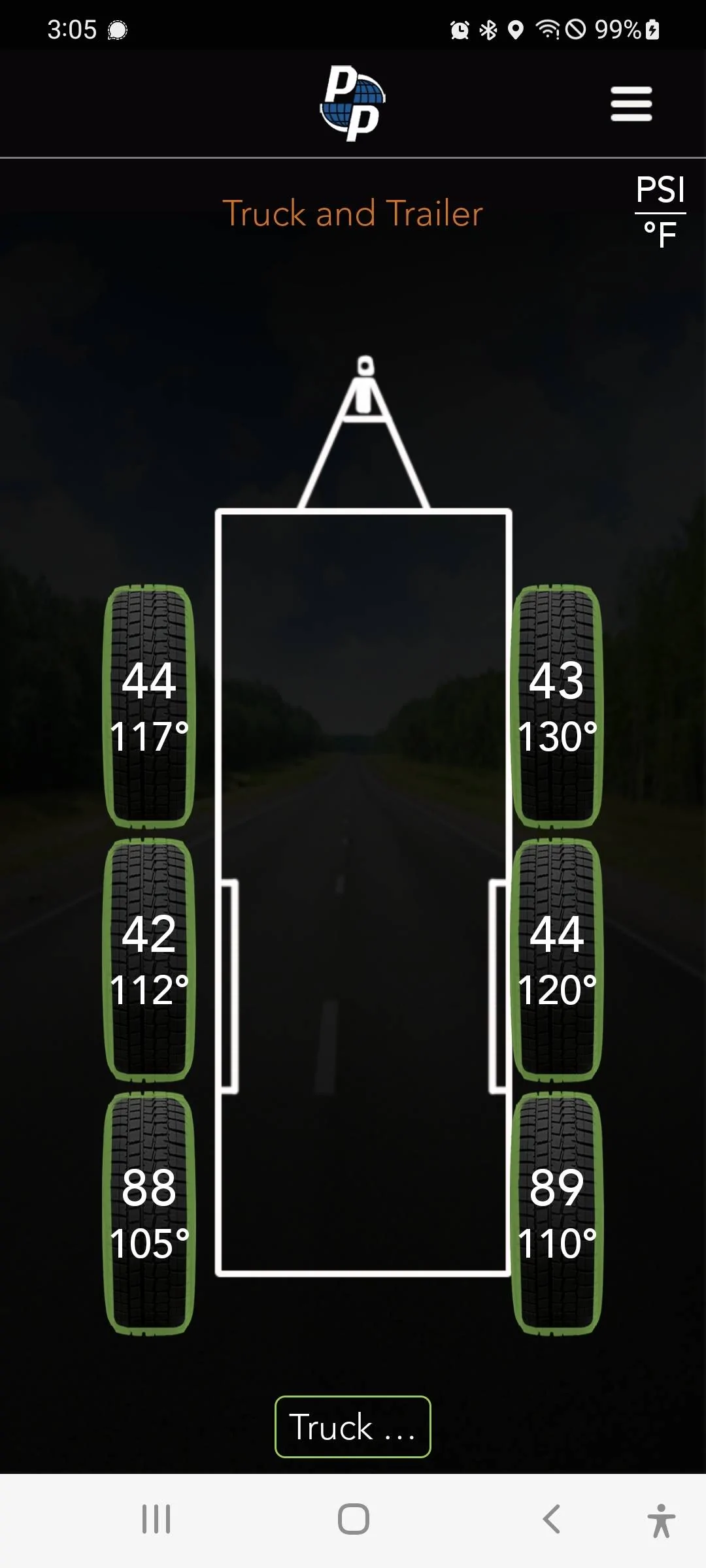

On another note, I have found a good TPMS to be invaluable. I am using this one:
https://www.etrailer.com/TPMS-Sensor/JR-Products/372FX4K.html?feed=npn&utm_source=google&utm_medium=cpc&utm_campaign=Google | Shop - Low Volume - 1000&adgroupid=140227600687&campaignid=10274415741&creative=597205810020&device=c&devicemodel=&feeditemid=&keyword=&loc_interest_ms=&loc_physical_ms=9032152&matchtype=&network=g&placement=&position=&gclid=CjwKCAjwt7SWBhAnEiwAx8ZLagQYc443T45xWhh0I734ZQgfgMULyCej2cZZC15m8ThH9rCNKYOn7hoCVhQQAvD_BwE
Plus two additional sensors for the trailer tires. In addition to pressure, the sensors also measure the temperature at the sensor. This save my bacon when we were coming down a long steep grade (108 from the summit down to Dardanelle in CA). Luckily, the TPMS threw an overtemp on the front tires before we lost our brakes! Turns out what I "thought" was enough trailer brake was not nearly enough, and the truck was doing too much of the work. We pulled over to let things cool down (by the time the interior of the tires had gotten to 150 degrees the rotors were well over the 600 degrees F that DOT 3 is rated for. One rotor measured 850 degrees F. Yiikes!)
Anyway, long story short, if you have a big enough trailer to need a WDH you might also benefit from a TPMS.
Here are two screen shots of the TPMS display. The first is coming down from Ebbets Pass on Highway 4 - a steep grade with numerous 6% and a few 8% sections. The second is down at the bottom after things returned to normal. We keep an eye on this going down grades in order to know if we are going too fast or about to have a problem.
When the tires are showing 130 the rotors are much hotter, around 500 F. DOT 3 is good to 600 F and then starts to fade if the temps go higher. If the temps had gone much higher we would have pulled over and let things cool down, but this was near the bottom of the steep sections and we still had good brake performance.
You can see the graphic showing the temps is a little off - I haven't figured out how to get the app to let me have the truck and trailer on the same page with appropriate graphics, so am using a 3 axle trailer template. Other than that very happy with the Pressure Pro.
It isn't ideal, but absent getting sensors for the rotors themselves it serves as an adequate p
