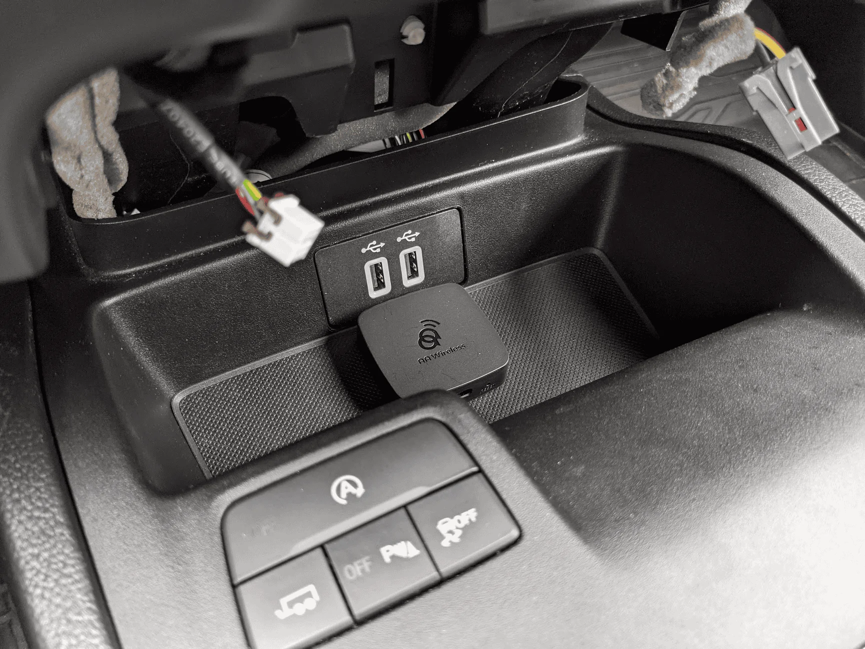

Here's the AA Wireless size for reference. Ignore the missing panel above as I was doing something else when I took this photo.

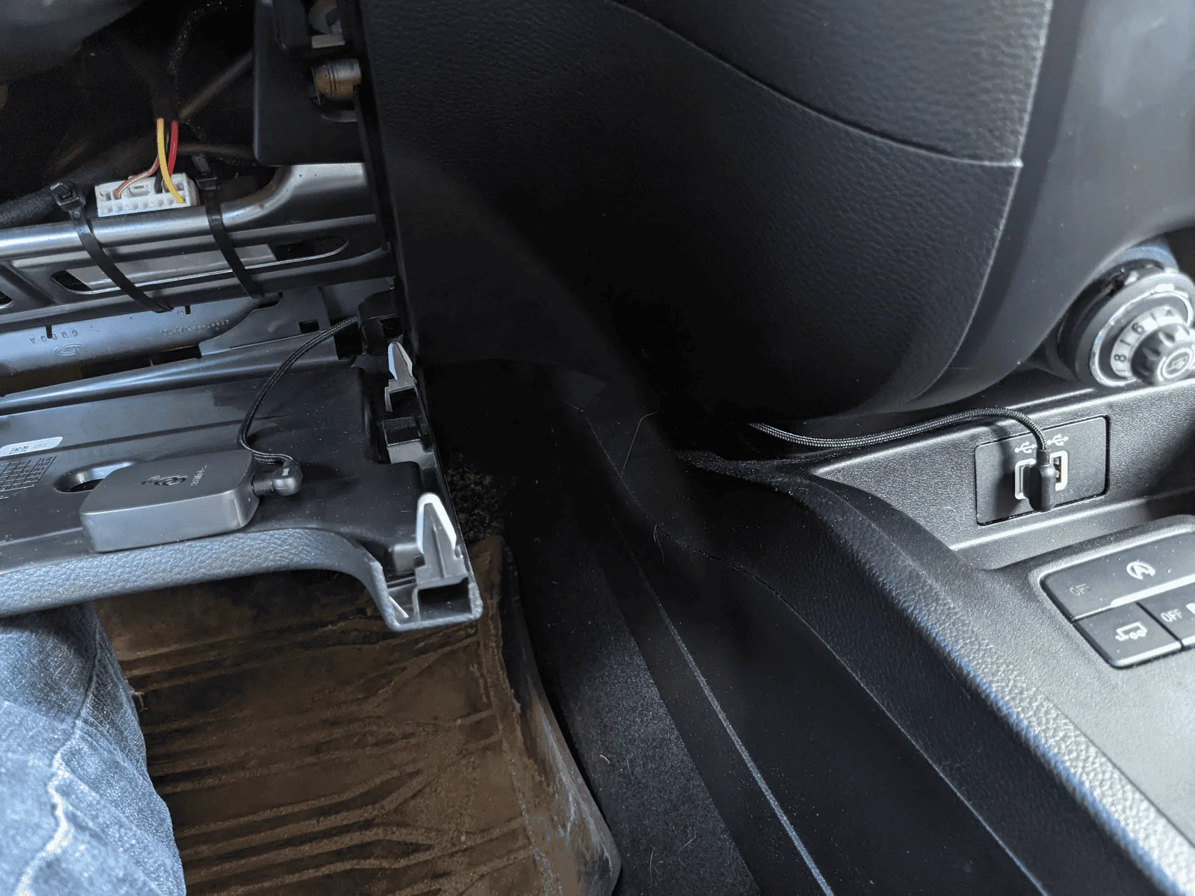

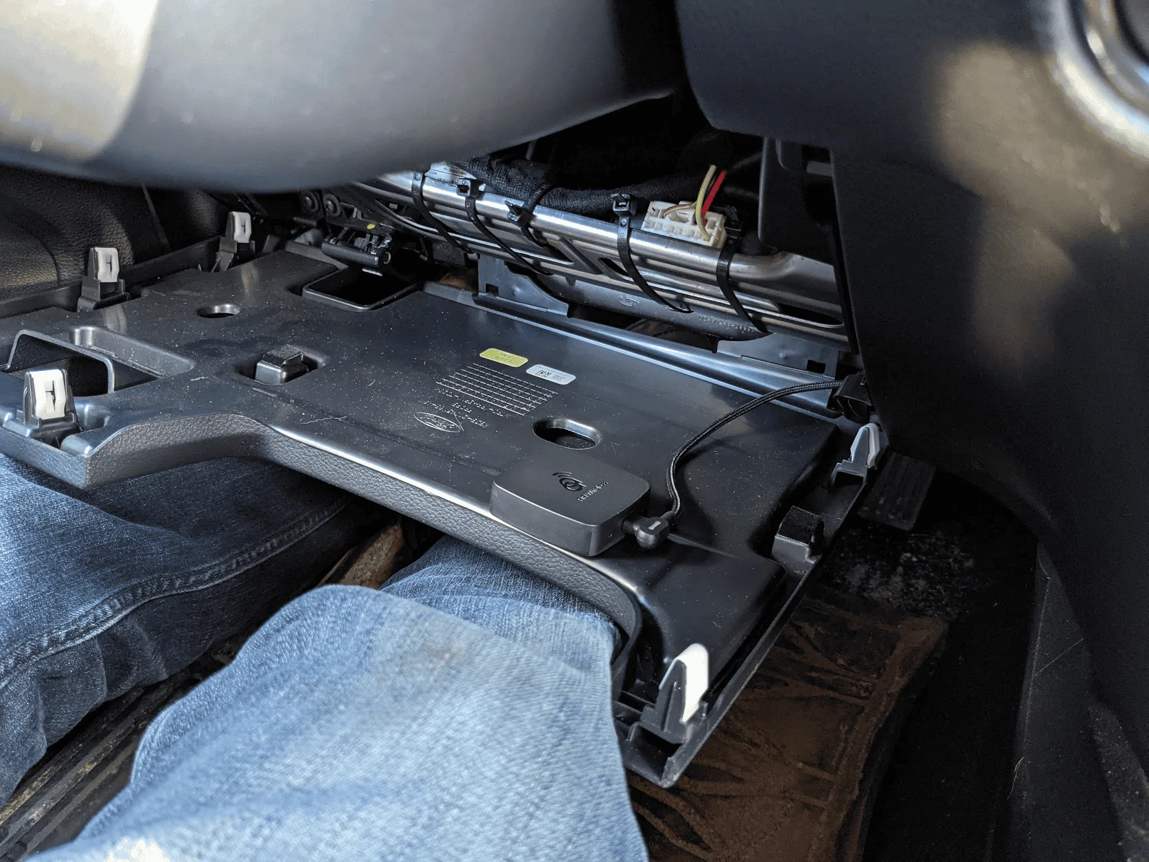

Here's my AA Wireless hidden away and connected with a mostly-hidden right angle cable (from Amazon):
