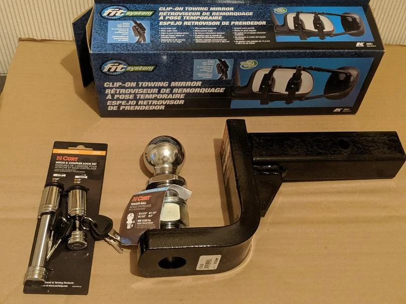

I'm thinking of picking up one of those solid aluminum ball mounts for my ranger like this ( https://www.etrailer.com/Ball-Mounts/Fastway/DTBM5600.html ). But figured I would see what you guys were using. Looks like I'm going to need a 6" drop for the trailer I use the most. Also what are your thoughts on an aluminum ball mount? Hoping to reduce the rust and keep it looking nice.
Here is what I have. I would not trust my 7000 pound trailer to aluminum. It is a 6-inch drop with large ball. If I were planning to tow a variety of trailers that were lighter I might consider the adjustable aluminum. The items in the picture are dedicated to my cargo trailer.
