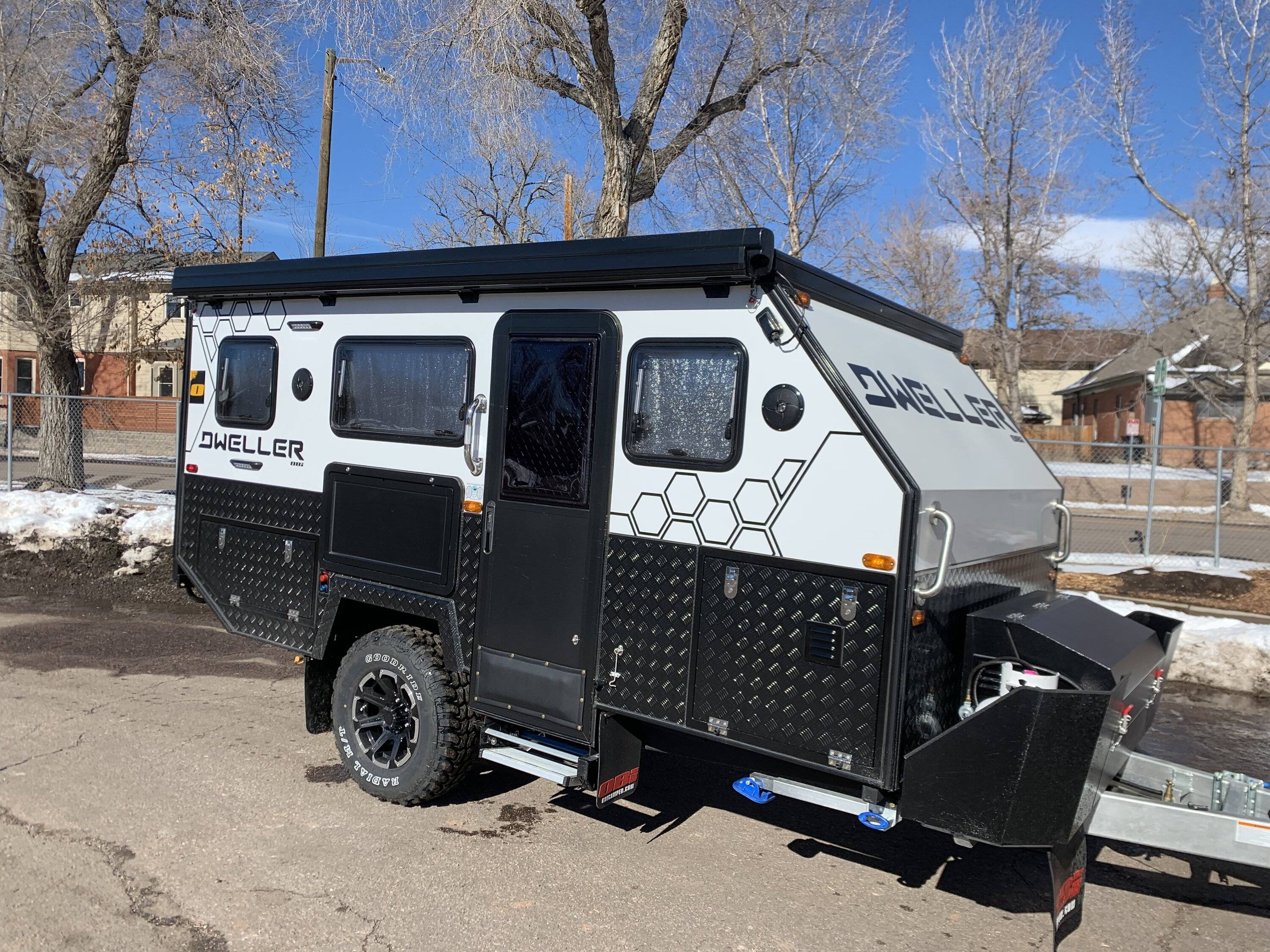

Thanks for the reply and I appreciate the details.
What’s really scary, is how fast it went wrong. Where my brake controller is I would of had to be leaning forward with a hand on the lever to effectively activate it. Unfortunately, when it starts to happen your instinct is to grab onto the steering wheel and hit the brakes!
We pull an OBi Dweller13. Similar to the Opus line in Australia, and pretty close to yours in weight ratings. Even though we are shorter, and only have the two wheels our gross is nearly 500 pounds more. I have also found it tows better with just the front water tank filled, but we mostly boondock and acces to water is often difficult here. And I upgraded the stock shock absorbers to Monroe Heavy Duty, big difference!
Back to the video, do you know…how fast they were going? And if that trailer had an articulating hitch. Any sort of sway control or weight distribution system?

Yes that van looks very similar to the Opus line, obviously comes from the same manufacturer. I know what you mean about water, when going bush camping you have no option but to fill everything to the top. With both 80 litre tanks full we have about a week of water, longer if you can augment supply with clean creek water for washing etc.
