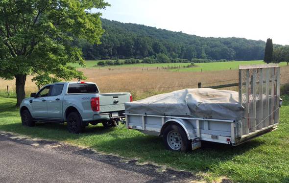

Now that I have 1300 miles on my Ranger, I used it for the first time to go for my bulk load of sawdust/shavings that I use for horse bedding instead of using the old Mountaineer. I have lots of experience hooking up & towing, parking, backing up with a trailer since I used to haul and show my horses. I really liked the trailer align feature on the Ranger.

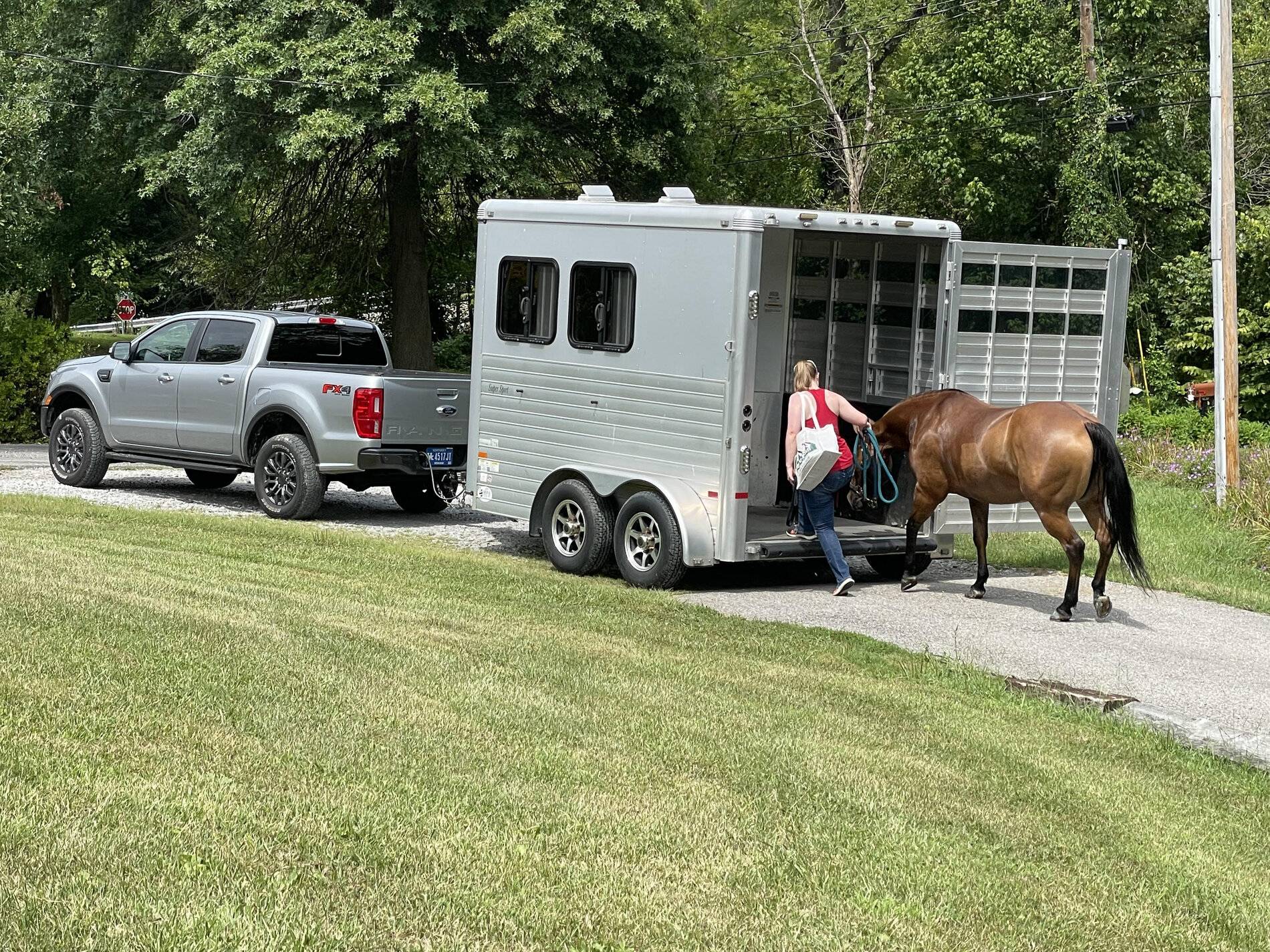

Just wondering what everyone’s going to be towing with their new rangers? Post pictures too!!
Jake
Sundowner High Cube 2 Horse, a quarter horse, saddles, and tack trunk
aka the barn, the mare, the accessories and Mary Poppins purse
Scaled out and was somehow (barely) under GVWR with a full tank of gas

The Ranger had no issues pulling that? I will have the same set up , but going through some mountain passes.
Honestly it handles better than the 2016 F-150 XL equipped with the max tow package. Reasons being I have lane keep, blind spot, and 4 more gears which the F-150 doesn’t have (the 2016 that is). I did self install the “Ford” trailer brake controller which is really the ahem towpro but… it is a beast and I never have to second guess it. I have some relatively steep grades here in KY but nothing sustained like the Rockies. If your passes are comparable to to the WV Appalachians, the only thing that will flinch is your MPG.
This all said I cleared the scales by being the only human in the truck, dog was riding rear shotgun and no cargo (hay bales, bedding)
I still have to play around with the placement of these items if they are to ride with me etc.
My biggest concern was the frontal square footage area since it is literally a barn I’m dragging, but the lane keep on the thing is killer when it comes to wind gusts.
also to define “barely” I was 1k under on the steer, 30 pounds under on the drive and 3450 under on trailer weight.
Sorry for the info overload but hope it helps.
Perfect, thanks for the info?. Much appreciated

This brought you to nearly max? That seems like it would be SO much lighter than 7000+ pounds. How much does the trailer and horse weigh?
Sorry to question your numbers. I assume they are based on axle ratings. From the looks of them you are running a lot of tongue weight. That is a value you did not include. But is also a critical number. From these numbers I also assume you are not running a WDH. That would take some of the weight off the rear axle ang get it back on the front steering axle. I realize the trailer is not loaded fully in the picture but it looks to be nose high. Not good for sway control and definately not good on a tandem axle trailer. It unbalances the load on the trailer axles.
Don't mean to criticize your setup just pointing out some observations.
