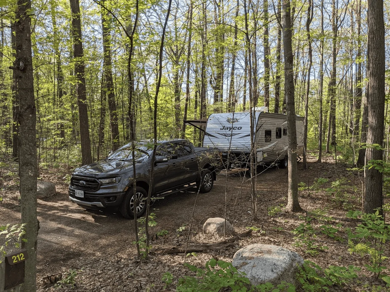

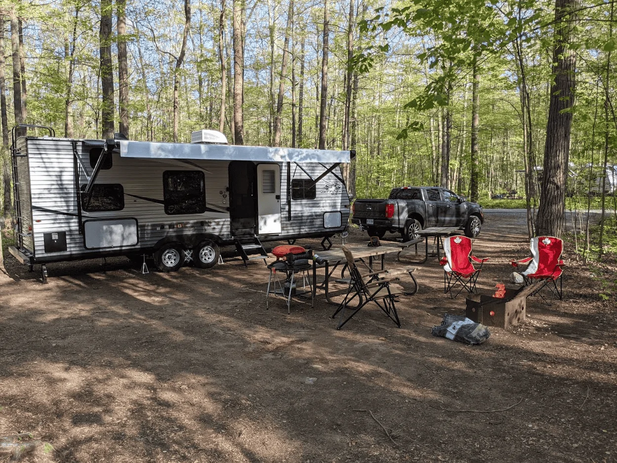

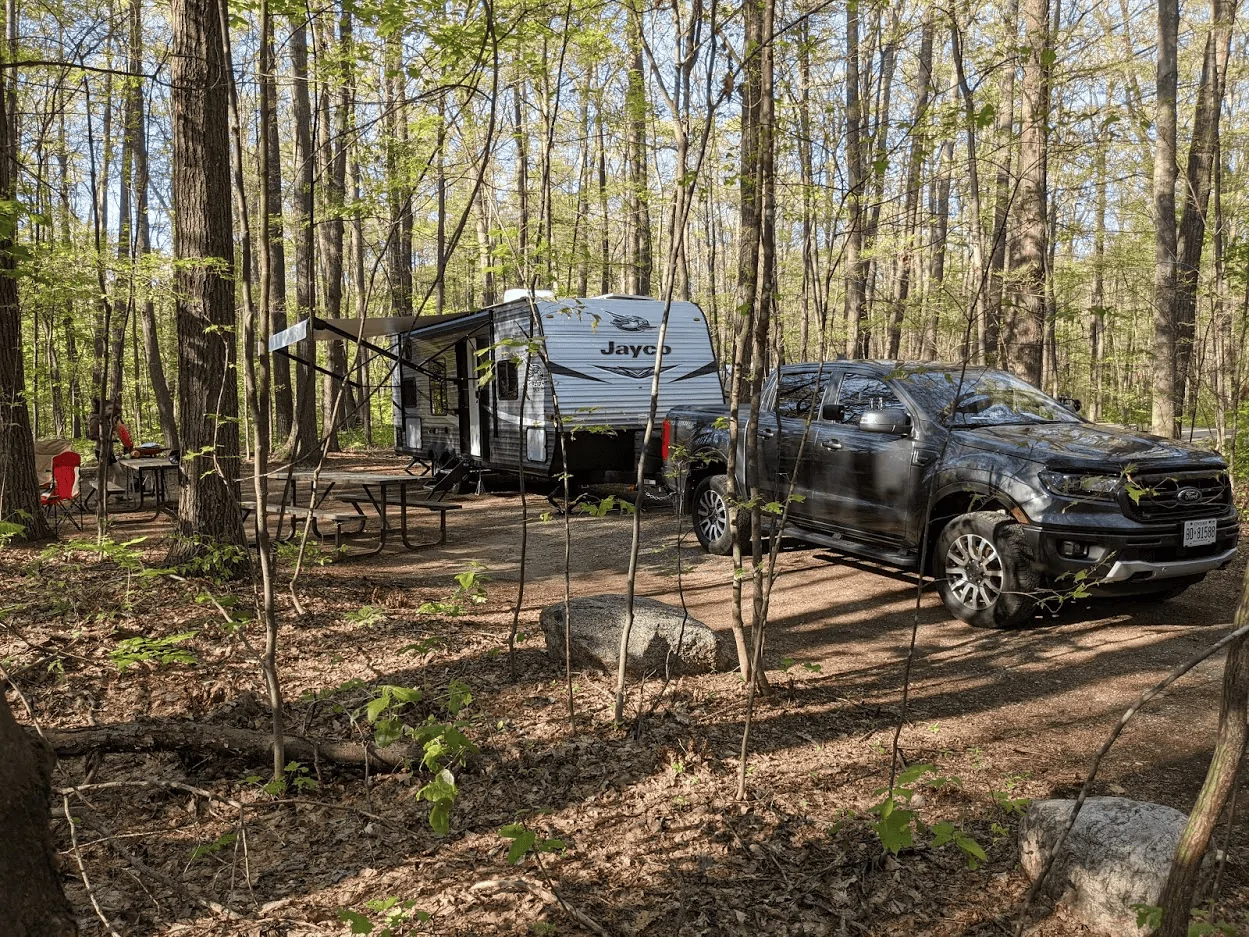

Finally got to take the new trailer out. Our destination was about an hour from home and we drove 90-100 km/h (55-60 mph) for most of the ride there and back.
Verdict? It didn't feel any bigger than the old trailer. It was smooth sailing there and back without any sway whatsoever. I was loving every moment of it. The Ranger handled it with ease.
This trip was night and day different from the original trip home from the dealership (see quoted post above). Aside from being the windiest day ever, what I failed to realize at that time was that the trailer came loaded with water from the dealer. Nearly 400 lbs of it sitting a few feet forward of the axles. I took a test drive before and after emptying the water, and wow what a difference that made. Handling was definitely affected by the water, and the wind caused the water to slosh around a lot. Not to mention I would have been way over max tongue weight because of it.
P.S. I had my tires at 35 psi. A little above what's listed in the door. I chose 35 for my test drives and was going to try 40 on this trip. Now that I'm back from it, I don't think I'll bother trying 40 psi.
We took the trailer out again this weekend but left the truck tires at 30 psi instead of 35 psi. Definitely noticed a difference and will be sticking to 35 psi when towing on future trips.
We left on a windy day and came back in the calm. There was very minor sway from wind gusts and a few vehicles that passed, but nothing of concern, and definitely no white-knuckling. Still, it felt sloppier and less comfortable than 35 psi, which felt great in comparison.
