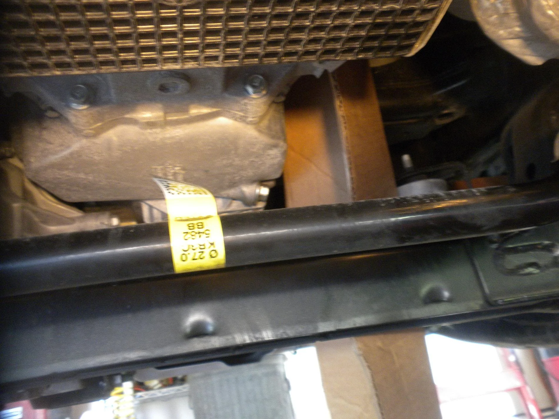

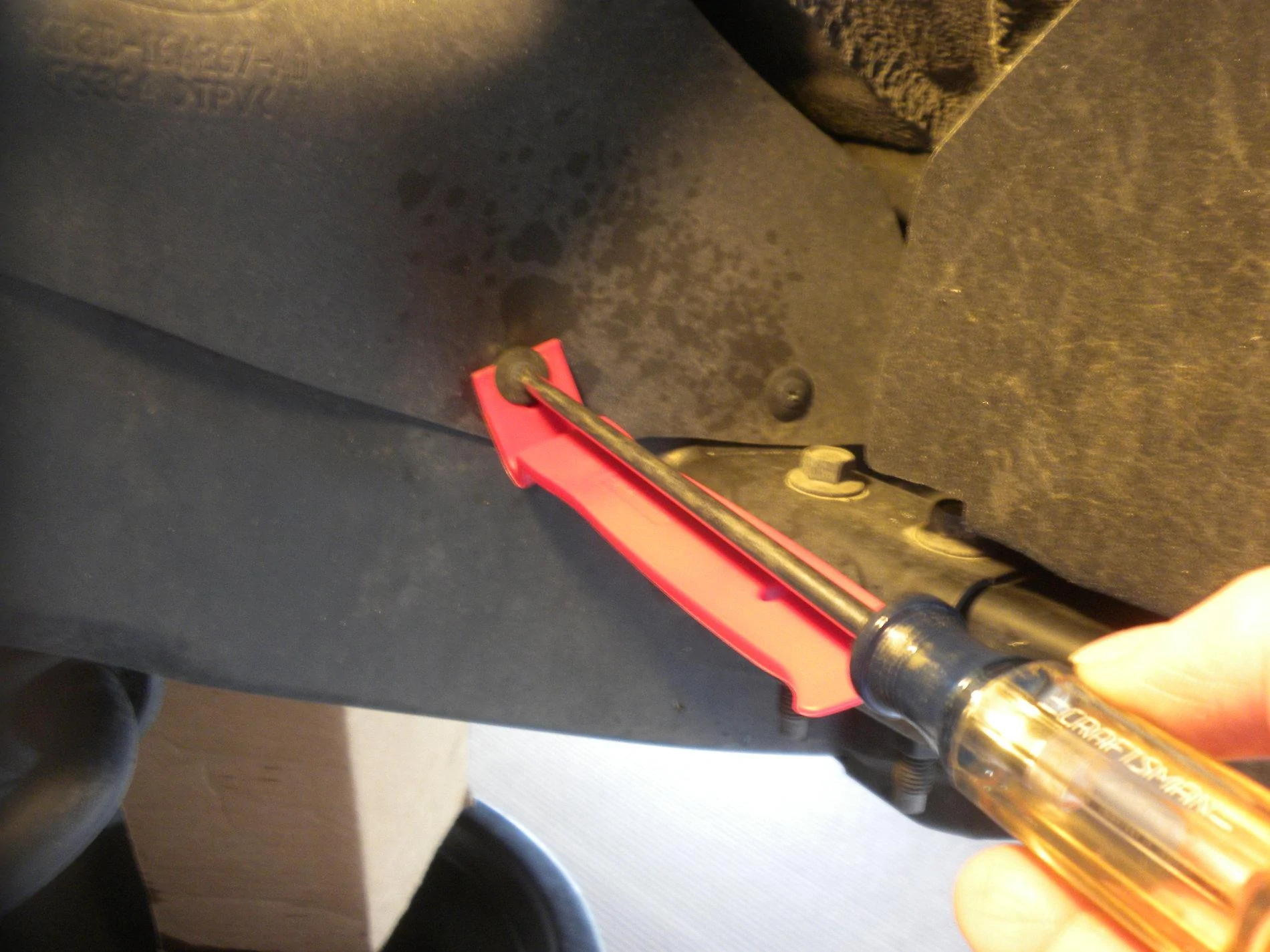

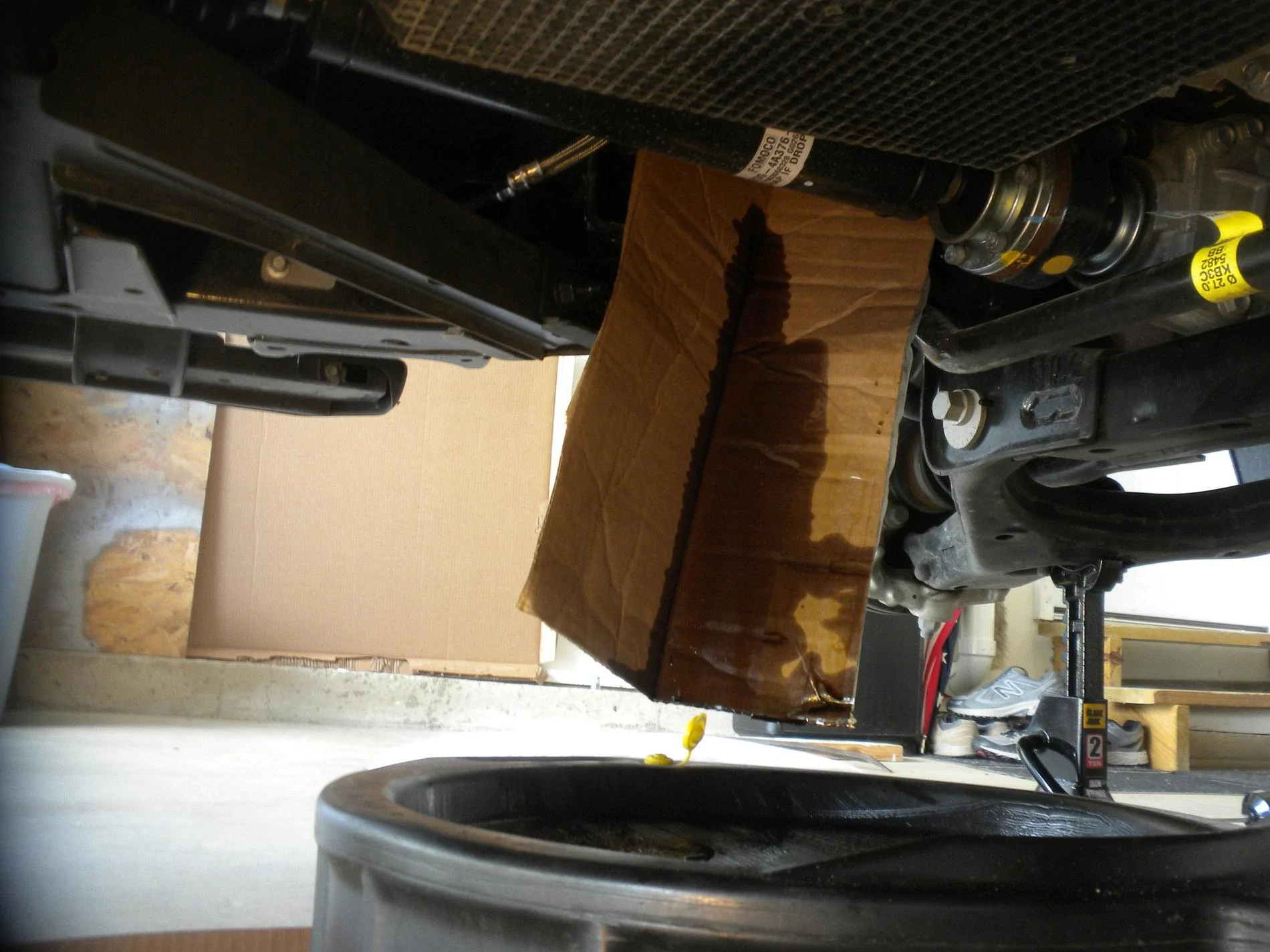

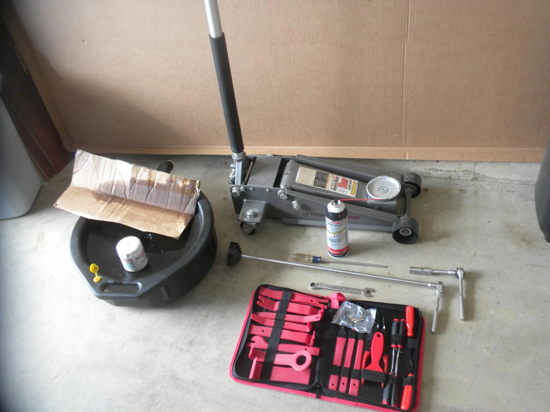

Finally did my first oil change today at 20,000 miles. This is the fourth for my truck had 3 free bees.
This like others here included a tire rotation, so my process was to support the front on jack stands, remove skid plate, remove drain plug let oil drain. Did right side tire rotation, removed left front tire. Installed drain plug hand tight. Repositioned drain pan under filter funnel, removed plastic rivets to move rubber shield, loosened filter to drain. Had lunch. Removed filter installed new, cleaned filter trough with brake cleaner. Removed drain plug let residue drain & reinstalled plug. Installed oil, ran checked for leaks. None present. Reinstalled rubber shield, did left side tire rotation, reinstalled skid plate. Checked oil level. Using my oil drain deflector I had not one drop of oil anywhere. The only place I used brake clean was the filter trough. Using the proper tools for the plastic pins I do not see where these will have to be replaced. I use the pry & screw procedure. Photos of tools used, the card board in the back ground was under the truck during the oil change, not a drop. I give this procedure a 2 thumbs up.
