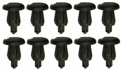

Basically just saying its kind of tight and those clips suck. I replaced mine with easier ones.
What clips did you replace them with?

Like this. Mazda uses these in a myriad of places and they hold up well and are much easier to remove. Just pop a flat blade screwdriver under the middle part to pull it up and they come right out with your fingers. You can get them in different sizes on Amazon or a parts store. I already had some laying around, so I used those.
The ones on our truck just do not work they way they should and can be a pain.

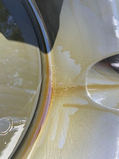

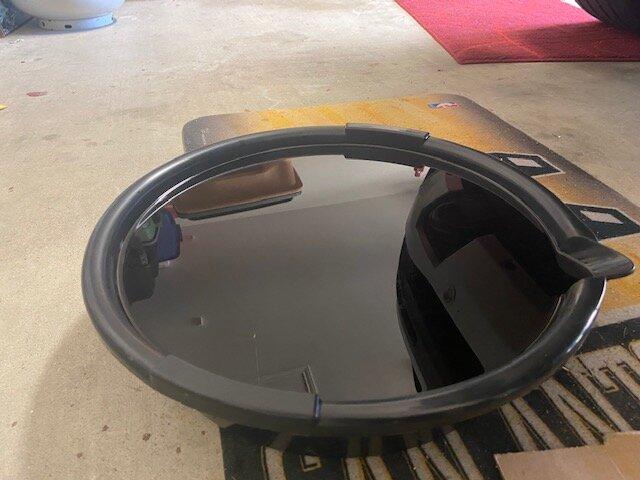

Hi. Completed my first oil change at 8,400 miles on my '19 Ranger. Yes, I know I procrastinated and regret it. Here are the things I noticed.
1. Oil was pitch black
2. Was able to drain right at 6.9-7 quarts from oil pan through drain plug. Used brand new 7qt oil drain pan from Walmart and let it drip for 15 mins (See attachment).
3. The most alarming was all the metal shavings left in drain pan after used oil was funneled back into empty Eneos 5w-30 qt bottles (See attachment).
Sending off oil to blackstone for analysis. Will post back when I have my results. Next oil change interval will be 5k miles. Fingers crossed no more shavings will be present.

Some metal shavings are normal at the first oil change. 6.2 quarts is the oil capacity. Did it smell of fuel?
I just smelt the used oil. Extreme fuel odor across every used quart of oil. BTW, my truck had its fuel pump swapped out a couple weeks ago due to code P0460. Truck sat a 1.5 months waiting for replacement fuel pump and sender (the one in the tank).
I only put in 6qts of oil back in and currently the dip stick reads full.

Did you happen to check your dipstick frequently enough to notice when your truck made the extra oil? Was it before or after the swapped out fuel pump? How many miles since the new fuel pump was put in?
And any update on the Blackstone report?
