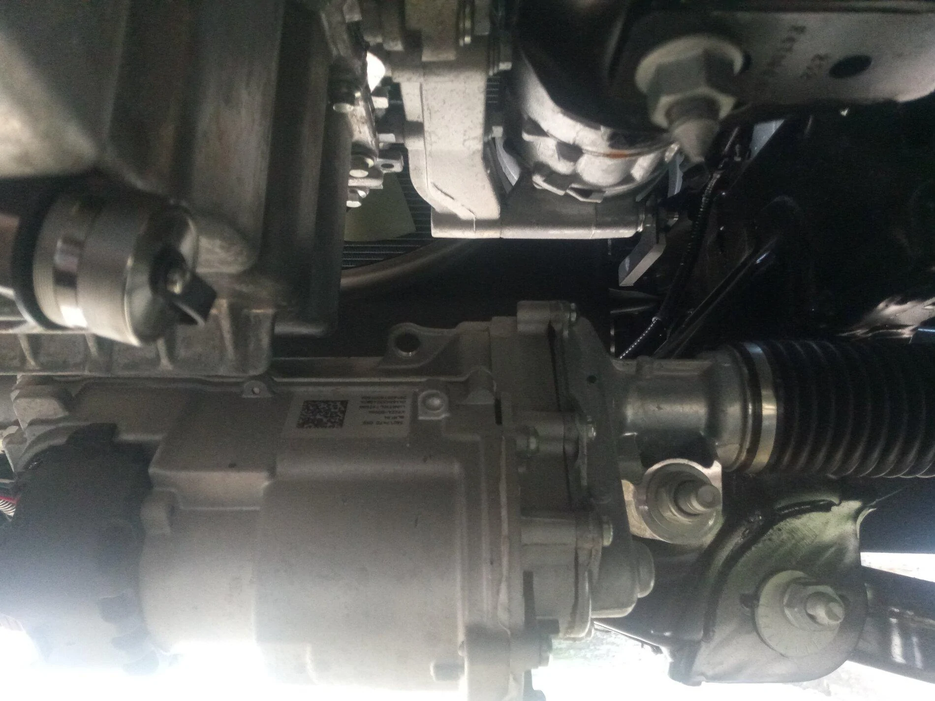

I managed to not make a mess of things, I put a piece of cardboard up as a deflector to prevent the oil from overshooting the drain pan, but I won't have to worry about that next time since I installed the ValvoMax valve. Did you reuse the rubber washer on yours, or just the metal washer? Instructions didn't mention reusing the rubber washer so I just used the metal one. Guess I'll find out if that works as soon as I add oil. I did notice that it seems like there was a blue seal in place also, so perhaps that and the supplied metal washer are all it needs.

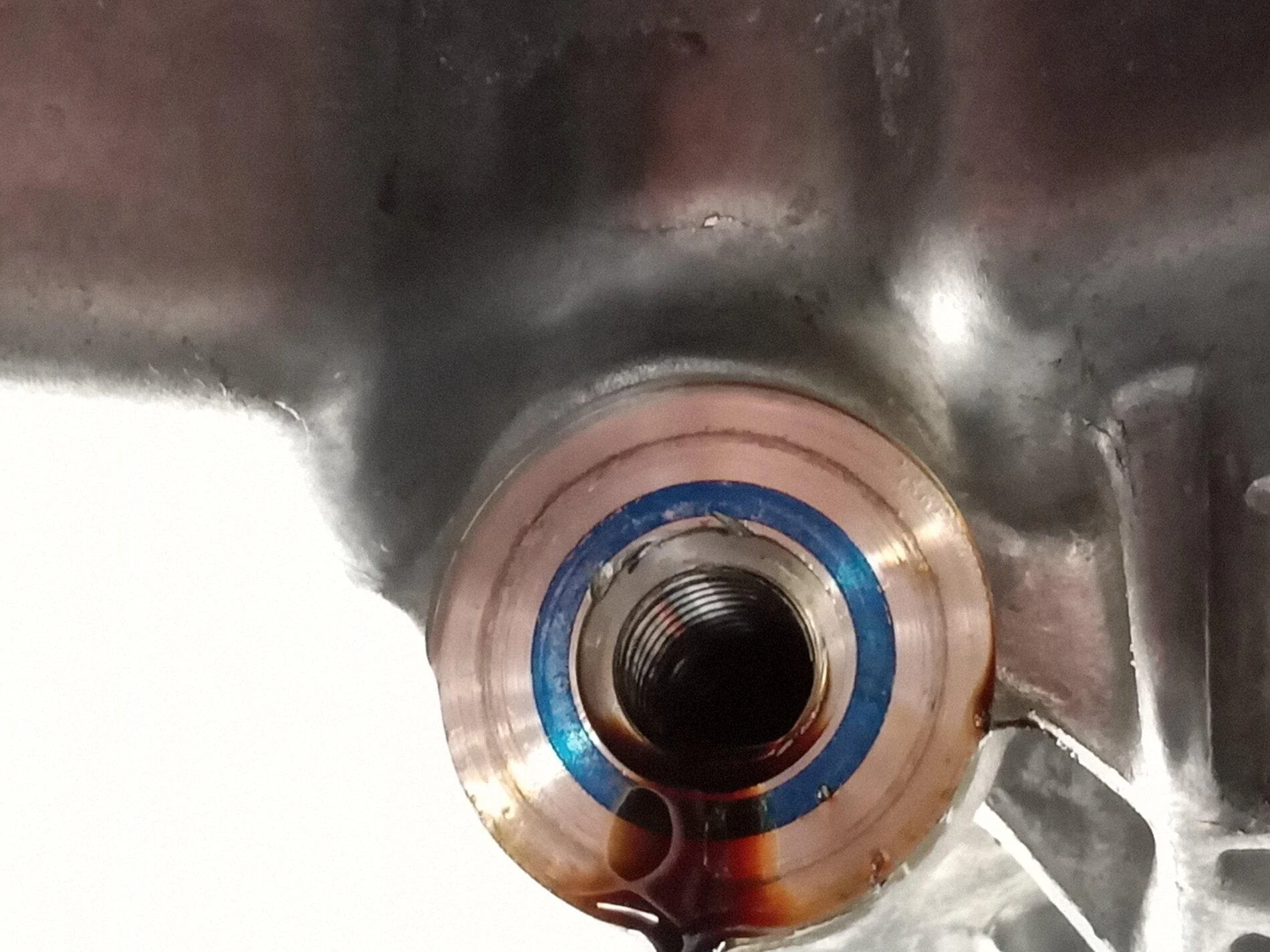

This is the blue area that looks like it's part of a steel insert for threads into the aluminum pan? Hopefully those indents on the edge won't hurt anything or I'll have to find out why they are there since they were there when I removed the oil pan bolt.

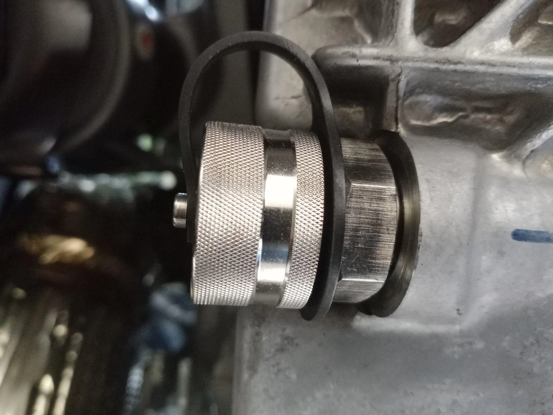

ValvoMax installed. Just loosen the end cap by hand, insert the tube that opens the valve, and aim the tube where you want the used oil to go.
No worries about the ValvoMax getting damaged from road debris. Debris would have to take out a bunch of other parts and the anti-roll bar before it gets high enough to hit the oil pan.
Is that a rubber washer under the valve? I would NOT do that. Aluminum or copper crush washer.
No, the dark area to the right of the 24mm nut is just a shaded area where there's a gap between the oil pan and the 24mm nut due to the spacing of the solid washer supplied with the valve.
Without getting up close, does looks like a rubber washer.
Optical illusion !

Good. Just trying to keep you out of trouble. I like the drain.
