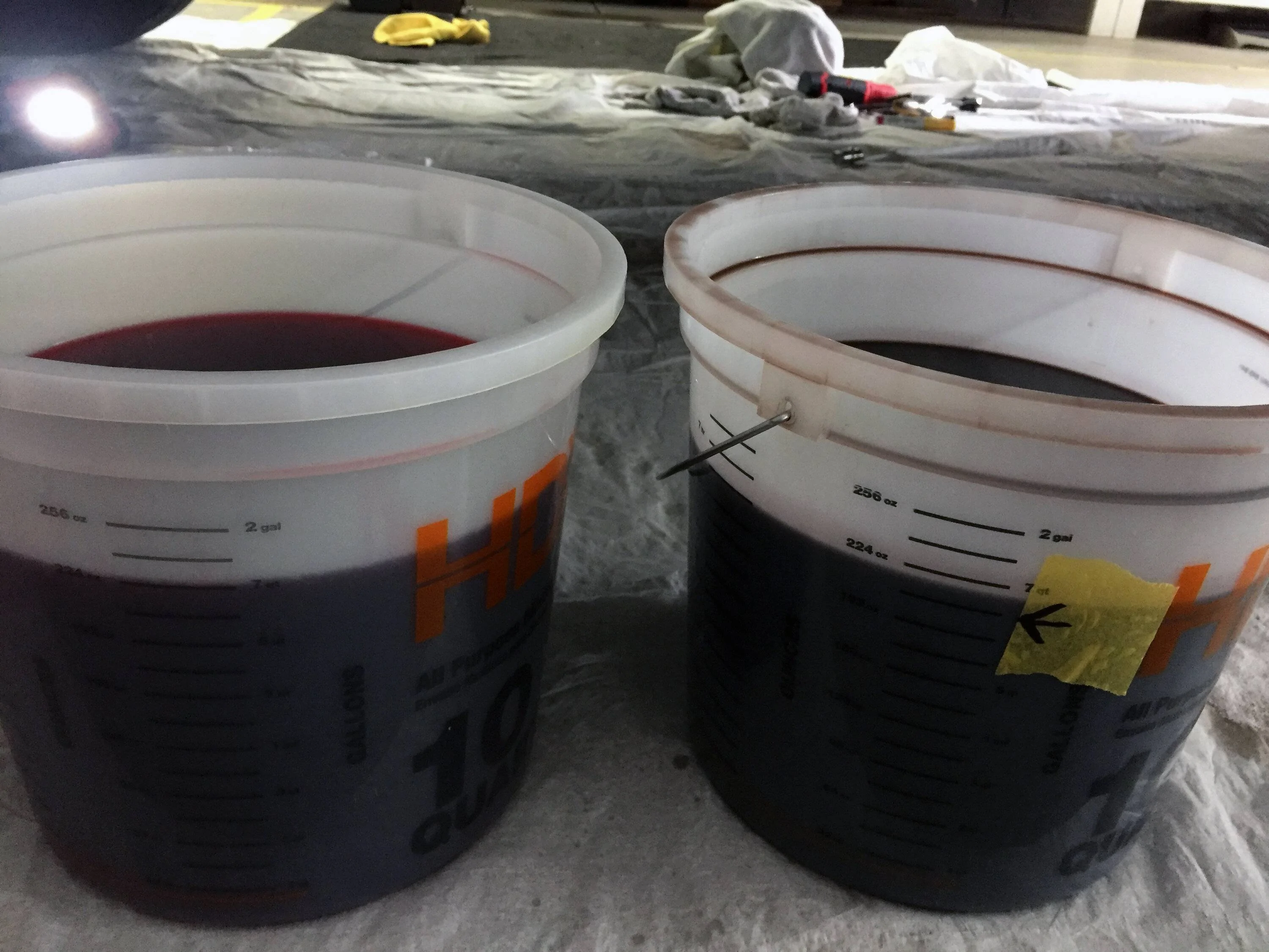

Sid...when all was finished, what was the total amount of trans fluid that you removed by the pump and dropped pan ?

Your 2010 probably uses a traditional 4 speed slush box as opposed to this finicky 10 speed...I drive very gently too and guess what? At 93K the fluid was dirty...near black, tranny started shifting erratically...sometimes shifting hard, other times smooth...after my first 6.5 quart fluid change only, things improved but not to how it was prior...now that I've exchanged 7 quarts + new filter, things are way better..for less than $100 for the two changes, I'll do it again no problem...it's not as daunting as I thought now that I've learned to extract the fluid before removing the sump...
@Grumpaw Everything I extracted plus all that I can get from the drip pan came to roughly 6.75 quarts...I made it 7 even accounting for the small amount that can't be scraped off from the pans/bucket...a cold running level check confirmed it's correct at 6 mark...adjusted for full temp should be right on at 5...
