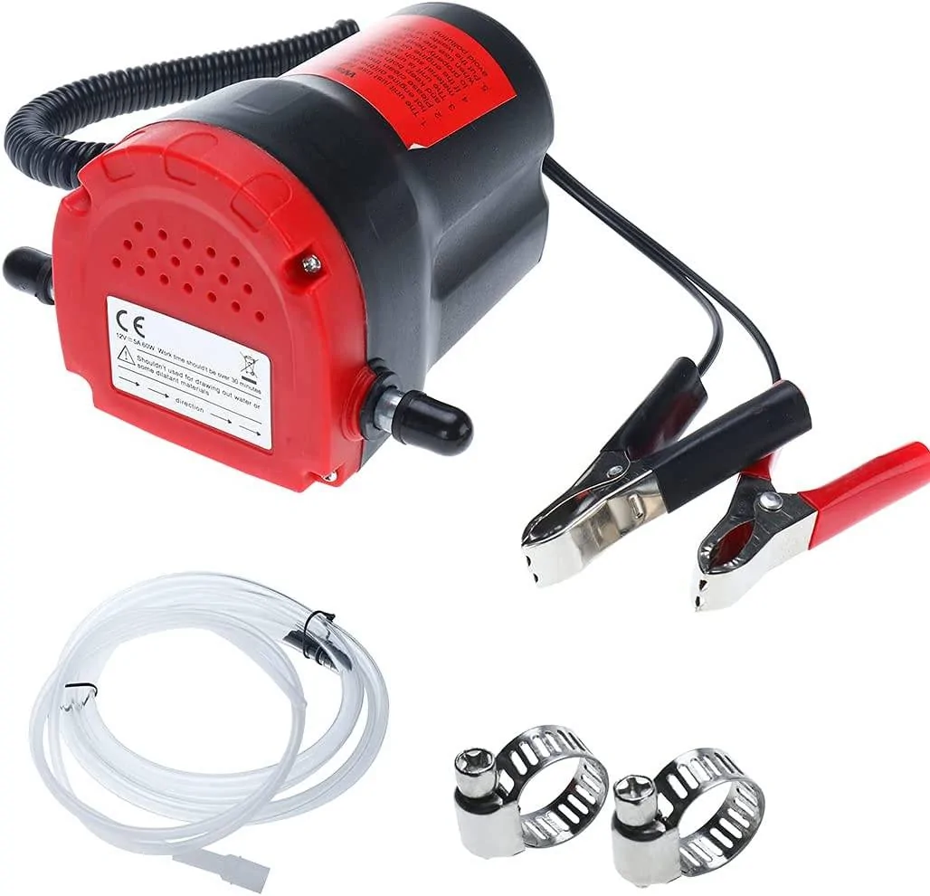

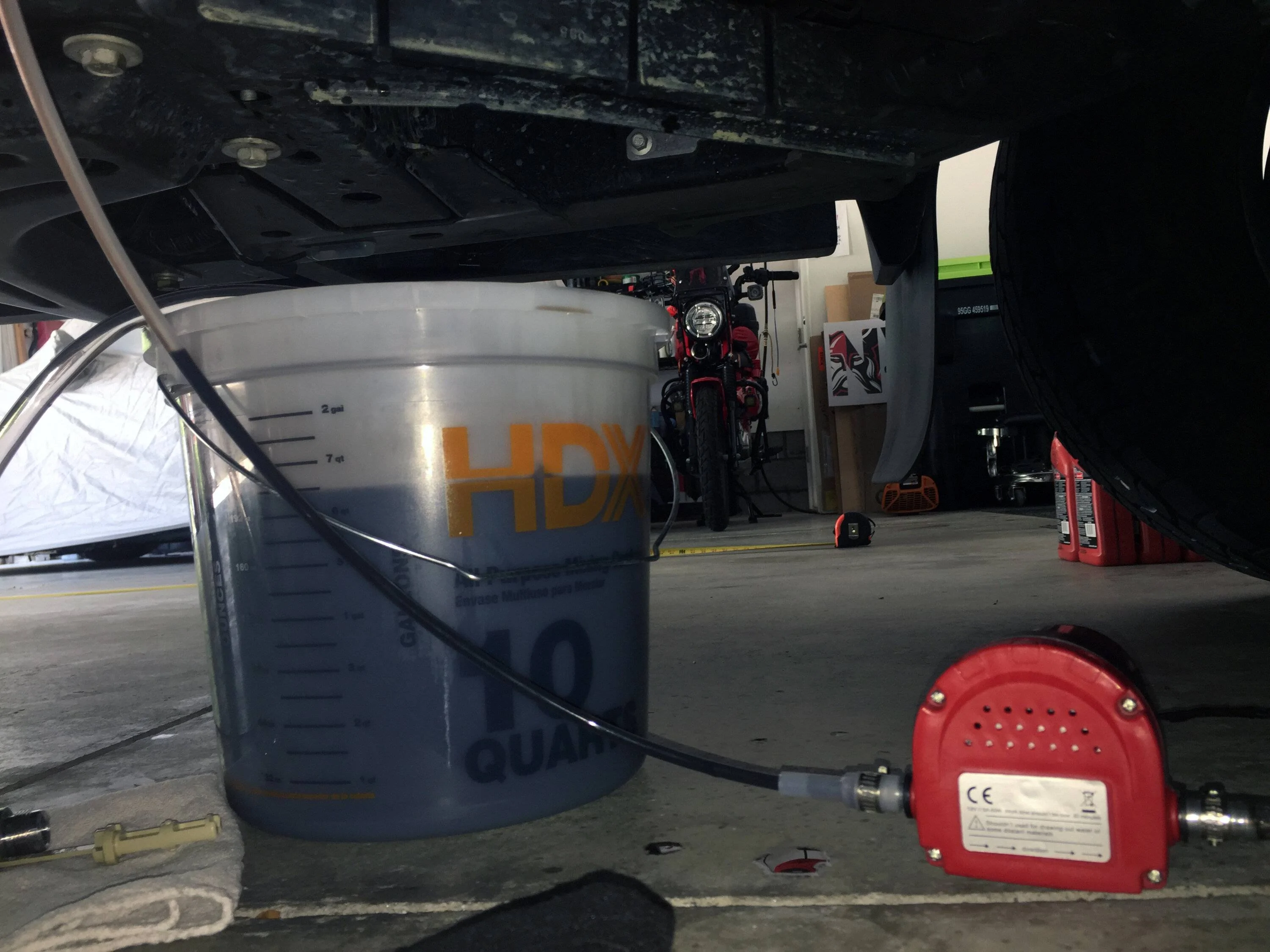

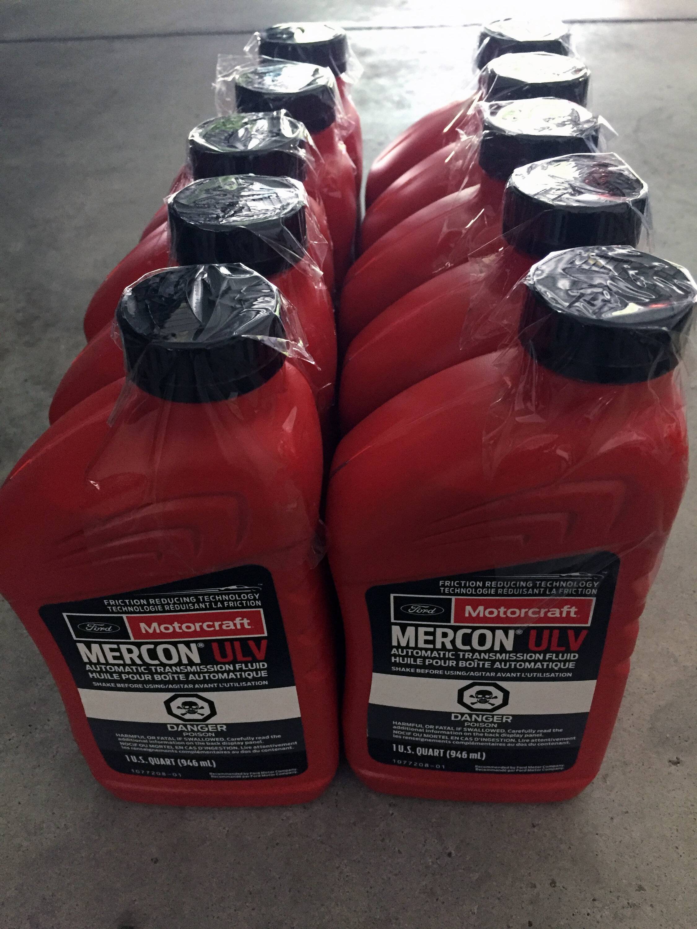

I did a partial fluid exchange by pumping out what is in the sump which came out to exactly 6.5 quarts...pumped back in the exact same amount of fresh Mercon ULV...I'm at 93K and this should tie me over till the 150K mark when I will repeat the same process...EXCEPT...once the sump is empty, I'll remove it to replace the filter...this precludes any fluid disasters lol...this second exchange should further clean up the fluid for an extended period...10 quarts costed me $65 so I can do this again at 200K...the oil pump extractor is the best $25 I've spent for this job...I modded it by extending the battery cable to 8' so I can reach the transmission...

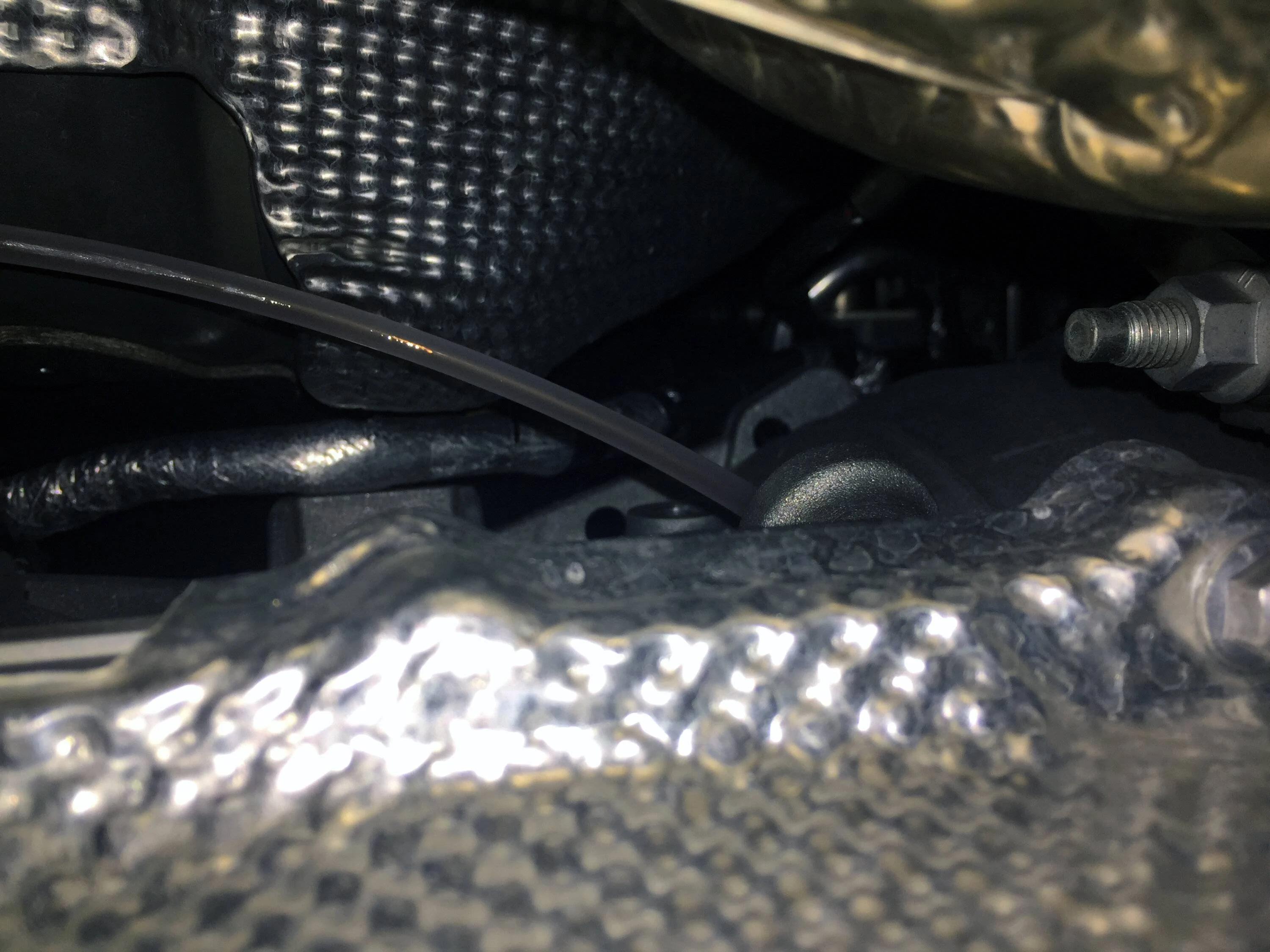

Extraction tube going into the dipstick/fill hole, taped in place so it wouldn't accidentally come out while pumping...

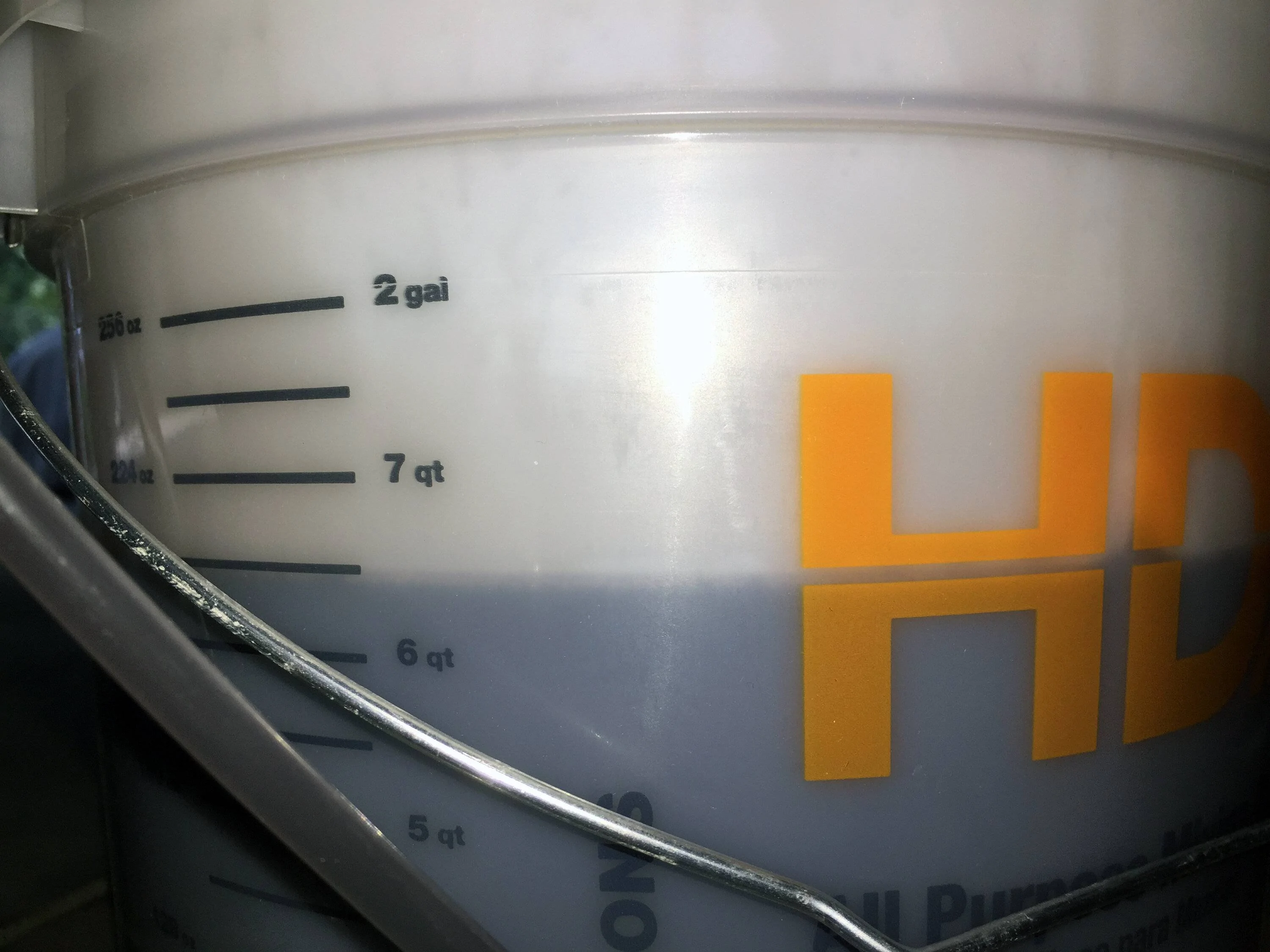

Exactly 6.5 quarts...
Nice find on the pump!
As far as the fluid level, cold running mine didn't even register on the stick but was right on 5 by the 190ish degree temp. By replacing same amount as you removed, you should be good.

I decided not to wait...after the first 6.5 quart exchange, the fluid was still pretty dark...can't imagine what the filter looks like...I had 5 quarts left over from the last change so I ordered another 5 plus a new filter...total for that was $70 shipped...dealers wants nearly $500 for this job...

Hi Sid,
Do you have a link to this extraction pump?
