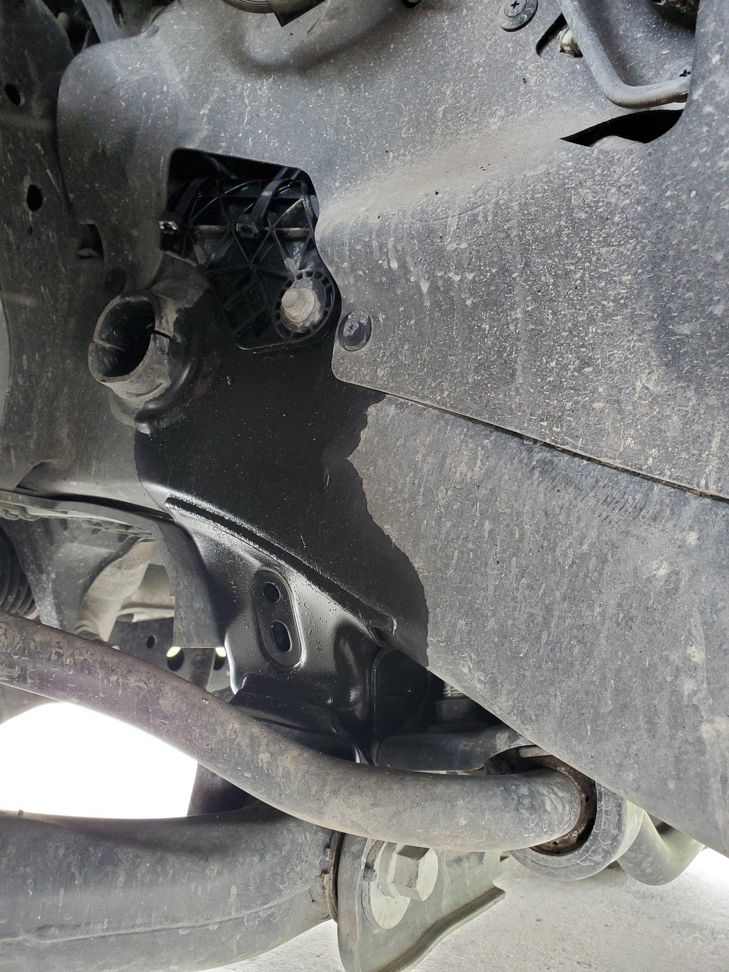

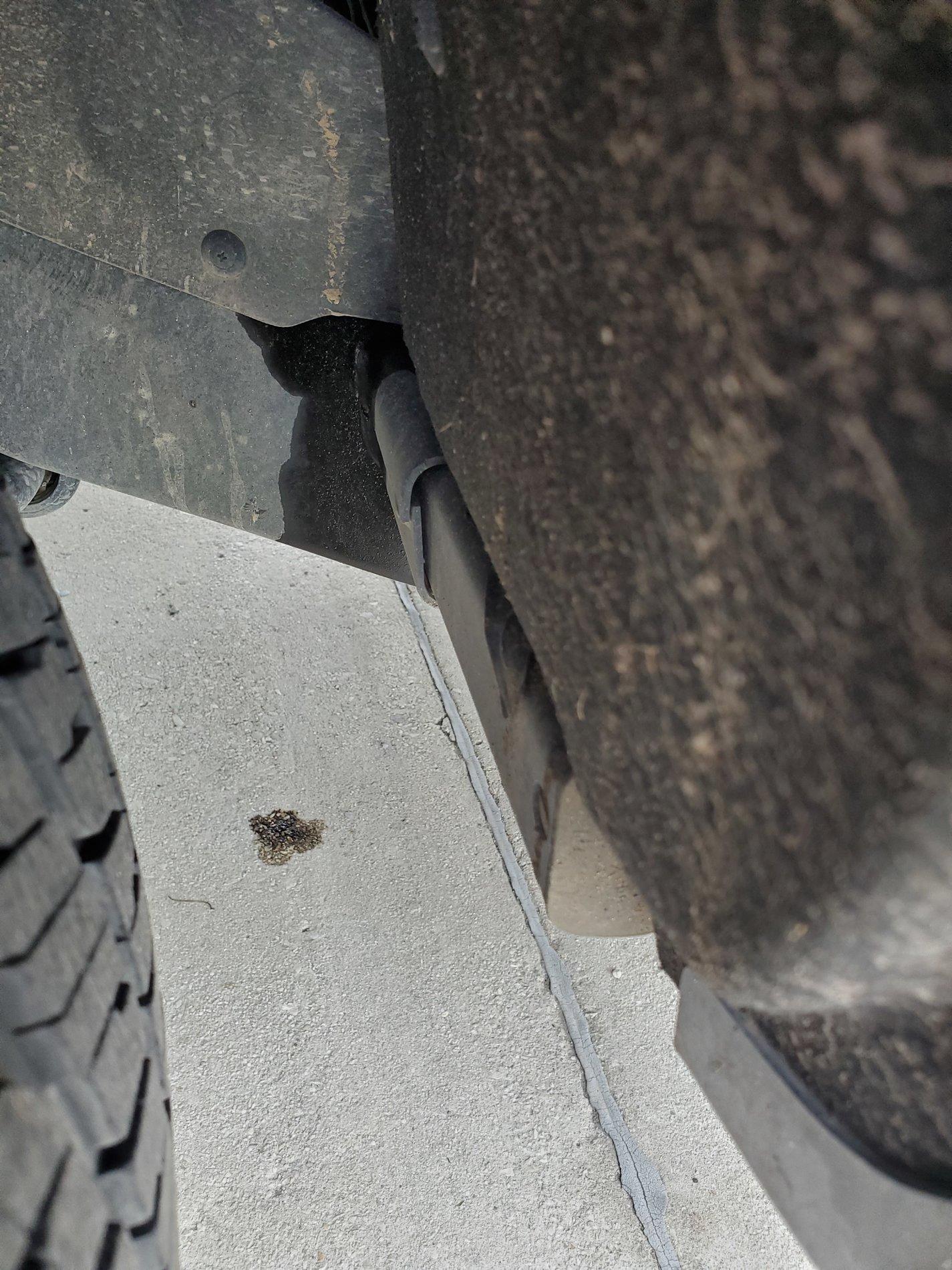

2nd oil change at the dealer and this... :/
Anthony
Anthony
Feb 6, 2019
692
1,302
Connecticut
COO
Ugh that sucks. I've had too many misadventures with Ford Service departments to let them near my truck unless it is something out of my hands. Pretty much any maintenance is being done in my garage so I can mess it up, not them. ?
