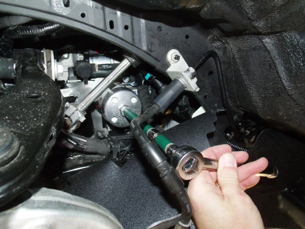

Body clips, haha, you just unscrew the center with a phillips, pull out the screw jam screw and they come out by them selves. did my 1st change Saturday at 2k miles, piece of cake. Jack the truck up slightly under the frame with my H/F Quick jack and a piece of 4x4 for lift, A jackstand for safety- Yes i do use it! put a rag on my filter cup removal tool, easy peasy. Tighten 3/4 turn with the help of said rag on the cup tool and a series of extensions. done in 20 mins.

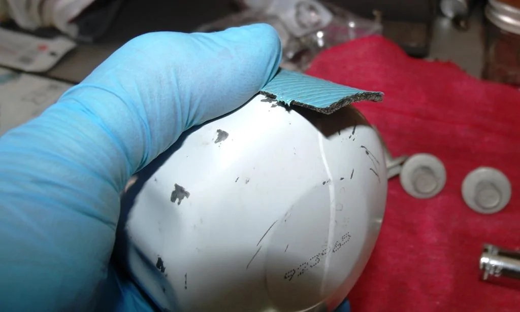

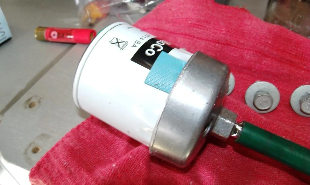

Long story shortened up a bit is the factory filter is different size than the replacement FL910S (why is this?). I tried repeatedly and it fit the 910S nice and snug but was too big for the factory installed filter???
I had that issue and here's the fix.. First Oil Change

I say attempted because I never did get the filter off so I ended up just draining the oil and put in new oil. I got access to the oil filter just fine by taking off the trim piece you all posted about. But that filter was royal b!@#$ and I couldn't break it loose. I even went to the local auto parts place and got one of those rachet style filter getter offer things that goes on the end of the filter. I tested for fitment while at the auto parts store to make sure I got the right size matched to a FL910S filter. Brought it home put it on the factory filter and it just spun/too big (wtf). Long story shortened up a bit is the factory filter is different size than the replacement FL910S (why is this?). I tried repeatedly and it fit the 910S nice and snug but was too big for the factory installed filter??? So after much profanity and I didn't have channel locks big enough I decided to call it a day and buttoned it back up. I will have to be content with a job half done. I've ready many posts on here about how easy it is to get this filter off and that they're only on hand tight...…..BS! Or i'm the unluckiest bastard in the world.
To the dealer it goes for the next one.
