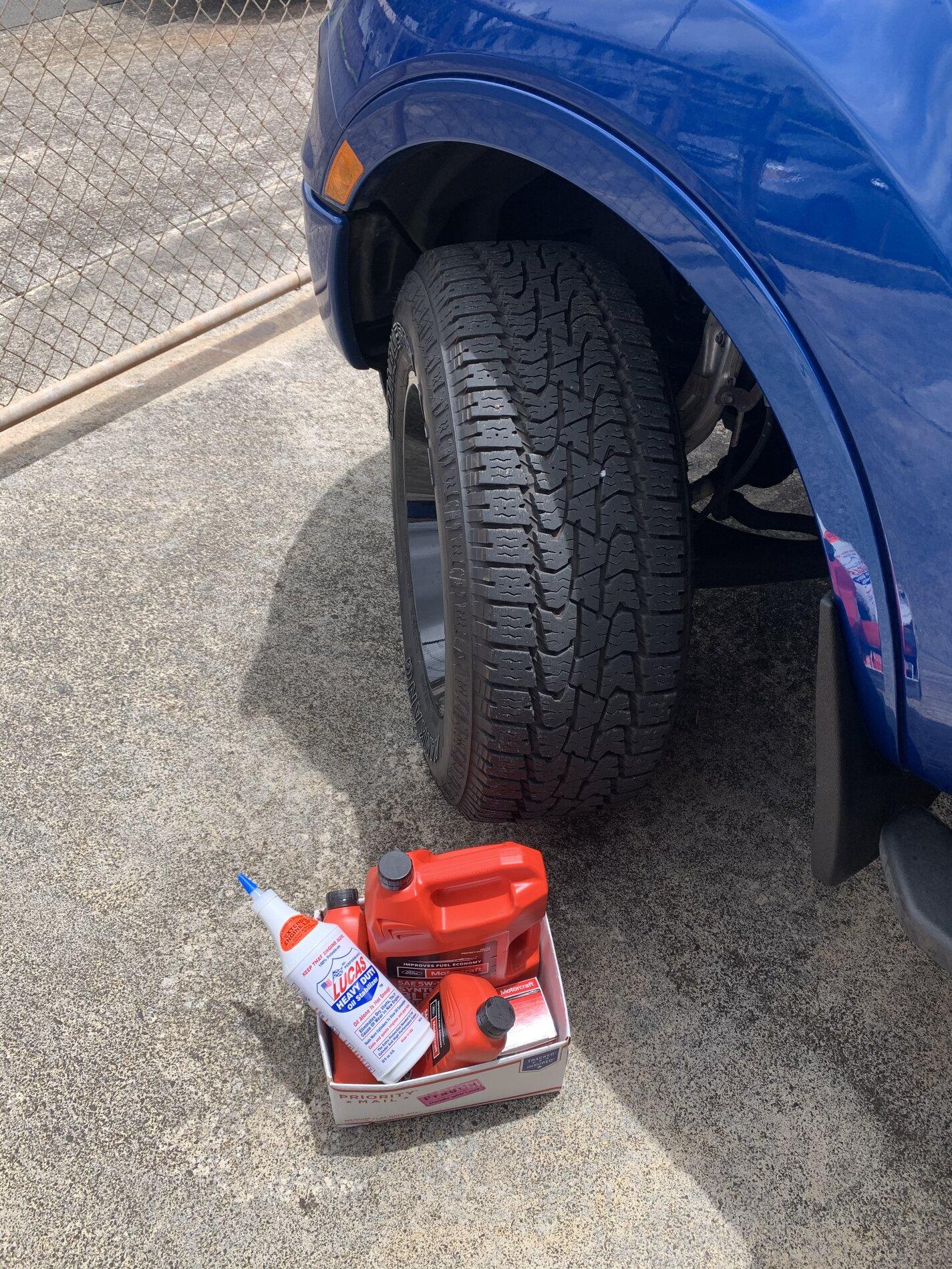

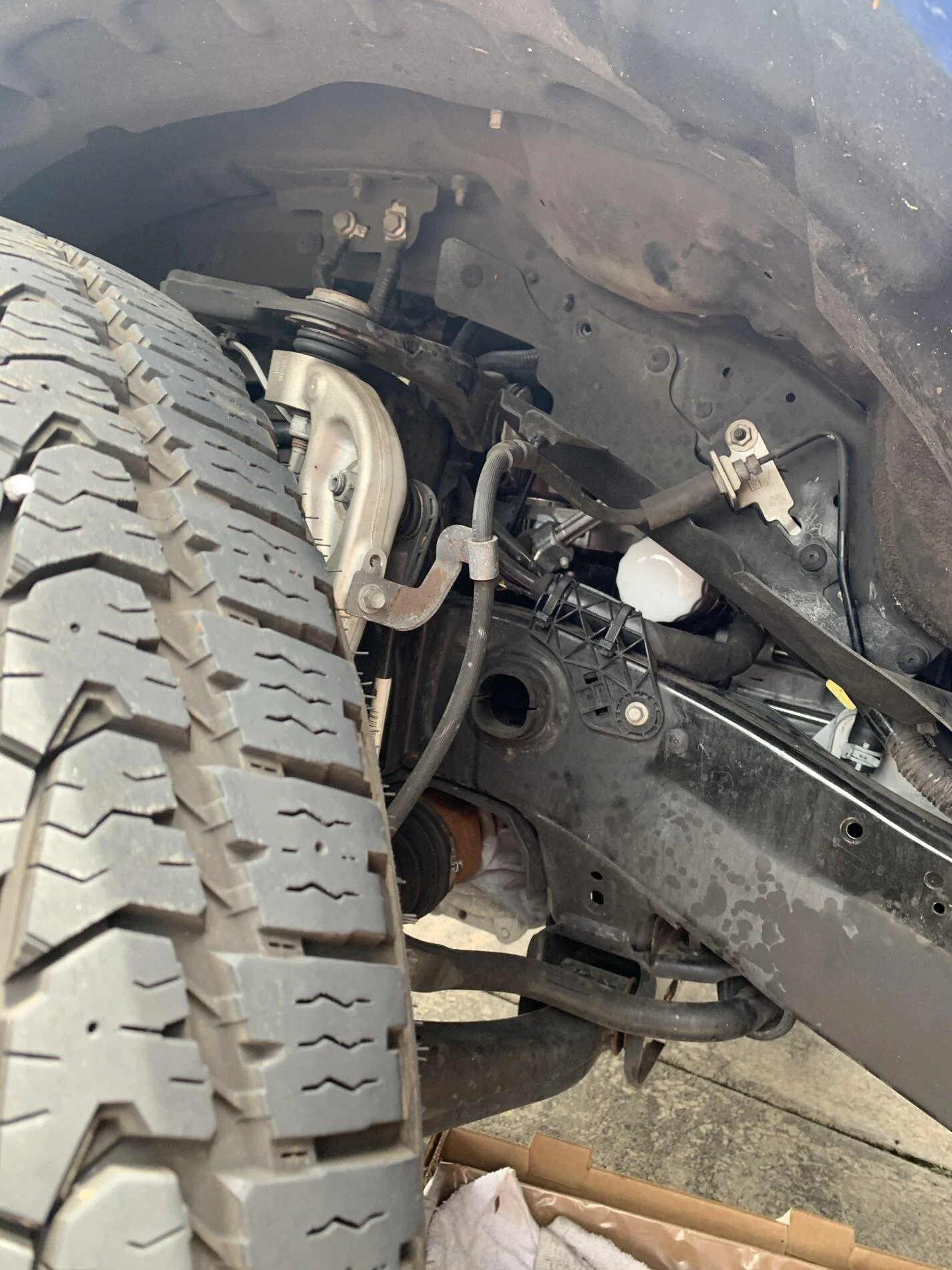

Easier then most modern vehicles. All said and done 20 minutes and a ratchet with a 15 mm socket was all I needed besides the 5.2 gallons of motor craft 5w 30 syn blend, 1 gallon of Lucas oil treatment and the motor craft oil filter.
This is my second oil change. I beat on my Ranger daily but at 15k miles I lost no oil in between changes and no gasoline smell at all. 2019 4x4 Lariat. Heavy mods and hard driving. Love my truck.?

I hope you didn't put 5.2 gallons in, and I also hope you didn't put 5.2 quarts in. The proper fill with the FL910 filter is 6.2 quarts :)
