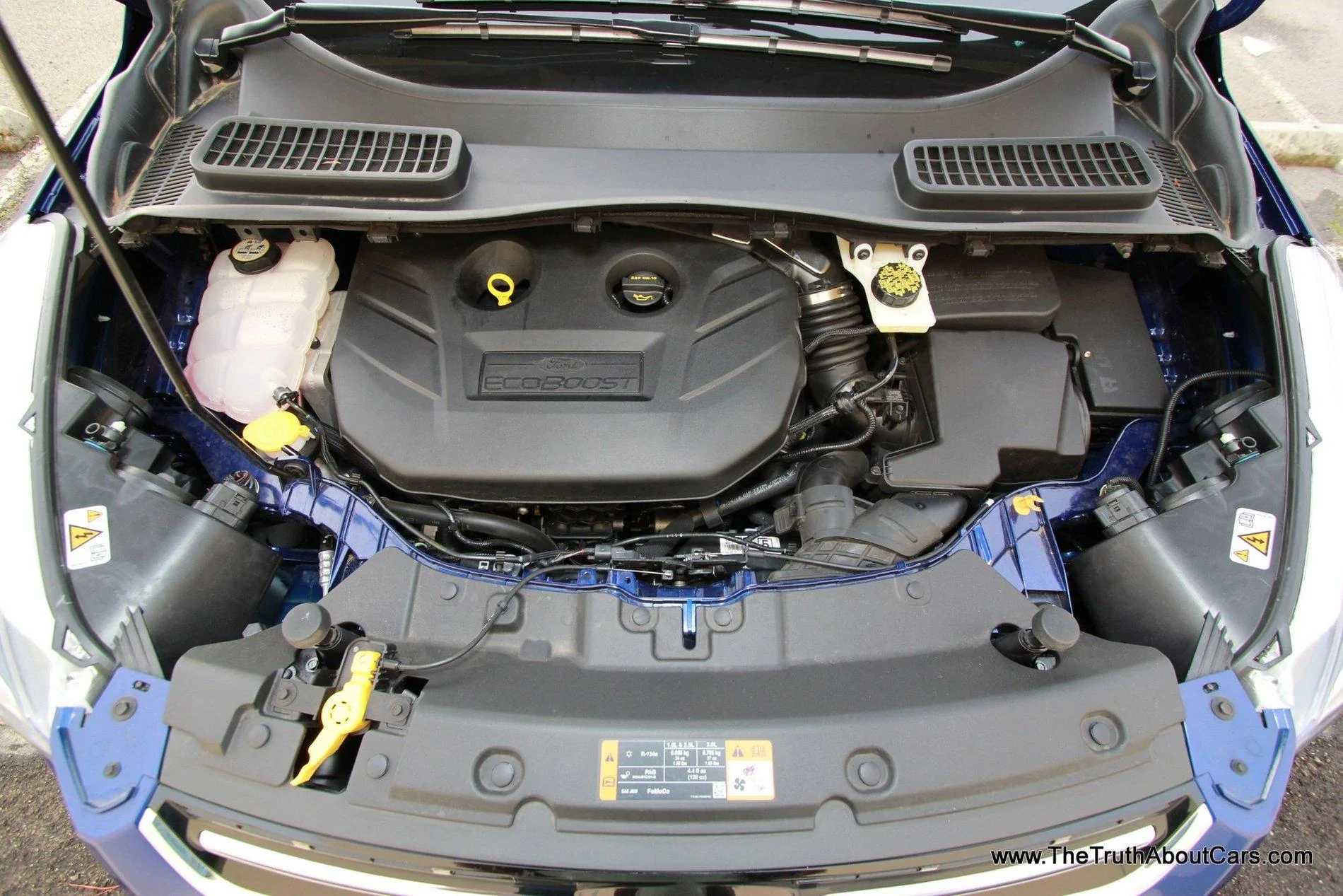

I give engineers a lot of slack; even when things get frustrating there's usually a reason behind it. And yes, sharing an engine between multiple models/platforms is a valid reason that causes some problems.
But this one is totally unforgivable. Every time I open the hood of my 14 Escape I just want to smack somebody.
The coolant fill cap is under the cowl. No amount of funnel wrangling at angles is enough to get it in there. BUT DO YOU SEE THE OTHER 75% OF THE EXPANSION TANK THAT IS NOT UNDER THE COWL?????
sheesh

That part needs to be redesigned - at least for the Escape. I think they should make the engineers actually work on the cars after they design them. It would reduce issues like this.

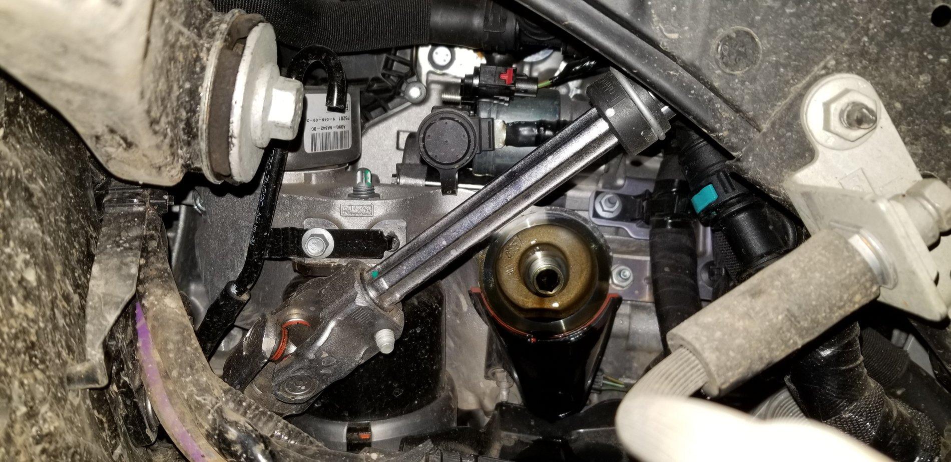

My wife's C-Max needed an oil change and so I decided to do my first oil change on the Ranger today (a bit early - I have about 8100 miles on it and the oil iife monitor said 24% remaining). I figured changing it a bit early on the first change wasn't a bad thing. I had intended on getting the Fumoto valve but since I hadn't ordered it yet, I obviously wasn't able to install it. I'm on the fence whether or not I will eventually get it or not. It really wasn't NEARLY as bad as I thought it would be. The skid plate is REALLY easy to remove - 4 bolts. It is WAY easier than removing the "airflow pan" (I'm not sure what to call it) under my wife's C-Max. That has 8 torx bolts that need to be removed to get it off - the 4 bolts for the skid plate are a piece of cake compared to that. I may forego buying the Fumoto valve since taking that skid plate off is so easy.
The other piece that concerned me was the oil filter - again, that was a piece of cake. I turned the wheels all the way to the right (passenger side) and then removed 4 very simple plastic "bolts" and folded down the flap. Stuck an oil filter end cap on the filter with an extension and it came right off. The really cool thing was the little tray under the filter than caught all the oil and routed it away from everything - although I didn't know where it drained to at first and got a puddle of oil on my garage floor. Here is where the filter screws on and you can see the funnel/tray under it:
It really was very easy to get to - you DEFINITELY do not need to remove the wheel to get to it.

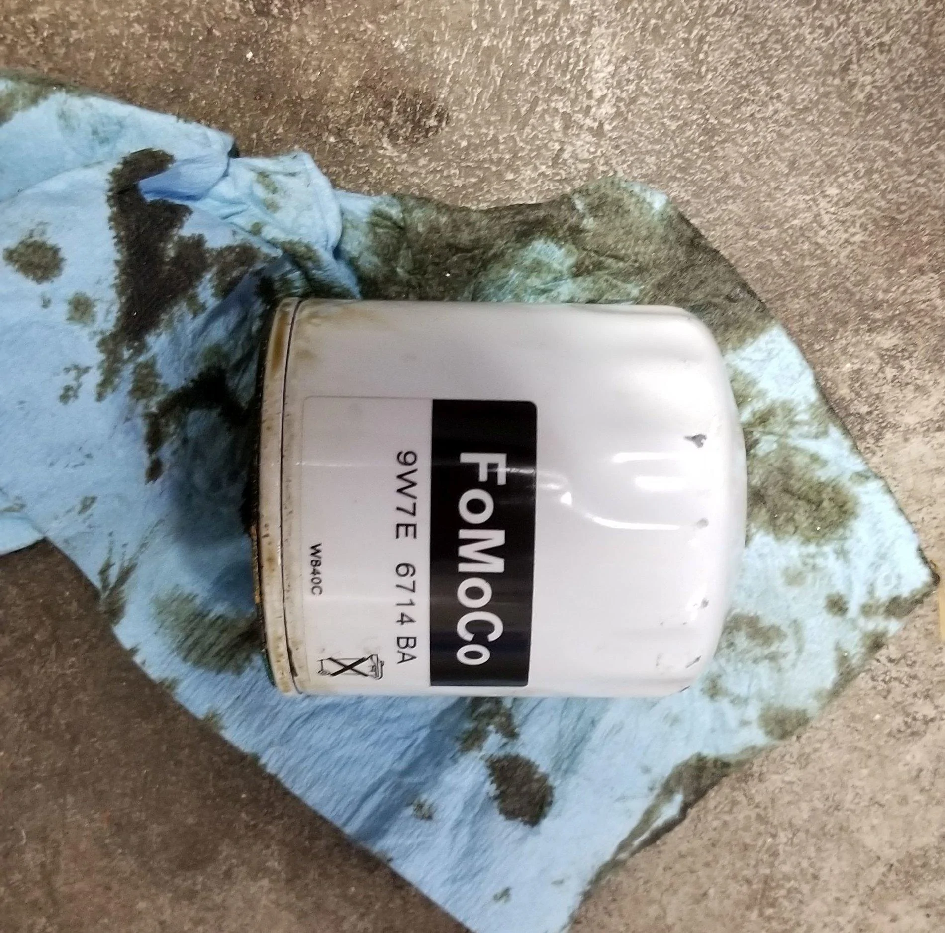

Next was my original FoMoCo original filter (surprised it wasn't a Motorcraft filter):
The oil change was actually pretty easy - a lot easier than I was expecting. I did end up rotating my tires, and I think that took longer than the oil change did. I ended up putting just shy of 6 quarts of oil in it - more than the 5.7 that the owners manual states. This engine isn't big, but it takes a LOT of oil! It almost overflowed my oil pan!
Anyway, if anyone is contemplating doing this, don't worry - all the "issues" that have been brought up have been blown way out of proportion I think. This was a pretty easy oil change I think.

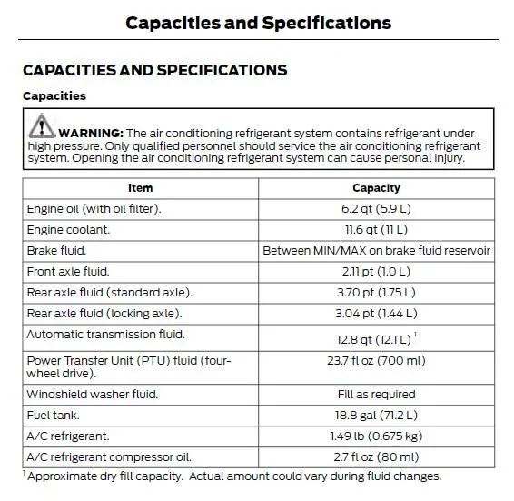

Thanks for the detailed information on your oil change.
FWIW: Current manuals state "6.2 Quarts"
RedlandRanger
Nov 14, 2018
35
4,592
8,826
Interesting. It does take a lot of oil for a small engine. 6.2 Seems more accurate to me.

It states 6.2L. And after I filled mine w/ filter it just took 6L and it lined up at the half way mark on the dip stick. I always let it drain for 30 minutes to get as much of the old stuff out as possible.
RedlandRanger
Nov 14, 2018
35
4,592
8,826
Liters? Or quarts? The updated manual says 6.2 quarts which is 5.9 liters. If you let it drain that long, I could see 6 full quarts being about right - there will always be a little left in the engine.
