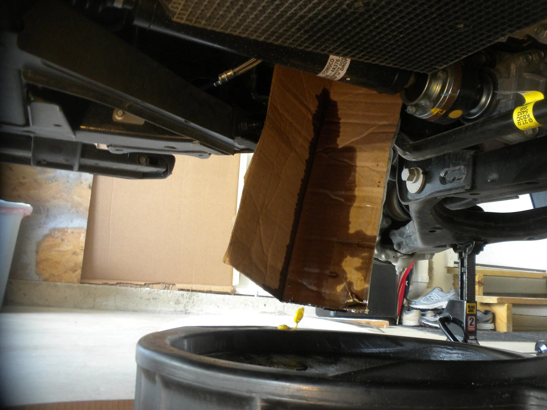

The most difficult part of changing your own oil is lining up the drain pan for when you remove the oil filter! I am slowly re-sealing my driveway with an oil coating!
You can do what I do which I have stated in a previous post. Use my no spill oil deflector. I have never missed the drain pan when removing the drain plug or removing the oil filter. I have yet to get a drop on my garage floor. :thumbsup: :clap:
I rolled up and placed paper towels in the channel for the oil filter to catch the oil that comes out. Kept it from hitting the floor. Then I cleaned the channel out top to bottom.

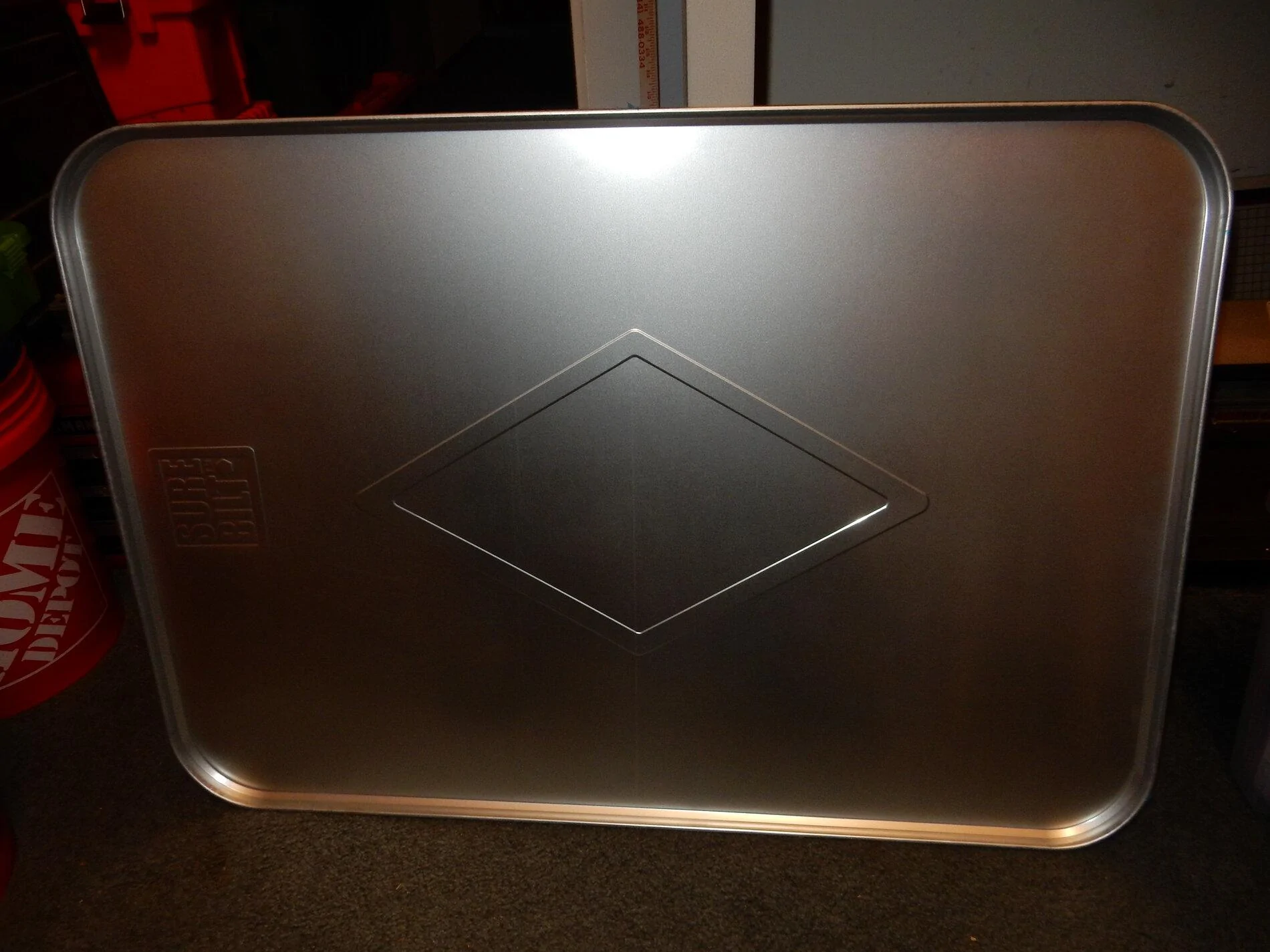

They make a huge rectangular oil pan (~ 3/4" in height) which is capable of collecting any oil spills BUT NOT 6.2 quarts of oil. It will keep your driveway or garage spotless.
(Doubles as a baking tray if you can fit it into your oven - just kidding)
Any auto parts stores will/should have them. Autozone for ~ $11 :)

Here is the image ...

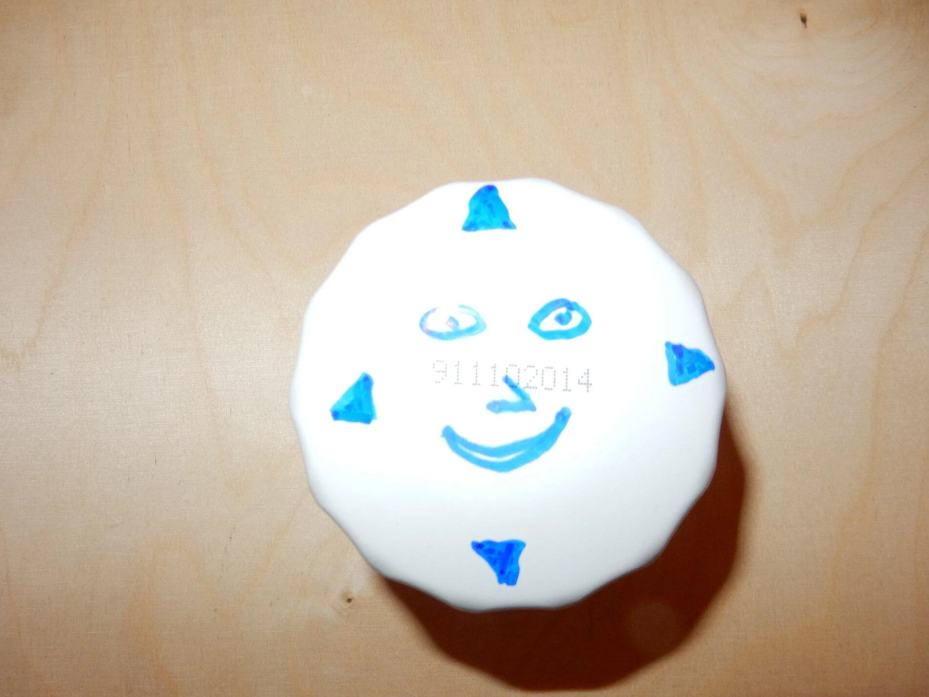

Happy face drawn on Ford oil filter with markers are at 3,6,9 and 12 o'clock.
When the "pre-oiled" filter just makes contact with "metal" - take note of the "reference
markings and happy face" and turn the oil filter CW (additional) by hand another 1/2 to 3/4 turn.
I never had an oil filter leak on my Ford Ranger! IMHO :cool:
