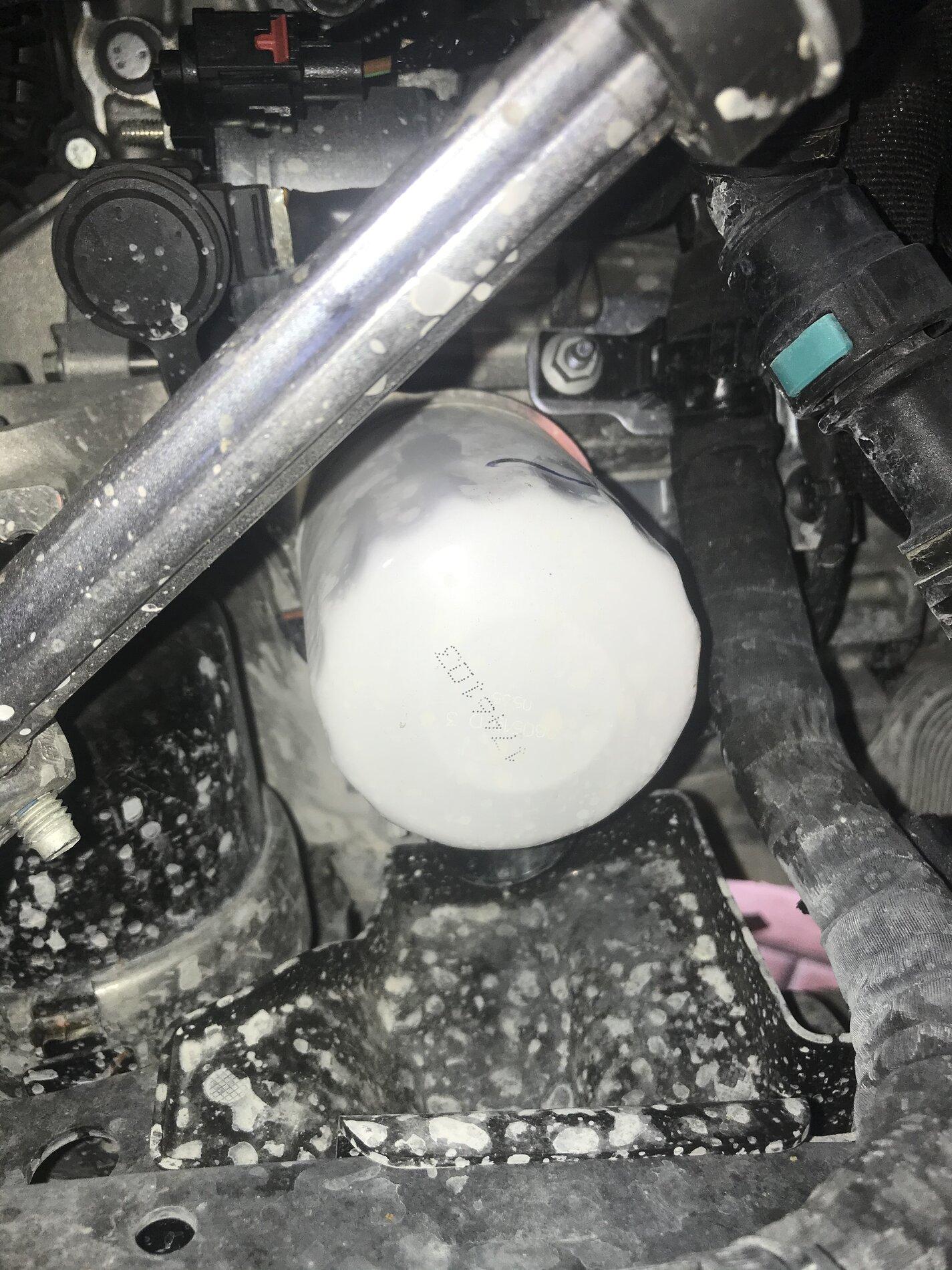

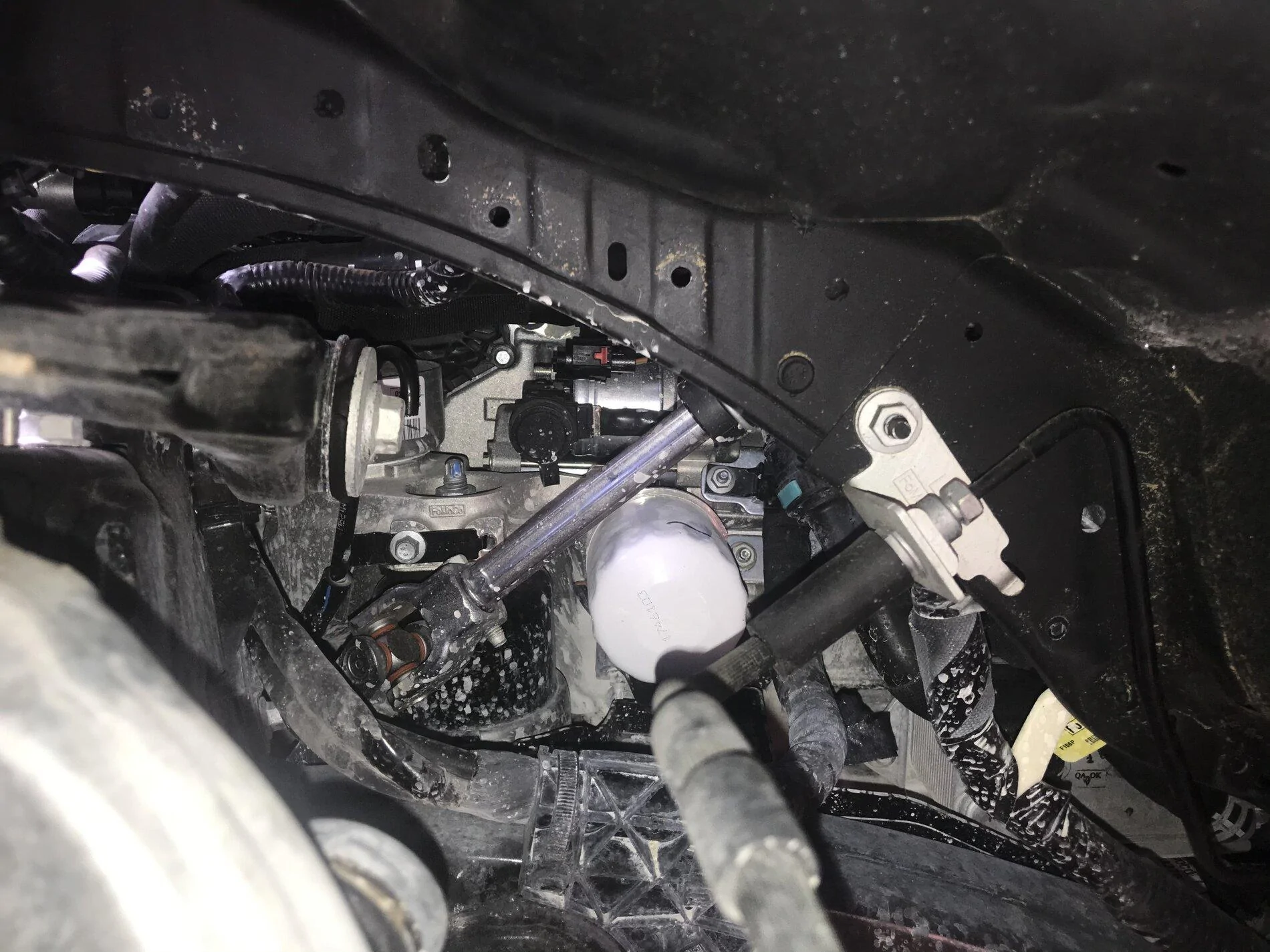

Did the first oil change on the Ranger today. Way easier than the F-150 V8. Steps are below. Thanks for all the write up guys, made things alot easier.
Oil Filter: Motor craft FL-400S
Oil: Motor craft SAE 5W-30, 6.2QTS
Tools:
-15mm socket and socket wrench
-Screw Driver and Interior Pin Removal Tool (optional)
-Oil Filter Wrench or like item to loosen Oil Filter
-Oil Catch Can
  1. Run the Ranger for 2 minutes to help loosen the filter.
  2. Turn Wheels towards the passenger side all the way.
  3. In driver's front wheel well, remove the 4 screws and plugs that holds the rubber protective material. This will expose the oil filter
  4. Use whatever oil filter tool to loosen the filter (I used an oil wrench)
  5. Remove engine oil cap to allow for additional air flow.
  6. Go under truck and remove the black skid plate that is just behind the sloping front end of the truck it has 4x15MM bolts.
  7. Place 1 catch pan behind the front sway bar bushing beyond the control arm.
  8. Place 1 catch pan under the oil pan bolt.
  9. Remove oil plug (15mm)
  10. Remove oil filter.
  11. Wipe both areas down with a clean rag
  12. Reinstall oil pan bolt or install your ADP-107 & 107N valve to replace (ensure the valve is closed & safety clip is installed)
  13. Install new filter; ensuring to lube the ring of the new filter with new oil.
  14. Fill engine with 5w-30 oil, 6.2 QTS
  15. Run engine, reset the Oil Monitor
  16. No leaks, reinstall skid plate and pins for wheel well protector.
  17. Record mileage in book, drive happy!

Changed my oil today. No skid plate under the oil pan. Rotated the tires, left the drivers wheel off to get to the filter easier. Used a rubber band type wrench for the oil filter. Wasn’t that hard to do, also replaced the air filter. Mobil 1, 5W-30, Motorcraft oil and air filters. 7200 miles on the truck.

The most difficult part of changing your own oil is lining up the drain pan for when you remove the oil filter! I am slowly re-sealing my driveway with an oil coating!

Cheap kitty litter is your friend

That little drain pan is so hard to judge :) I have a fumoto and a 20” piece of tube, so I just put the entire drain pan under the a arm and route the drain tube over there.
