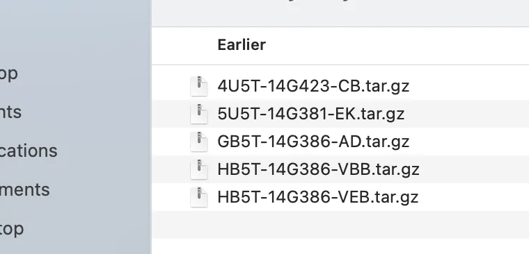

I noticed I didn’t have the ‘CM’ file as mentioned above as part of my install files, just the other 5 shown. If they are to do with the voice directions then it wouldn’t bother me as I have always muted them, but I’ll give it a try again to see if any difference.​
The -CM contains all of the data for TTS, prompts and voice commands. You don't want that to be out of sync, especially coming from something as ancient as 3.3, with the main application package. You can do what tmcolegr did and run another installer. I found a used car VIN for NA NAV that seems to pull the right files I can PM you.

Yep, if they're both Nav, they're identical. You don't need to edit it, it'll effectively skip over the file that's already there and just update what needs it.
when I updated mine yesterday everything went well but was not sure about the file. I went back in the flash drive and the CM file is missing. Not even sure how to get it now. The 5U5T-14G391-CM.tar.gz is the only file missing from the above list. Is there a way to get the missing file and install it?

1FMCU9J90LUB09229 is one example for NA NAV. Basically, if you're missing a file or files, you can look up some used vehicle VINs for MY19/20 with the same system and pull a full package that way. Annoying, but it works.

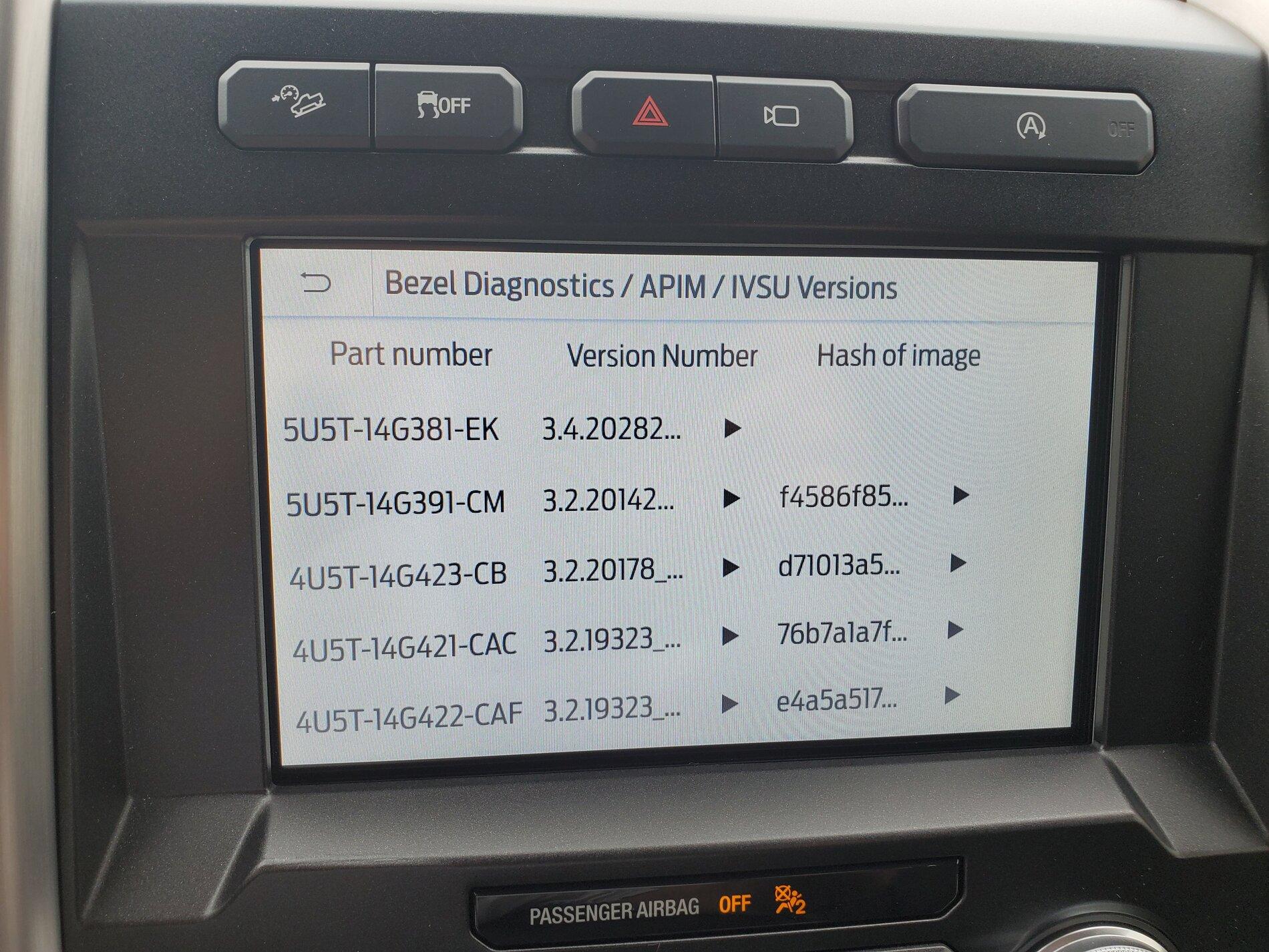

Another method is to check the IVSU files that are installed. In this case, you're looking for 5U5T-14G391-CM
For vehicles without a CD player integrated into the ACM, simultaneously press and hold the steering wheel SEEK UP and the FCIM SEEK UP buttons until the bezel diagnostics mode is entered. If supported, the Speaker Walk-Around Test begins and the display indicates each speaker as it is tested.
Once the Speaker Walk-Around Test (All Speaker Test) is complete, the following information is available:
APIM Diagnostics>IVSU Versions

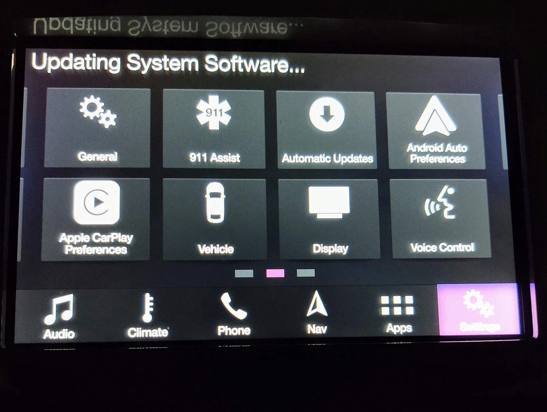

Going from Sync 3.3 v 19052 now... (via USB) @6:40PM...
While I wait just a quick note: formated new USB to NTFS, extracted the downloaded update from my PC straight to the thumb drive. Fired up the truck and plugged in the drive, went into the menu under settings and for software updates set to automatic/check now...
Message went away at 7:05, restarted truck. Message back (still showing old software under General>About SYNC.
7:10, message 'Update complete, restarting...'
(Darkness for five minutes, so I cut off/restart truck)
USB still in and the Ford splash screen comes on so that's reassuring.. I notice the animation has changed subtly. But the display goes blank for five more minutes so I pull the USB and... one more restart and... Looks like we're good to go with the new version and it's not quite 7:20. v3.4 20282.
