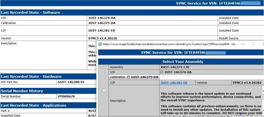

If not, in Oasis I see Ford has officially released an update to Build 20282 for Sync 3 v3.4 for the Ranger platform.
Has anyone installed this update and if so, were there any adverse effects? Not like the last update for 2019s that were running v3.3 and after updating to v3.4 Build 20136 some vehicles lost the climate control icon.
I'm curious if this update is only available for the 2019s that lost the climate control icon after updating to Sync 3 v3.4 Build 20136. My 2019 was one of the vehicles impacted by this issue. If so, this update could be Ford's official release that updates the As Built data on those vehicles to restore the climate control icon - which many users like myself have already resolved using FORScan or if there is any additional functionality/problem resolution with Build 20282. Since Ford doesn't publish release notes one is left to speculate. Update: refer to post #4.

Unfortunately, the Ford Owner site doesn't currently have the update available for my VIN. I am assuming this is the same for others??
I'm also curious if this update at some future date will be pushed out OTA eliminating the need for a manual installation. As of this morning, it is not available as an OTA update but that could change.

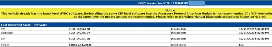

I randomly picked a 2020 Ranger VIN that was produced on October 21, 2020, and was shipped with Build 20136. The Build 20282 update is not available for this vehicle - Oasis states 20136 is the most current build.
This would tend to make one assume that this update is only available for those 2019s that updated from v3.3 to v3.4 Build 20136 and lost the climate control Icon. I would really like to compare another VIN for a 2019 that lost the climate control icon after the recent v3.4 Build 20136 update to see if that VIN qualifies for the update to Build 20282.
If anyone is willing to share a VIN # for a 2019 that after the previous Sync 3 update lost the climate control icon, I would like to validate in Oasis.

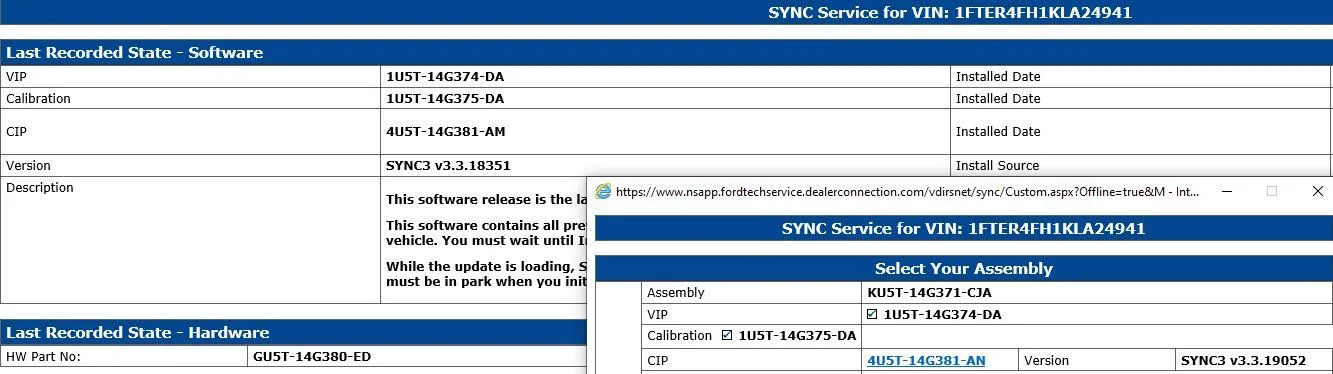

I updated to 3.4 and lost climate control but got it back by using FORScan, but when I check the owner site says I can get an "upgrade" to 3.3.19052. It has never figured out I upgraded to 3.4.
My VIN is 1FTER4FH1KLA24941 if you want to see.
Did you update via the official Ford release to v3.4?
Oasis confirms what the Ford Owner Website states.

I downloaded to a flash drive and updated that way. It has been a while - I think I might have used the cyanlabs installer as well but don't remember if that was the last thing I tried or if I did the cyanlabs installer and then the did official Ford one. Either way, it should be smart enough to report what version it is running back to Ford, but it is apparently not.

This is the exact scenario i have my vin shows i am current at 3.3.19052 but i'm running the broken 3.4v i upgraded and even uploaded the xml file back to ford. I'm sure eventually the website will go live with the current update.
