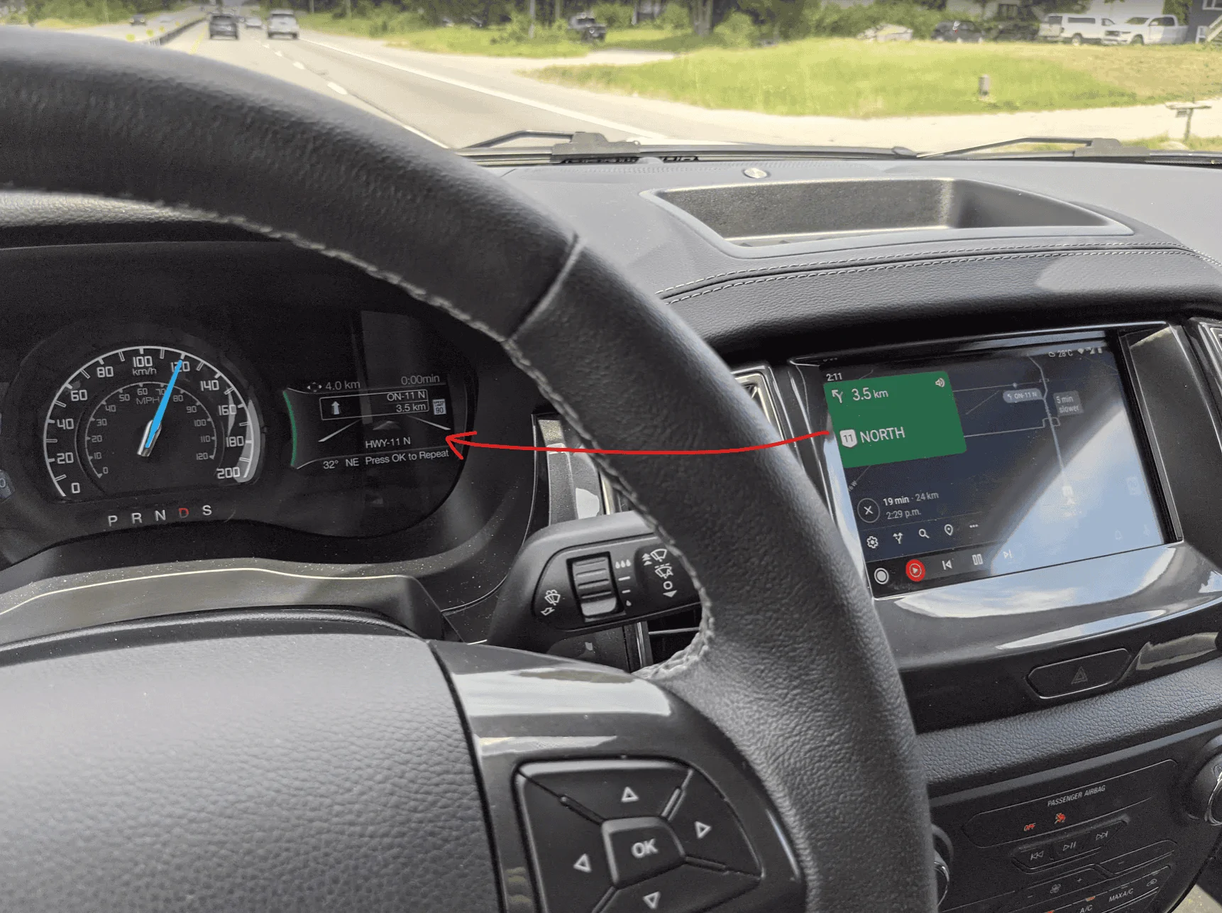

I noticed yesterday that the Navigation area of the Lariat dash cluster is getting fed info from Android Auto. Pretty sure it didn't do that when I bought the truck. Not sure which update would have changed that.
I can see the name of the road that I'm currently on, the name of the next turn, the distance to next turn, and the speed limit. The remaining trip time and distance are up top but either stick at 0 or 4 for some reason.
