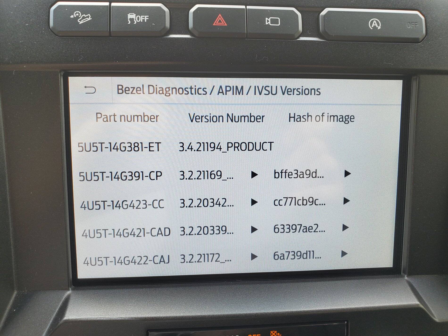

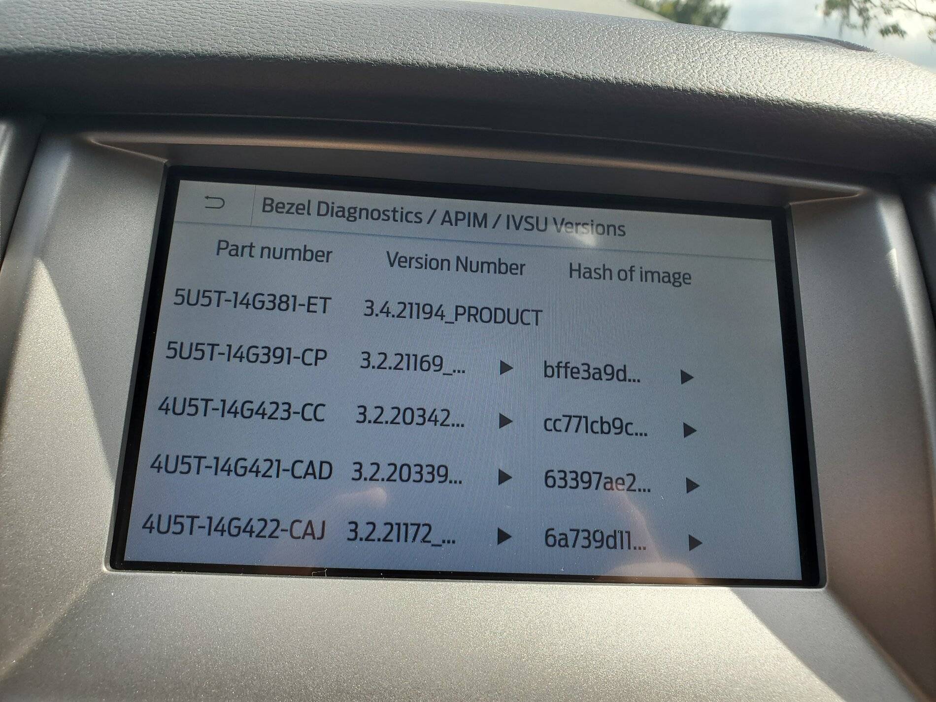

As I mentioned in one of my previous posts, on 8/29 I updated both my 2019 F150 and Ranger to the newly released Build 21194. I didn't receive an xml file for either vehicle. Normally that's not a problem as the first time I wirelessly scan for updates, Oasis would automatically recognize the latest software had been installed and update Ford's database. Not this time. Scanning for updates did not update Oasis, therefore the Ford Owner website didn't get updated.
Just wanted to follow up on this...
On 9/2/21 Oasis finally recognized the latest Sync 3 software had been installed in my 2019 F150 and today Oasis recognizes my 2019 Ranger has the latest Sync 3 software installed.
Unfortunately, Oasis has not recognized the latest Navigation voice file (4U5T-14G422- CAJ) that was released last week has also been installed.
When will Ford ever get this process right !!
