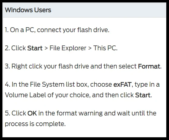

It may not make a difference, but instructions specify exFAT formatting.
You have to format the usb drive with the exFAT file system or it probably won't work....

Ex-fat was designed to provide more space on a USB drive. Apparently the Ranger uses the same concept. The file systems should be the same for integration. If you have problems...make everything the same.

exfat is the correct format; you happened to get lucky and ntfs worked anyway, but there's no guarantee that ford will keep that working since they specifically say to use exfat.
I think fat actually worked fine also, but I'd still recommend just following the directions.

your information is obsolete. :) sync 1 & 2 (generally considered horrible) were based on Windows. sync 3 (what we have in the ranger) & 4 are based on qnx.

Man, you can do whatever you want, just don't get butthurt when other people point out that the directions say to do something else. I really don't understand what you're still arguing about. Most especially, if you don't know software and OS's, don't keep insisting that it isn't an issue--there are a lot of tears in the vast gulf between "happens to work" and "tested and supported".
Everyone can google "qnx ntfs support" themselves, no need to paste the top link. There isn't any question about whether an ntfs drive can be read, the question is whether it's reliable for the purpose of the firmware update. Given how generally flaky and unreliable that entire process is, I personally want to introduce as few additional variables to it as possible. Ford could have easily said nothing about what filesystem to use for the update, but they didn't do that. Maybe it's because they lack imagination, maybe it's because they didn't bother to test more than one configuration, maybe it's a copy & paste from some australian version with different requirements, or maybe it's because in some cases doing something else blows up. Maybe it depends on what version of windows writes the ntfs, maybe it depends on what features are active in the ntfs volume, maybe it doesn't matter at all. If someone wants to experiment with different configurations out of sheer cussedness that's certainly their right, but most people probably just want to know the most direct route with the highest probability of success.
