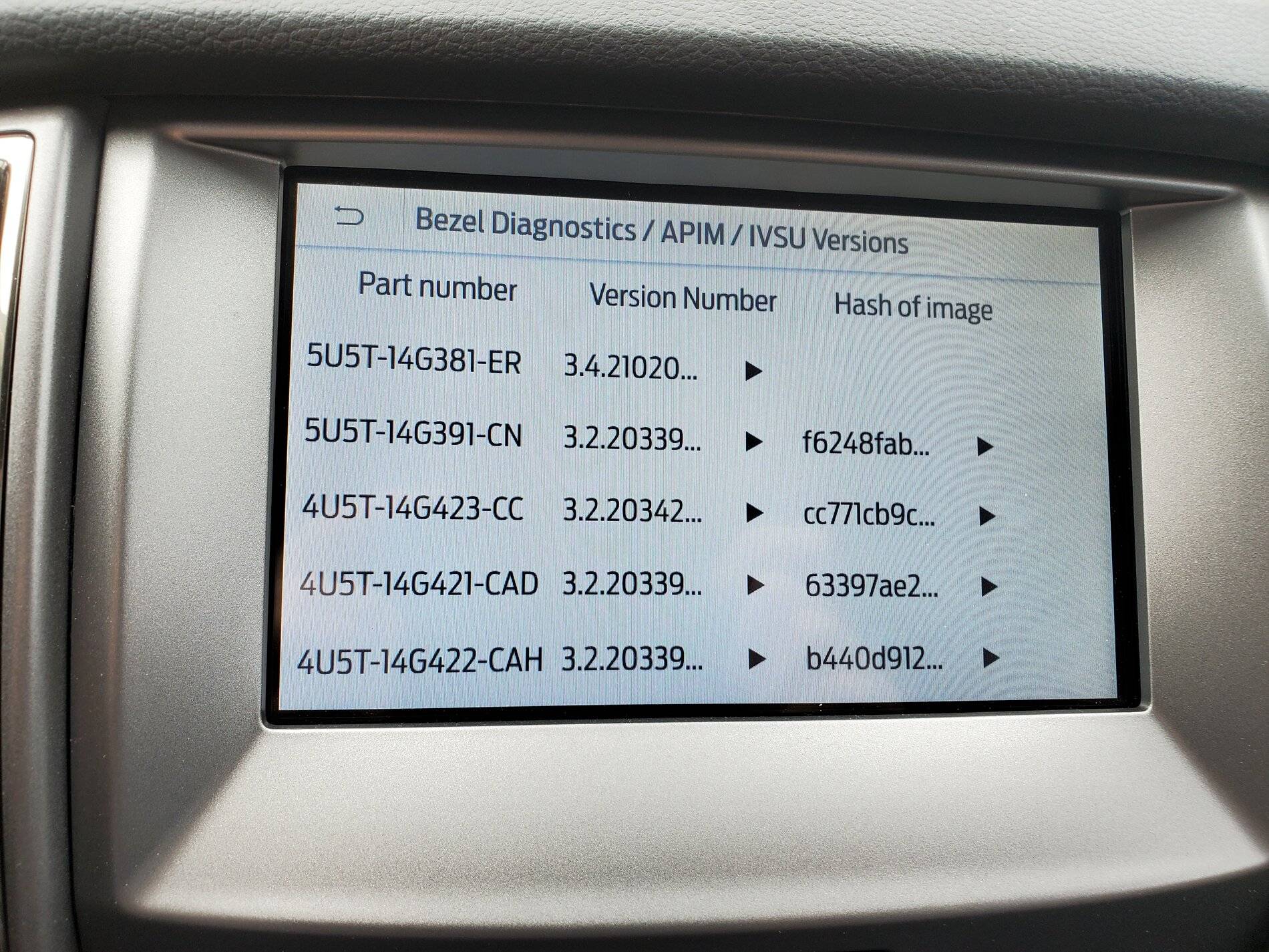

Finally completed this:
And I thought.. 'great!'
...now:

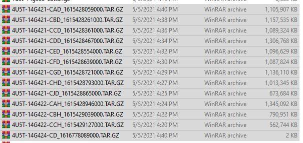

Mine is doing same. What are these files?
I believe the files starting 4U5T-14G421-CxD_xxxx... are updates of the map to Version 2 20. At least that is mine did. I also believe there are 14 different files to the map update. Using WiFi, my Ranger took about 3 days connected to my home to download and install. YMMV.

I believe the files starting 4U5T-14G421-CxD_xxxx... are updates of the map to Version 2 20. At least that is mine did. I also believe there are 14 different files to the map update. Using WiFi, my Ranger told about 3 days connected to my home to download and install. YMMV.
Mine took 2 weeks to download and install all of the files.

Does anyone know what all these files are? My map version showed 2 20 after the 2nd file loaded....surely that's not really true if it takes 13 files to complete the map load.
One issue I noticed is that the -CHD package "was installed successfully" but it keeps trying to install it (3 times now). How does one know if these files were successfully loaded? What are the consequences if one file does not get installed?

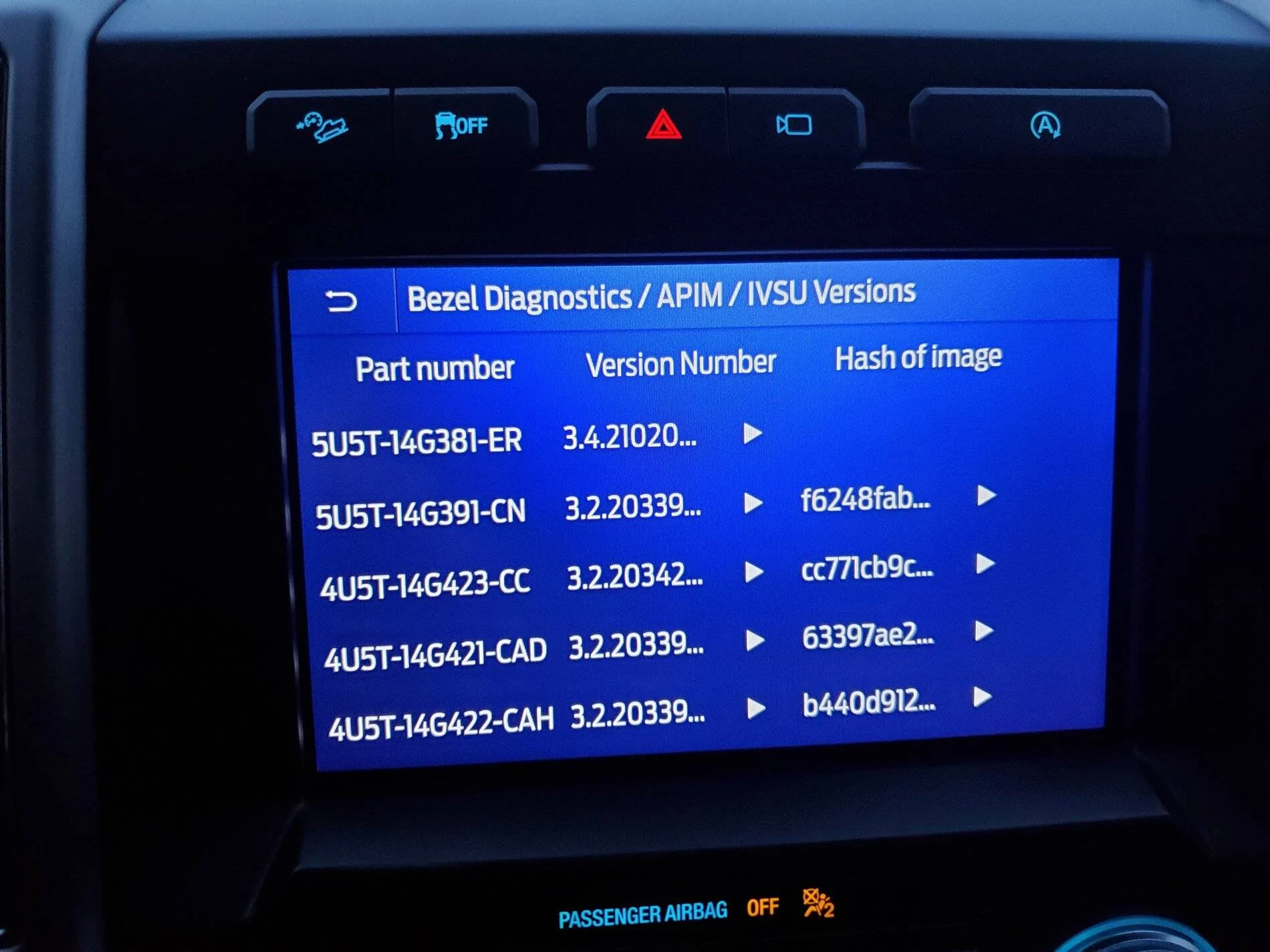

My Ranger also showed the new map version NA 2 20 was installed but continued to download files for several days. Yes, it downloaded the same file more than once. I have no idea why. I continued to manually scan for updates until Sync 3 stated that the software was up to date and no further downloads were available and the last scan date and time were current.
I also confirmed the truck disconnected from wifi about 10 minutes after the truck was shut off. I finally became so frustrated I let the vehicle run to download and install the remaining files.
What is interesting is my 2019 F150 parked right next to the Ranger and connected to the same wifi source had none of these issues.
Furthermore, even after all the map files were downloaded my IVSU files don't reflect the highest level of software even though I know they were successfully installed in both the Ranger and the F150.
