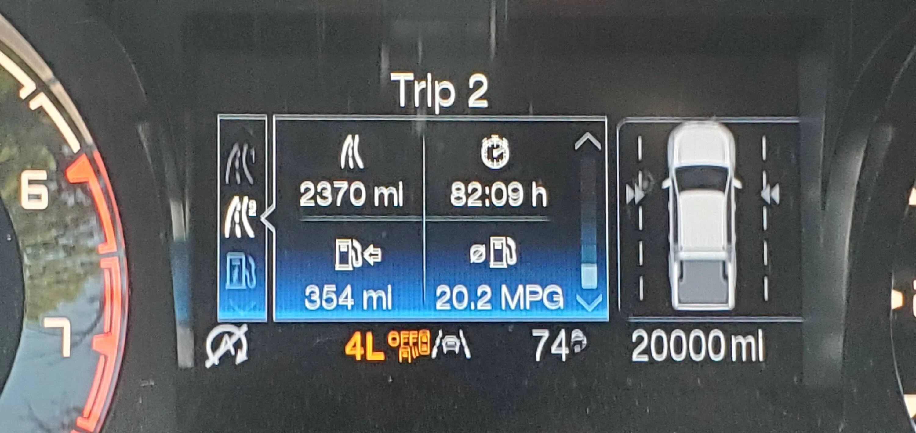

I use android auto and Love it! I cant live without my youtube music play lists ( I drive a Lot! ) in the last 3 months I have put 7000 miles on my truck and I just turned 20k two days ago ....

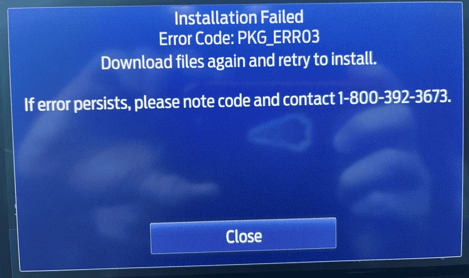

Well, after multiple failed attempts and the system trying to run updates for 2+ months now and not even recognizing the thumb drive, I took it in today to Koons Ford, Annapolis, MD to be looked at.
My extended Premium Care service plan runs through Oct '24, and they just quoted me over $1300 :mad: to replace the APIM... after I ?'d myself, and politely replied to the email, text message and left a message... they called back to confirm that it IS actually covered and will cost me the $100 deductible rather than the $1300+ ?. So the APIM has to be replaced.
For reference, this is the message I had received twice:

Glad that they will help you out Scott. I hope that is the problem and the new AIPM fixes it. Keep us informed.

Got the Ranger back from Koons tonight after they had it for 4 days. APIM was supposedly replaced, yet it has the same 22251 version with an update date of 9-8-22, attempted to update, ran for 3 hours and gave up. Same issue. Another fail.
Scott, I highly recommend you try updating using the CyanLabs if you have not already tried.
They obviously did a half-ass job on this. They should have updated the system before giving it back to you. I’d be skeptical they did anything at all.
