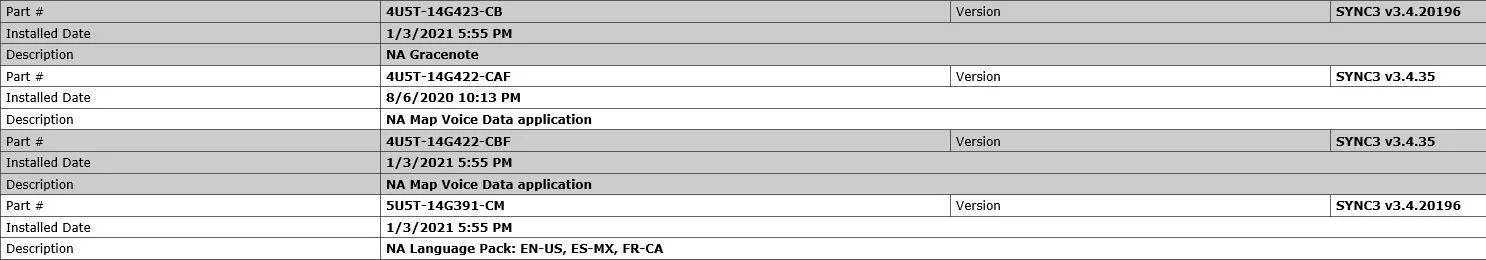

Easier. Just re-use the stick / download you had for the F-150. Since both trucks are NAV, the installer is identical. Then no need to mess with the autoinstall and such.
You sir... are a genius !!
I took the 2019 F150 w/Nav Sync 3 v3.4 Build 20282 update and installed it in the 2019 Ranger and I'll be darned if it didn't install the missing Gracenotes and NA Language Pack files. Even wrote the XML file. Took about 20 minutes.
Thank you very much for your help.
Edit: Oasis now also reflects the latest version of Gracenotes and the NA Language Pack is installed

What is Gracenotes used for?

I believe it's also providing album art when you're sourced to Bluetooth Audio.
Thanks. At first I didn’t see a version for Gracenotes but pulled it outside and checked again and it was there.

I noticed I didn’t have the ā€˜CM’ file as mentioned above as part of my install files, just the other 5 shown. If they are to do with the voice directions then it wouldn’t bother me as I have always muted them, but I’ll give it a try again to see if any difference.​
