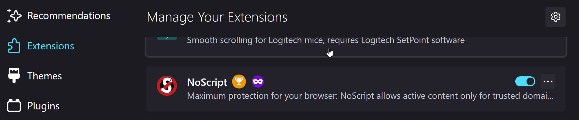

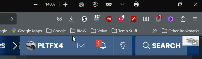

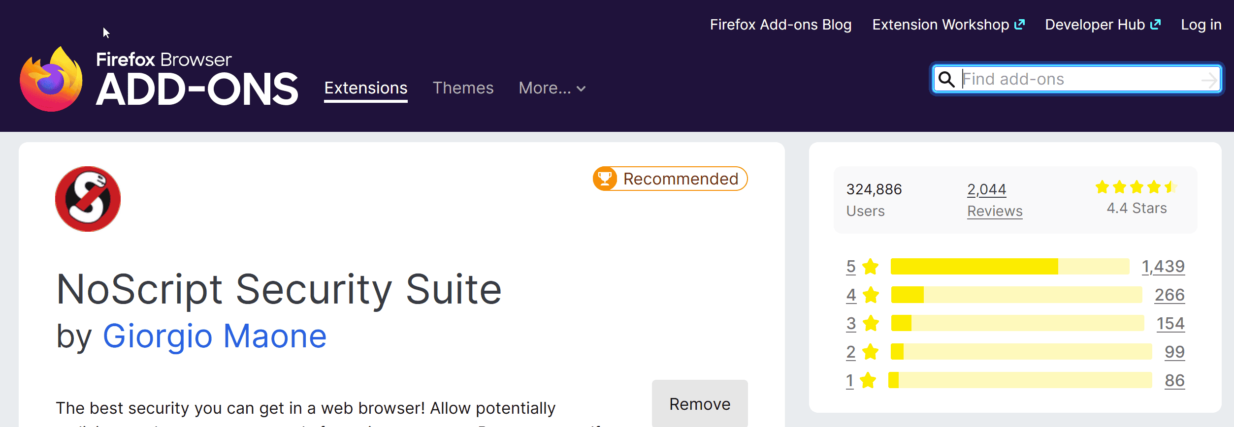

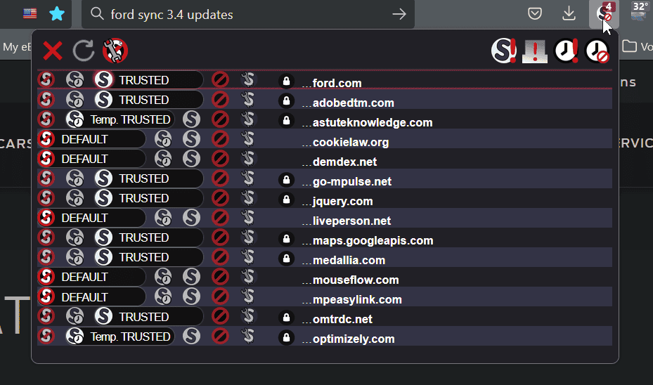

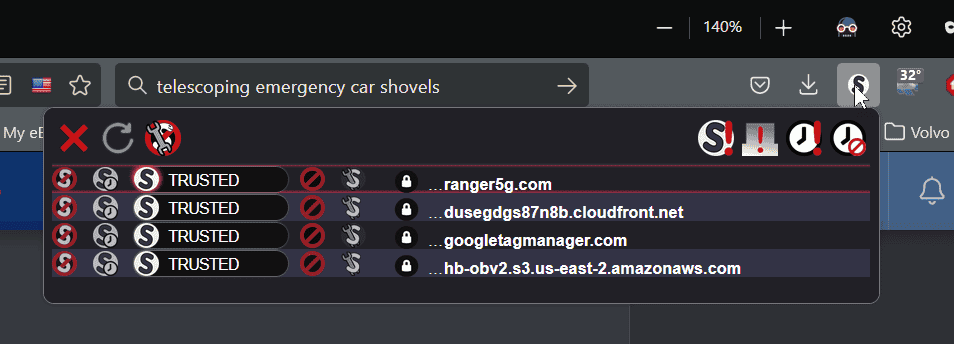

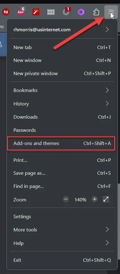

Can you explain to a Firefox rookie how to not block Java scripts on the Ford site? Thanks.
There is an Extension called NoScript (for FF, Chrome, Edge, etc.). Install it. How?? In the upper right corner of the window is the 3 bars; click it and then select "Add-ons and themes
Get to here:
Type in "NoScript" as above and search.
Get to here:
Click install.
Now you have:
Click it and read through the options.

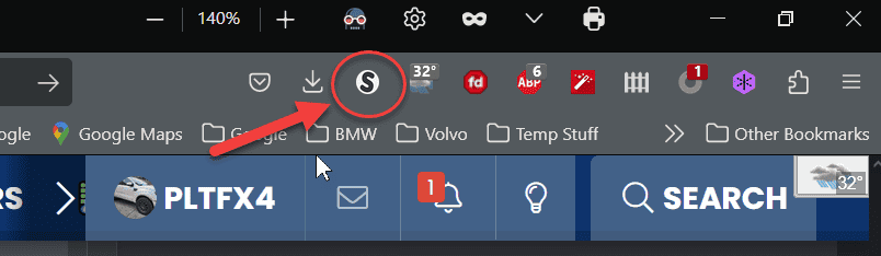

Once set, you should see it here :
On ANY site you visit, the default is "Block all scripts". One of the setting is o allow scripts from the top domain to be "temperately be allowed" to run.
You can see which scripts are allowed or not by click the "S"...
You can, as I have here on Ranger5g.com, permanently allowed the scripts to run. Over time, you will learn which one are needed to run the site, and which are just "spy" scripts.
Note: some sites use only few... to start. Then select nearly anything on the page, and the list explodes to 15, 20 or more!!
Here is what I use for the Ford Sync site (also note: NoScript remembers your choices on each site, so the next time you visit, you don't have to go through the selection process again):
