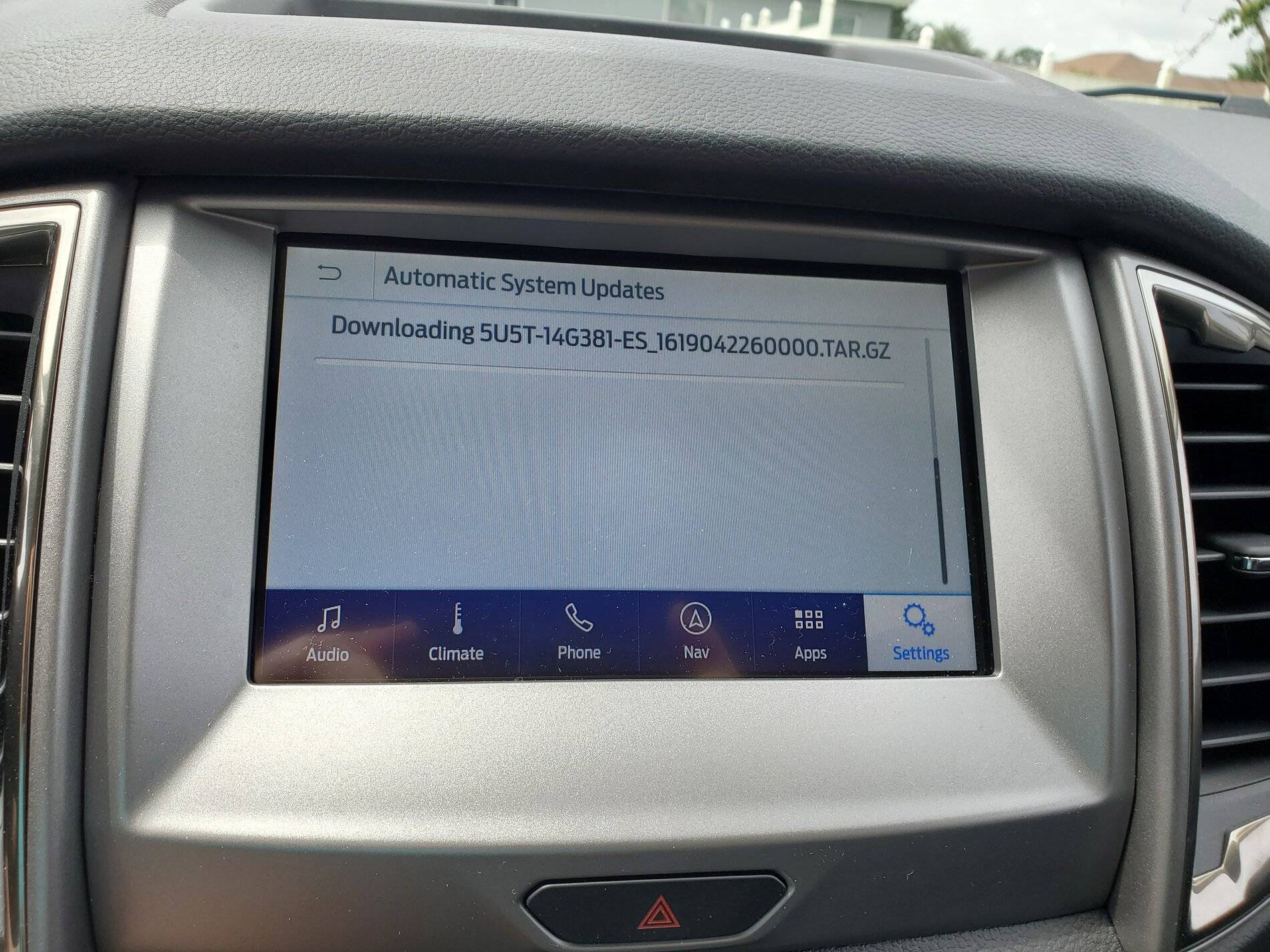

Go to the Ford Sync Update website, type in your VIN and it will guide you from there if an update is available.

If you're connected wirelessly to your home Wi-Fi it will just update itself
If you want to wait forever for it to download.
The zip file is almost 1 gb.

Mine updated over wifi on consecutive evenings. My XM froze one day but autocorrected and it's been fine ever since. I didn't even realize it was updating until the XM went down. I came on here and saw it was common. To each his own.

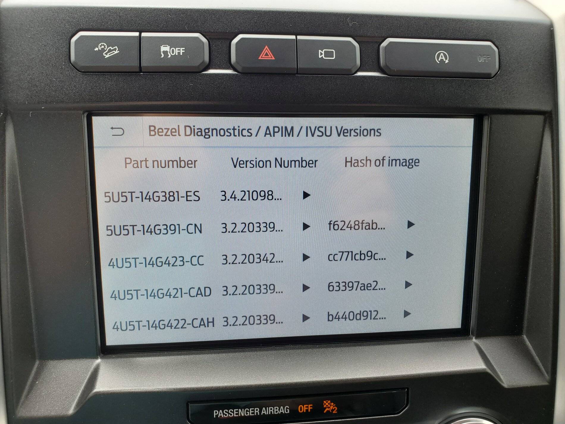

Unfortunately, as others have previously reported, Build 21098 did NOT fix the Sirius XM issue or Travel LInk, but we already knew that.
Furthermore, the XML file was never written to the USB flash drive.
I had to run a manual scan for updates to notify Oasis and the Ford Owner website the update has successfully been installed.
