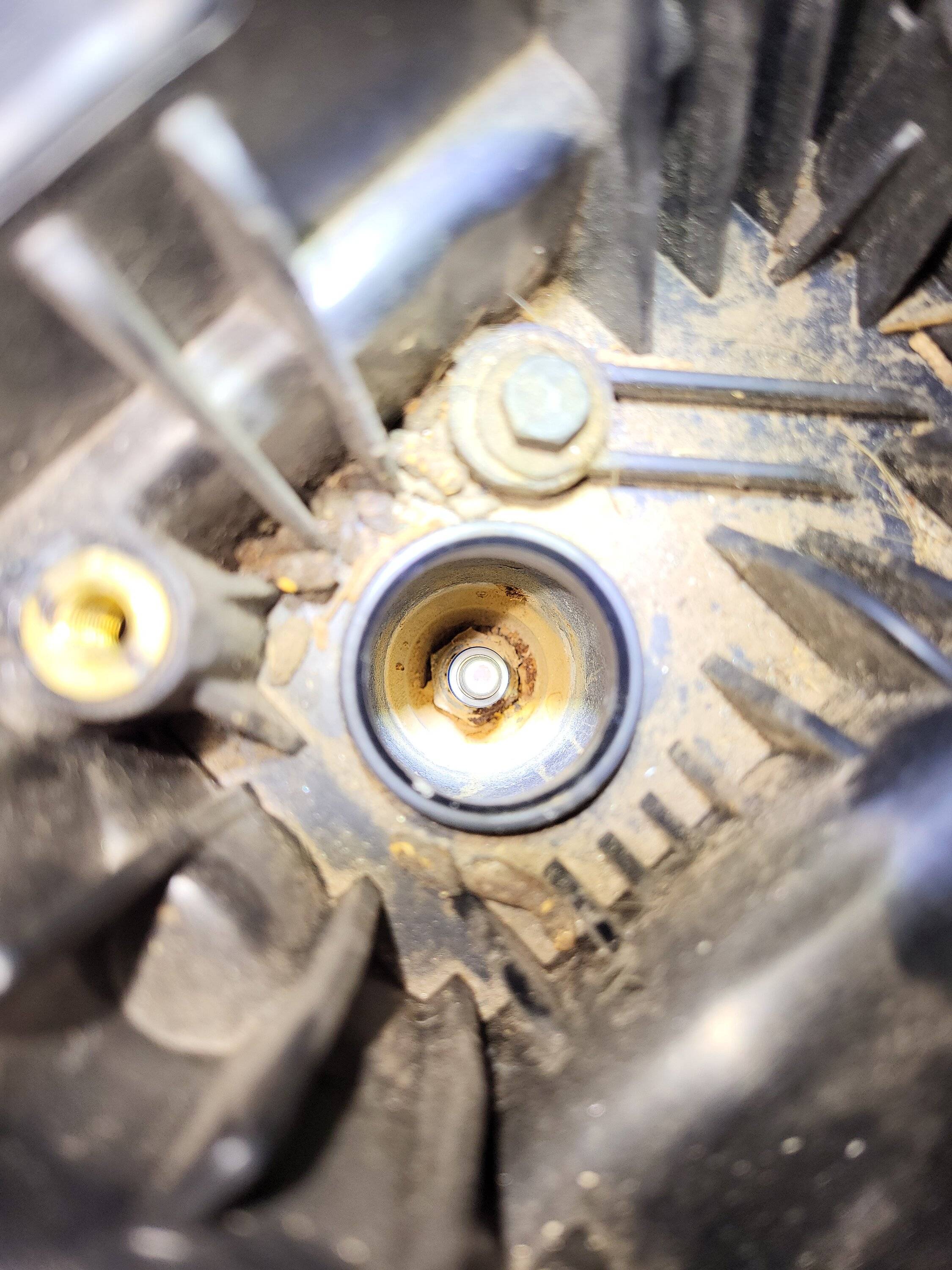

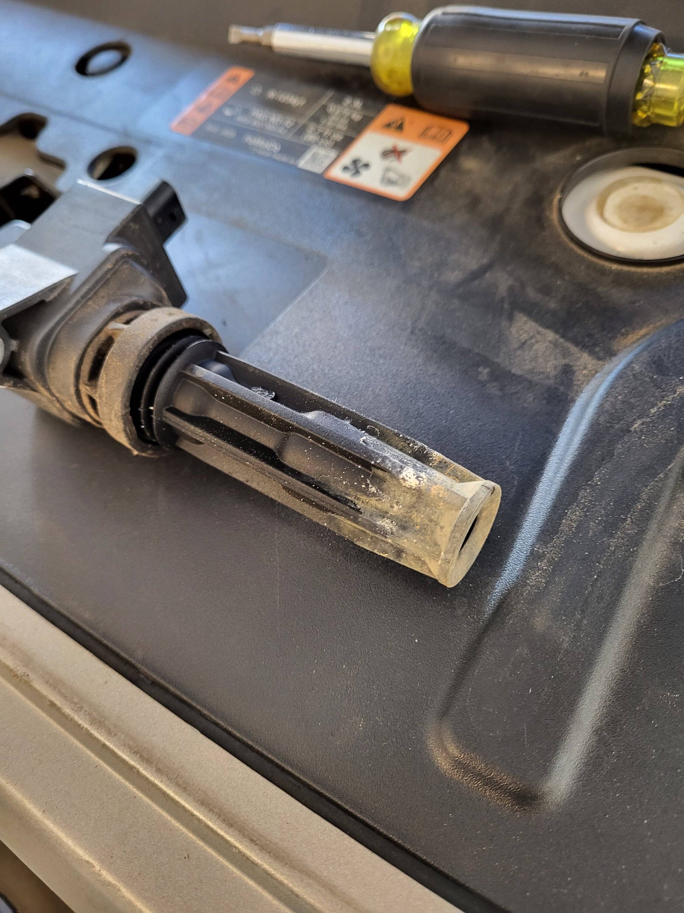

Welp, decided to check my spark plugs with a rain storm coming next week.
First plug was screwed. Boot was HARD to get off. Mine looks pretty bad. So far I don’t think I have drivability issues but we'll see with the rain coming...Sometimes I do notice some jerkyness while driving. My truck did not come with an engine cover. It doesn’t rain here much but I have washed my truck twice since I got it.
Called the dealer to report the issue and gave him the 21-2147 TSB, he said it was outdated....Does anyone have the new TSB number?
He aslo kind of hinted that this is not covered under warranty (I’m at 41k Miles). Only lubricated engine parts are under the 5 year 60k warranty.... well if the cylinder head is rusted out and I cant install a new spark plug, lube goes through the engine head for the valves and such???...
Honestly if they don’t fix the issue, I may have them replace my spark plugs as a preventative maintenance....good luck getting that first one out. If they break it they better fix it.
The new TSB is in the first page of this thread.
This *IS* covered under warranty, but only if your truck throws the CELs indicated in the TSB.
I have attached the latest version of the TSB that I can find (23-2011). Maybe there is a newer version adding the 2023s.
Check the Warranty Status section. It states this is covered under the ESP (old name for Ford Protect warranty).
First a correction to one of the posts above - The Updated TSB 1/13/23 - did not add 23MY it only added the 22MY
Wow, that looks pretty bad, and I am positive that is going to FIGHT to get it out.
So, with the known problem and the high possibility of it breaking off in the head, it may be wise to let a dealer do it, mainly due to the fact if it breaks off you have at least a 50/50 shot at getting it covered under a warranty claim. Depending on Dealer.
If you DIY, it will all be on you with ZERO warranty claim possibilities.
Now if you tackle this yourself. I would follow the following procedure. I have dealt with corroded bolts in my career and even a few corroded plugs. None on the Ranger (YET)
But since we cannot get a propane or welding torch down there to heat it up, the following procedure - SHOULD work.
1. Spray Brake Clean, down in the hole and let it soak, get a thin rag or small pipe cleaner brush and wipe what you can - To break up and clean the debris out of the hole.
2. Use a Blow Gun and blow out debris and brake clean that has not evaporated.
3. Get a good quality - spray lubricant - I recommend KROIL it has excellent creep quality.
Let it soak for 8 hours or so.
4. Blow out the hole again, with blow gun and then follow with brake clean and blow out again.
Reason for this: You do not want to get any lubricant on the COP boots, and you will be starting engine in step #5
5. Install the COP back on the plug, and run engine for about 10 minutes, you are wanting to get the plugs warm (not hot)
In this instance - Following the manual is highly recommended.
Ref: This Service Note from the manuals
NOTICE: Do not remove the spark plugs when the engine is hot or cold soaked. Spark plug thread or cylinder head damage can occur. Make sure that the engine is warm (hand touch after cooling down) prior to spark plug removal.
6. Shut engine off and spray some more lubricant down in the hole, this is the working lube as you remove the plug.
7. DO NOT go full bore at trying to remove it, this I believe is where and why the plugs are breaking off. BABY STEPS, CCW 1/4 Turn, CW back to tighten, CCW 1/2 Turn, CW back to tighten, turning it a little farther on each try.
The reason for this: If you go FULL BORE, the corrosion on the threads will seize up and create so much tension that the plug breaks off.
This process of CCW / CW allows the lubricant to work into the threads and break up the corrosion it also helps in cleaning the threads when going back to CW.
Ref this video I found online for explanation and technique.
How to Remove Seized or Stuck Spark Plugs - YouTube
I have a feeling if this technique is followed, there should not ever be any broken plugs.
8. Once the plug is out, I would use a new or old clean threaded plug and clean out the threads of the hole, using the same technique as the removal, just a small amount at a time (CW / CCW) until you are able to thread the new plug in all the way by hand pressure on the extension.
Once you have the threads clean, spray a SMALL AMOUNT of brake clean down in the hole, you are wanting to clean the lubricant off of the threads.
Once clean - Install New Plug
Now the manuals do not specifically call out for Anti-Seize, in fact most spark plug manufactures state do not use it for this type of plug.
But I will say, as a preventive maintenance with (ZERO) water noted in my plug wells I pulled mine and Anti-Seized them @ 8,700 miles.
9. I also highly recommend replacing the COP on any plug that was drowning in water. mainly due to the fact that you also have corrosion inside the boot.
Good Luck
