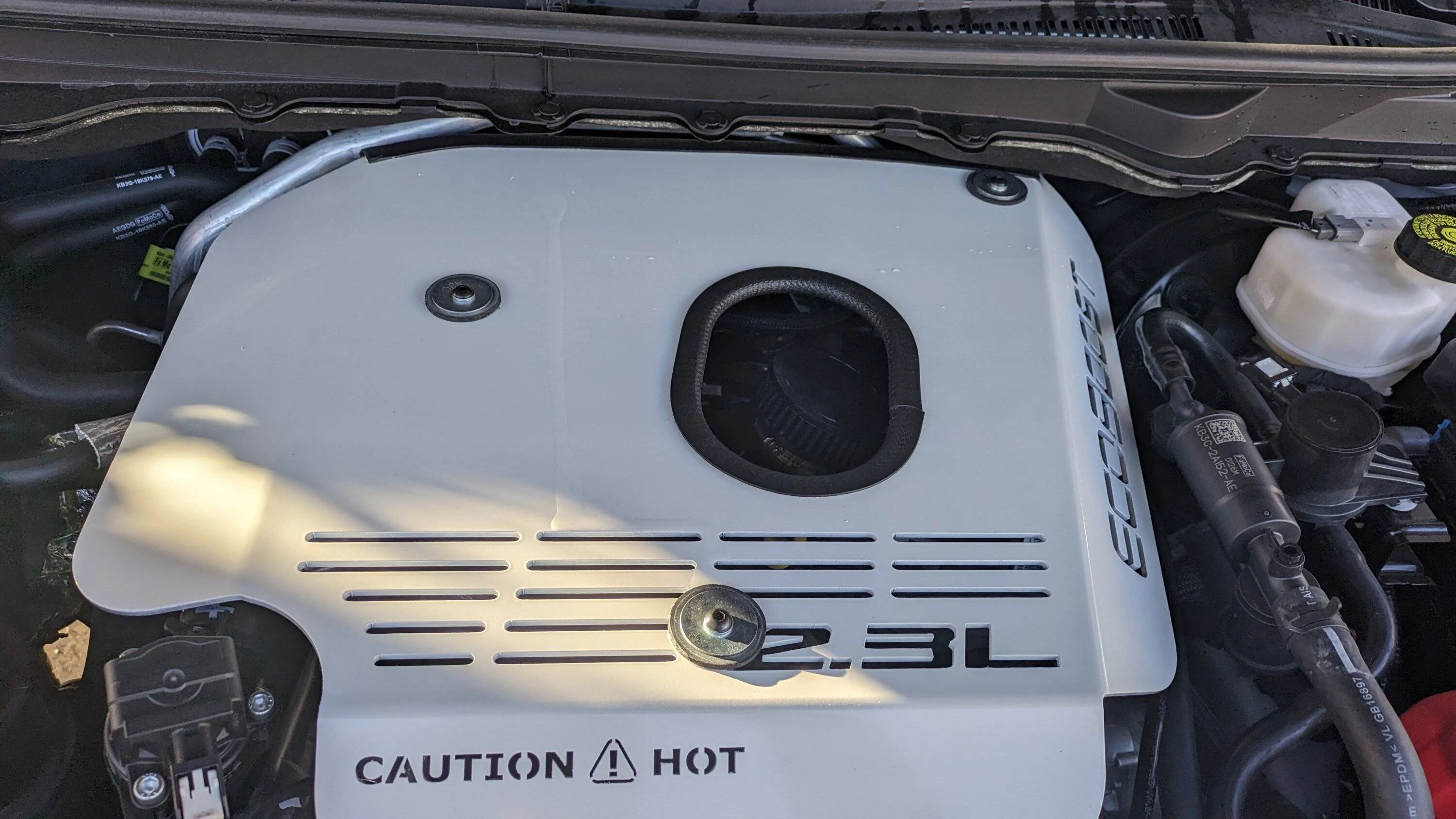

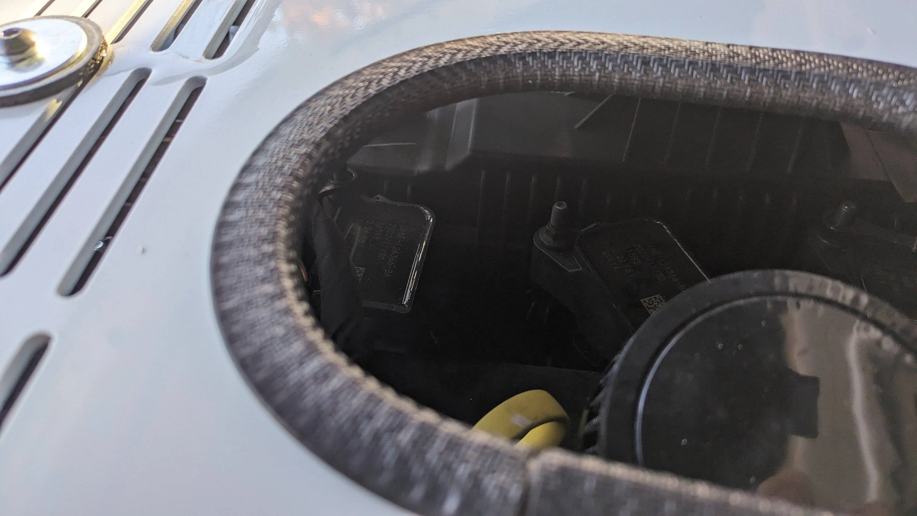

Gave the Yeti a bath today and the driveway is on an incline. Popped the hood after hitting the windshield to see how the new engine cover was helping, and wouldn't you know... success!
it actually hit the grill at the front, the surface tension brought it to the right, down between the vents to the rubber washer and bolt where it finally fell through, well in front of all the plugs
Just inside the hole on the left is the last plug, it's falling in well in front of that. I'll continue to check here and there but this appears to keep water off the plugs and the top of the motor where they sit
*ETA - I may do another mod where I cut the nubs separating the first row of vents and slip another row of edge seal in there to push the water left/right away from the vents, or at least one nub to push it away from the last plug ?
