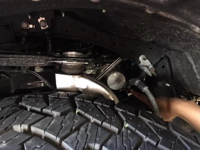

I didn't see any pictures posted here of the actual installed filter. It took me a few minutes to find it so here is a picture of me pointing to behind my driver's side front wheel.
