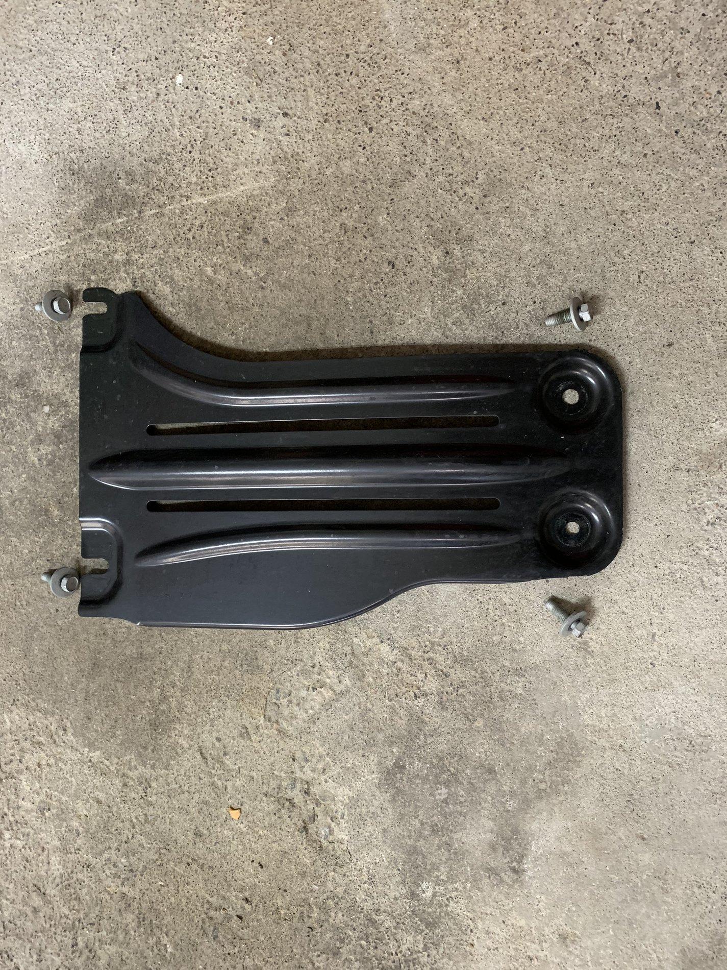

I purchased the service manual as I do for every vehicle I own. There is a skid plate that needs to be removed below the engine to drain the oil without making a mess. No big deal.

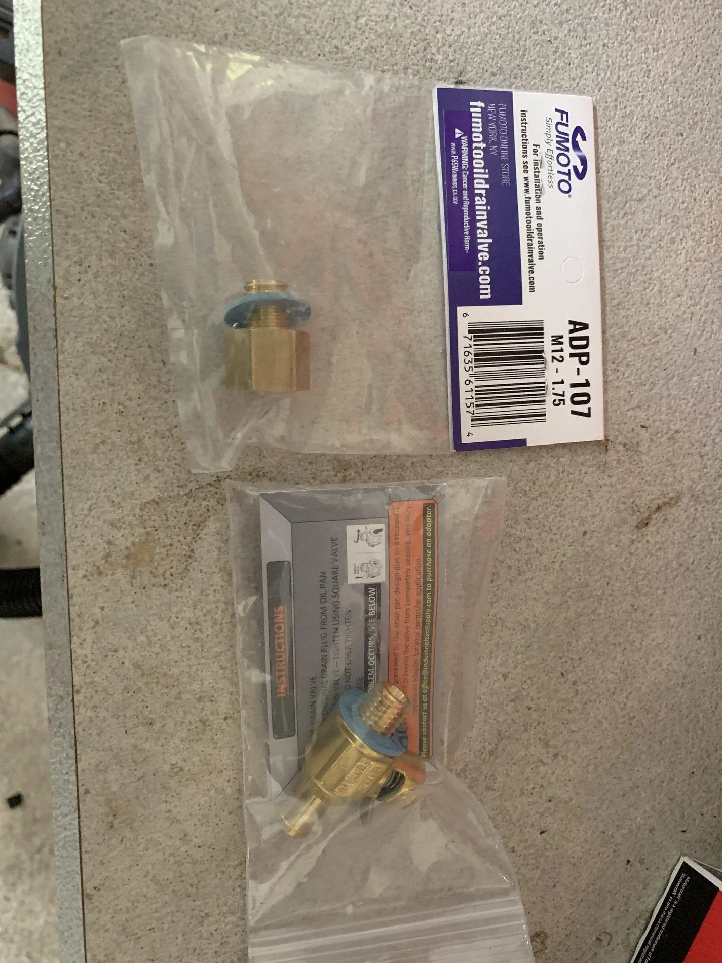

  • The ADP-107 adapter uses a 3/4” open end
  • The 107N Valve uses a 17mm open end

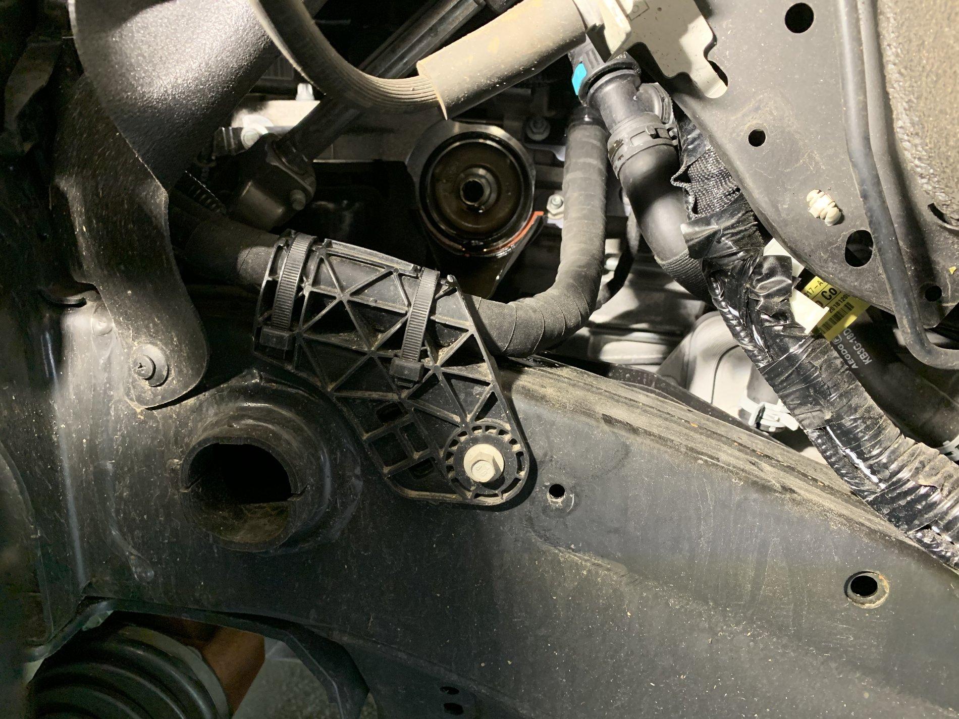

View from the fender with the inner liner removed, staring into the abyss of the removed oil filter. Note the old filter gasket was still attached here, remember to make sure it is removed (funny story behind this I'll share another time).

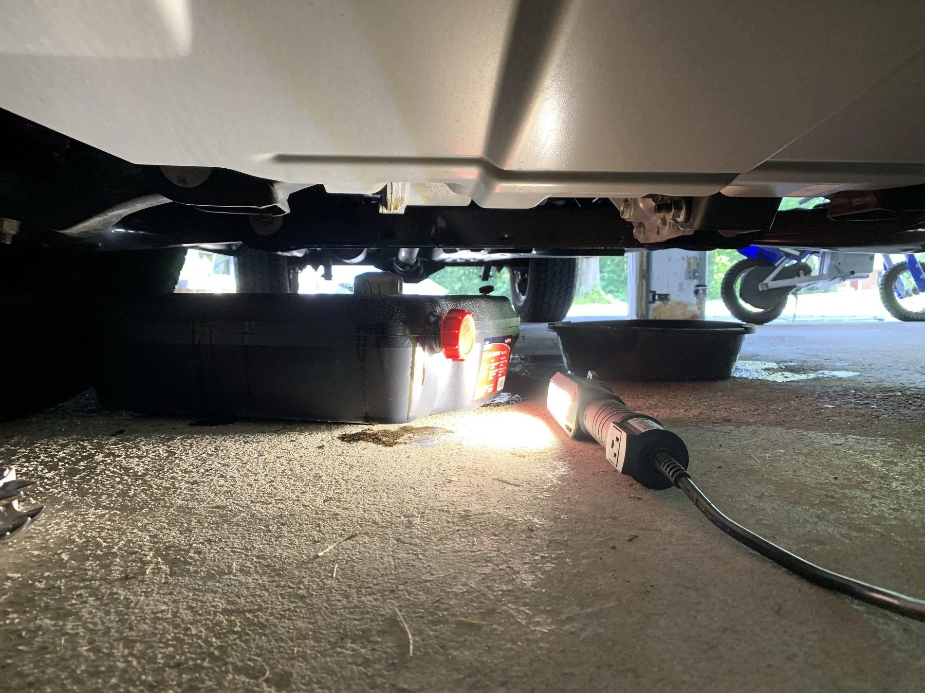

A view under the truck at how much room there is. If you are skinny, you won't have any issues. If you had a big breakfast, maybe wait a couple hours...
This is the skid plate you have to remove. FOUR 15mm bolts.
The Fumuto Brothers. The ADP-107 takes a 3/4" open end and the Valve itself takes a 17mm open end.

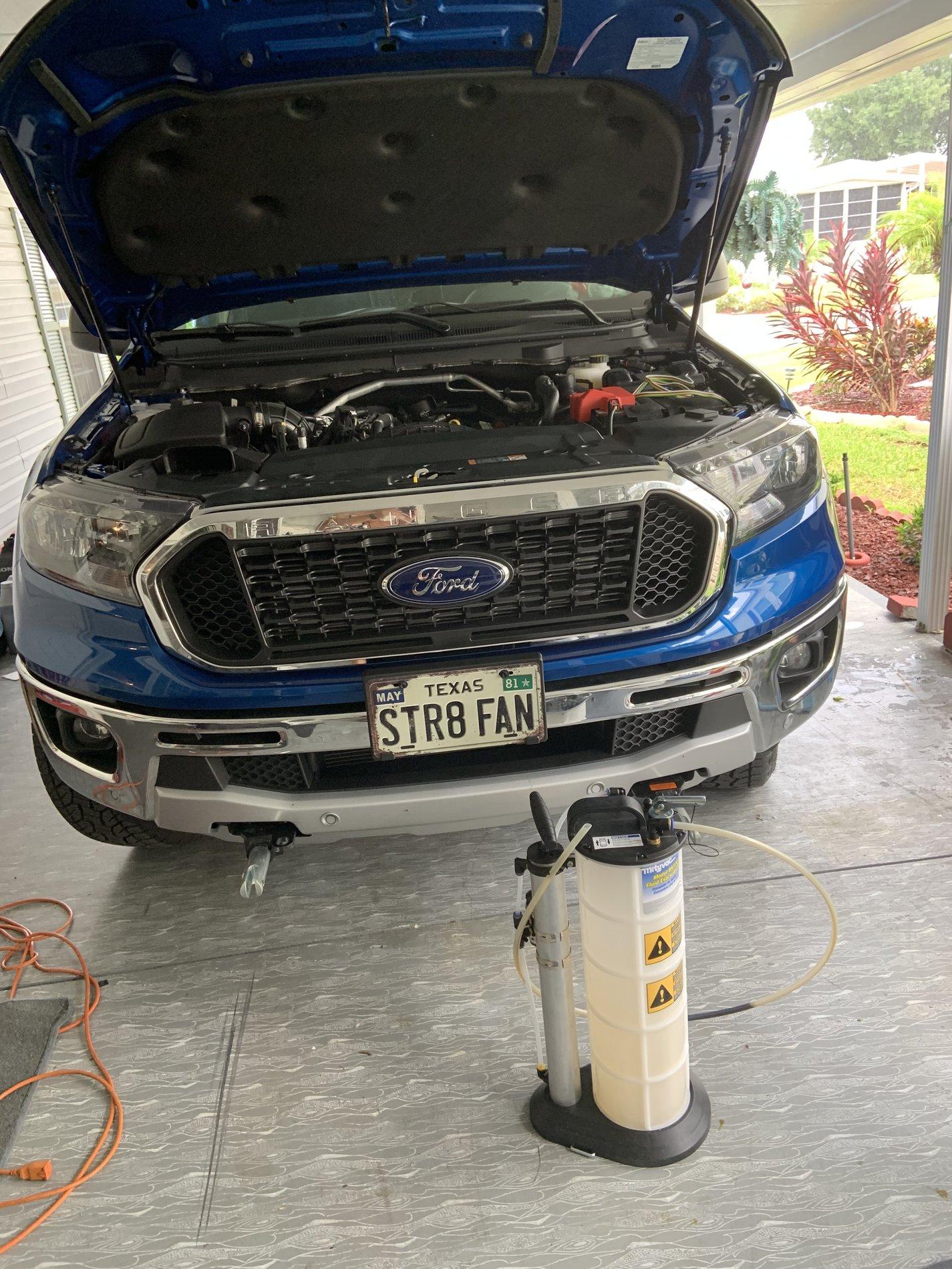

First oil change done with new mity vac, I am impressed - got exactly 5 L out and that took around 15 minutes to suck the old out. Mobil 1 full synthetic as I always run. M102a Mobil 1 filter went in easily after moving the fender wall flap. Nice oil catcher on the ranger to catch the drips from the filter.
