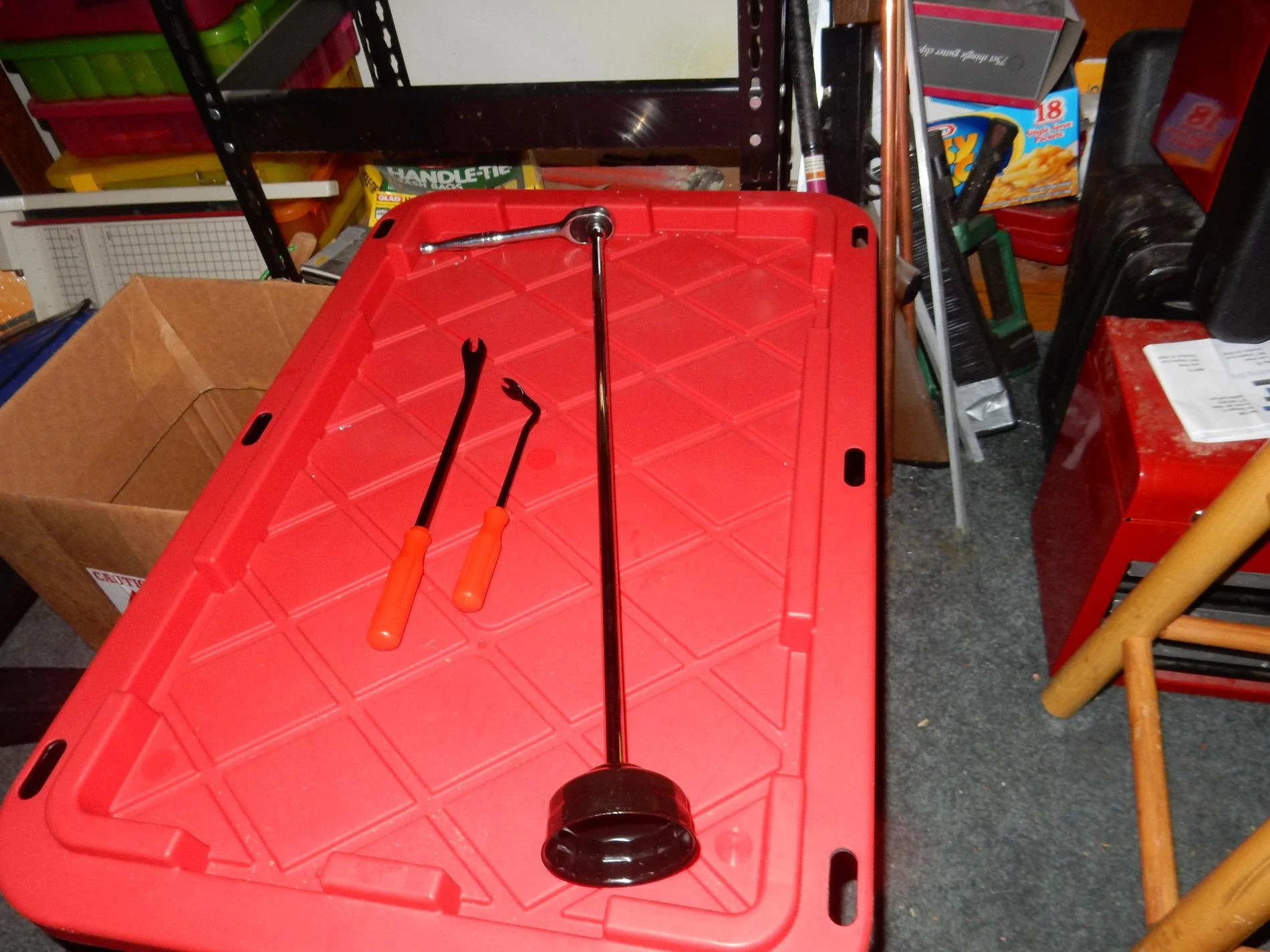

These pry bar body tools make it easy to remove the plastic screw rivets on the left fender flap to access the oil filter. The long 24" 3/8 drive extension (Harbor Freight) makes removing the oil filter easy peasy. ;)
Of course, if you are a midget, then you don't need these special tools.
