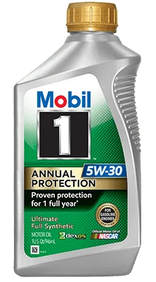

Which Mobil1 are you using, Mobil 1 Annual Protection Ultimate Full Synthetic SAE 5W-30 Motor Oil?
t4thfavor
Chance
Feb 5, 2019
2,593
2,328
I either use regular Mobil1 or the extended protection (15K miles). But I change it between 7 and 9k miles depending on convenience, and price of oil. I would do the yearly protection if I only drove a few thousand miles a year in large spurts.
The whole change costs me like 23$ with a mobile 1 filter because they offer a big ol' rebate a few times a year, and I usually buy enough for the year. I also have the Fumto, so it's going to be mad cake easy.
