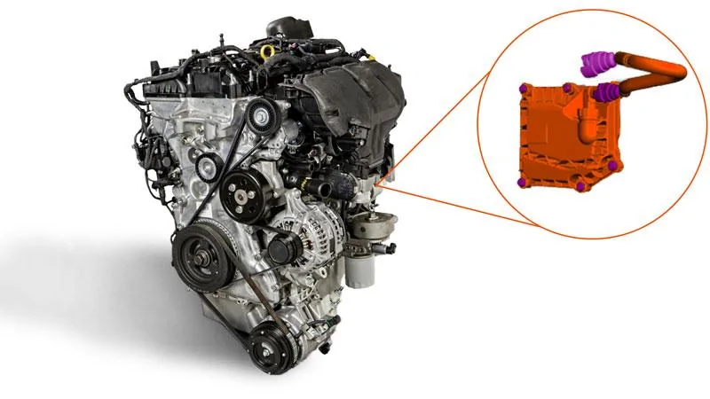

It's on the driver's side of the engine just above and back from the oil filter. It's the device you're connecting the hoses to when installing an oil catch can.
I believe Ford first started putting them on the Mustang 2.3L somewhere in 2018. For the 2015-2016, Ford released an external unit like this one. https://performanceparts.ford.com/part/M-6766-A23

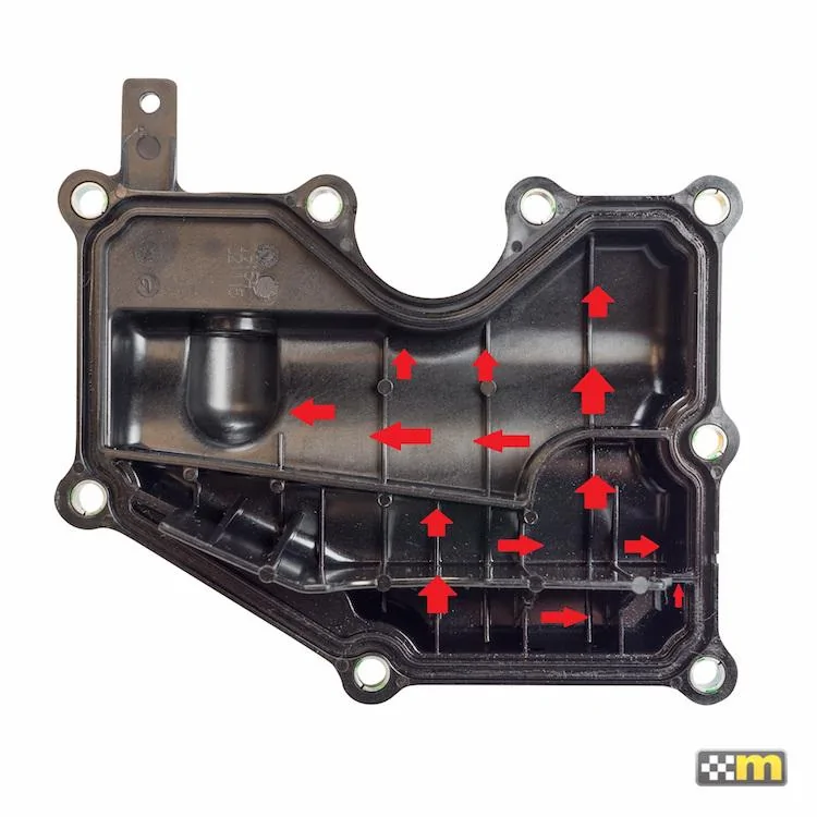

What is installed on the 2.3L consists of a baffle plate to repeatedly change the direction of airflow slowing it down so the oil vapor will fall out of the air stream. This is the back side of the separator/baffle plate installed on the 2.3L Ecoboost.
As far as effectiveness, based on what people are reporting when draining aftermarket catch cans, it looks like they do make a significant impact in the amount of oil vapor returning to the intake via the PCV but leaves room for improvement. Perhaps putting some steel filter material like that found in catch cans would slow things down more to allow more oil vapor to be removed within this baffle plate.

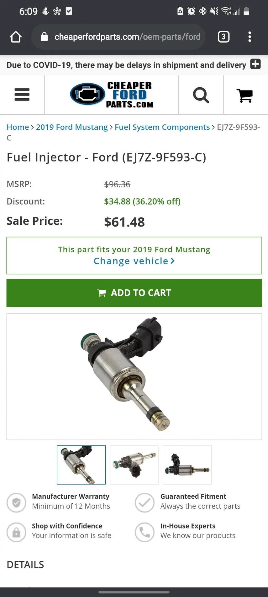

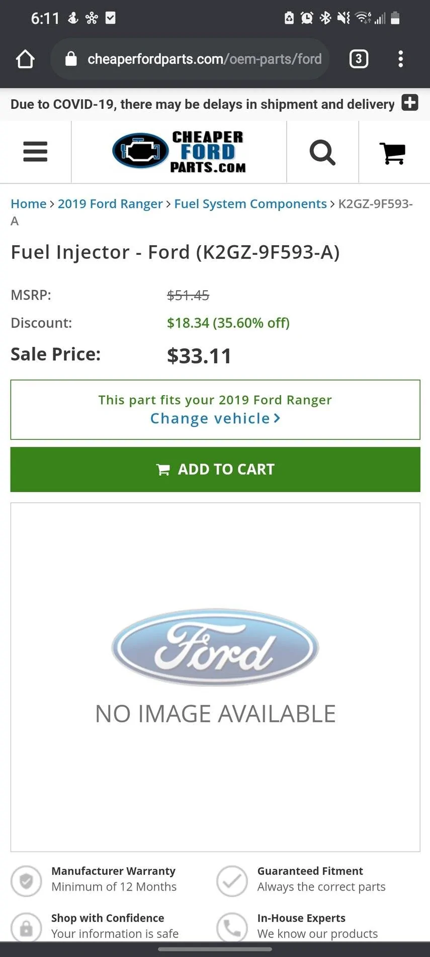

I'm thinking about buying mustang injectors and having my tuner tune my truck for them. Mustangs do not have this issue, and they flow 7% more... so it's kind of an upgrade. The Ranger injectors are used in 2.0 equipped cars according to the ford parts catalog.
Porpoise Hork
Bret
Apr 28, 2020
1,316
2,366
Houston
IT
Interesting. Agreed you would definitely need an updated tune for the flow increase to get the most out of these. Be worth getting before and after dyno runs to see what if any increase these provide.
