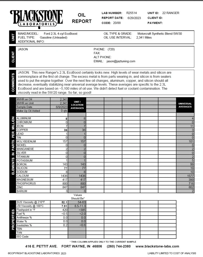

I recently changed oil at an early mileage interval as I wanted to get some of the break-in junk out and check on how the oil is holding up. The junk in the oil was expected, however, the oil sheared pretty quickly with just 2,3xx miles on it. I certainly would not want to leave it in for 10k miles.
I'll change again at roughly the same mileage and send it for sampling. At that oil change, I will be switching to Motul 300v 5w40 and continue sampling.
No fuel detected in the oil.
