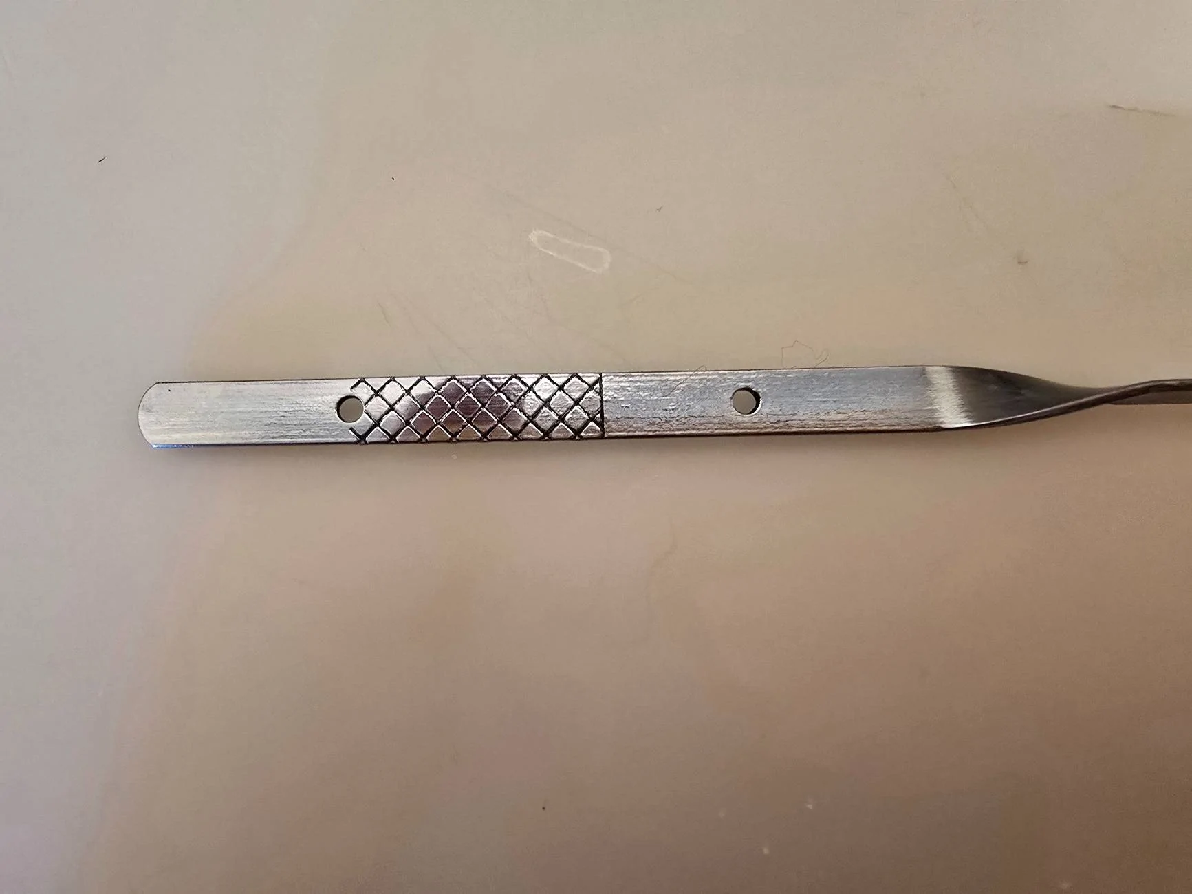

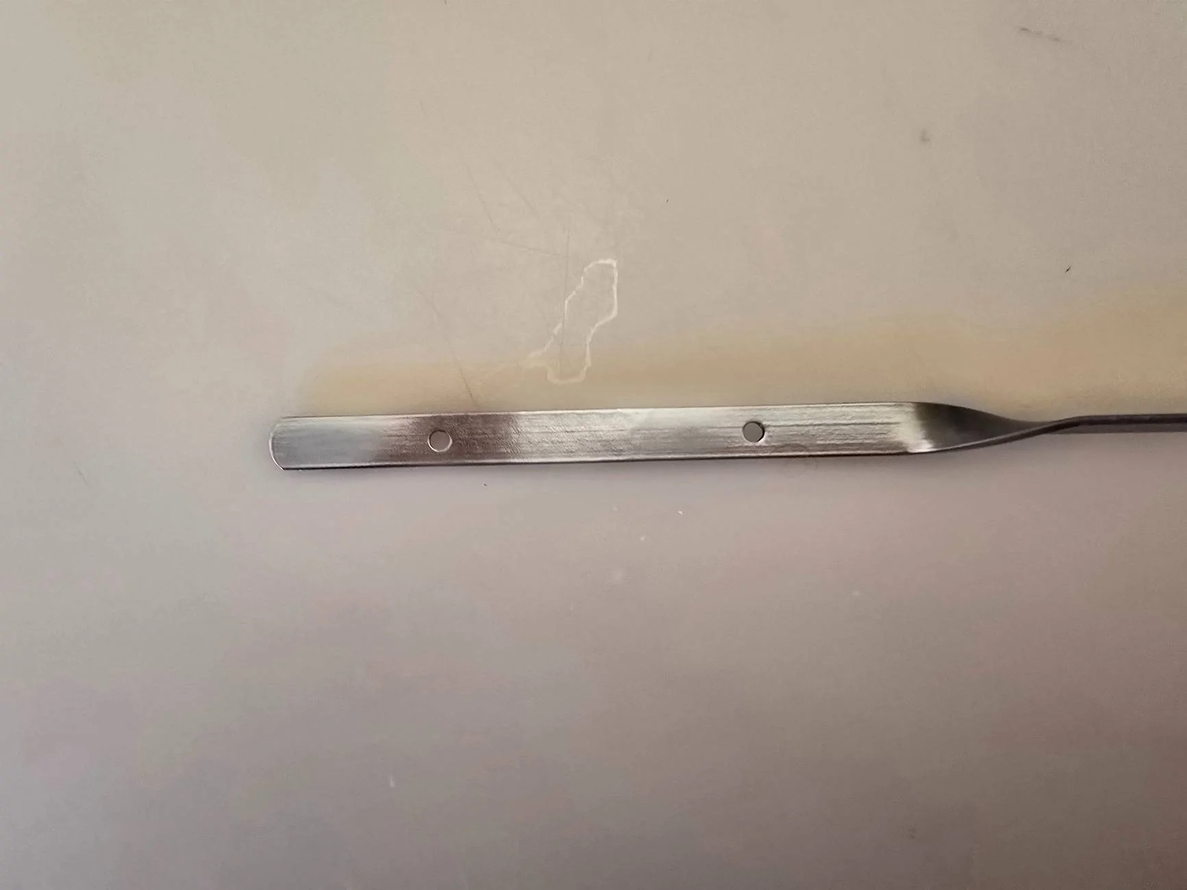

So, I ended up using a Dremel Tool with a polishing wheel and polished about three inches from the end of the stick. I usually view the backside of the hash marks, it's just easier for me to read.
